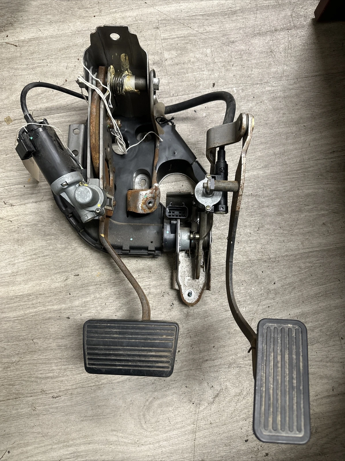

Any idea what the cable that connects to the top of the throttle pedal? It's like a speedo cable, and I had it off last year when I thought I could replace the pedal assembly, but couldn't.

What is the cable that attaches to the top of the accelerator pedal on an adjustable pedal model?
I had problems getting it re-attached a year ago, and I noticed it's loose now. I messed with it today, and the reduced engine power codes have gone away.
I have not been able to find what it is in my searches.
In this diagram, it is the cable coming down and attaching to the top of the accelerator pedal, upper right:
