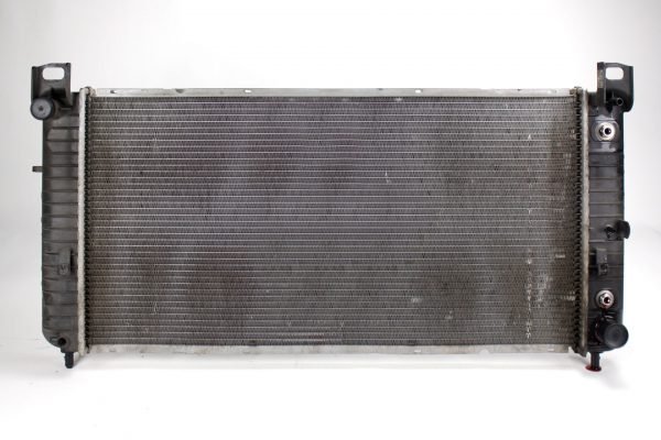

Designing the Silverado radiator was a relatively simple task. Like many factory radiators, the plastic end tanks were designed to fit the radiator support and the core was designed to fit a budget. The core of the stock radiator does not take up the full width of the end tanks. A thinner core equals less money, but it also equals less cooling.
Some radiator cores are thinner than the end tanks to fit fan shrouds and other mounts. But the fan shroud on the Silverado mounts on the radiator support and the radiator tucks under that support. That gave our engineer plenty of room to make the radiator core thicker, and a thicker core equals more cooling. Of course, a larger radiator that doesn’t fit is useless. Using information from Chevy, and measurements taken on a loaner Silverado, we made sure that our radiator would fit just as easily as the stock unit.

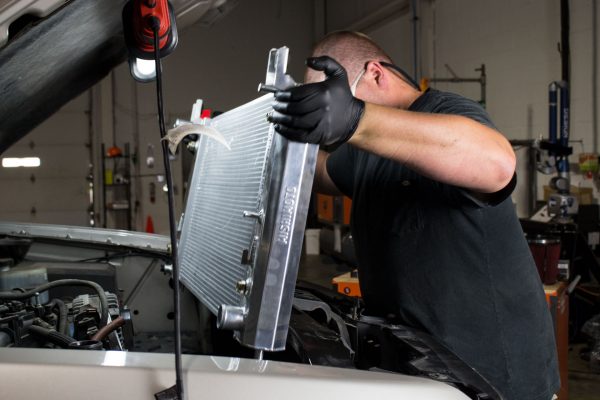

Great design means little if it doesn’t work well in the real world. Shortly after our radiator was designed, our production sample was ready to begin testing. But first, we needed a truck to test with. We often spend days or months looking for suitable test vehicles. However, this radiator fits a massive range of trucks, and one of our project managers drives one every day. Our plan would be to test fit the radiator on his 2000 Tahoe, hitch our enclosed trailer to it, and hit the steepest grades we could find.

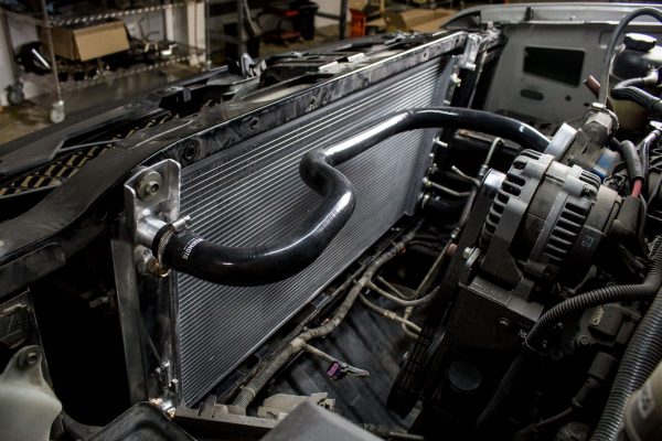

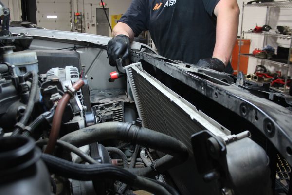

Our engineer’s careful measurements and the ample room in the truck ensured the test fit went smoothly. Even with a 92% thicker core, the radiator slid under the radiator support without a hitch. We cinched down the clamps on our silicone radiator hoses, filled the coolant, and reassembled the Tahoe for road testing.

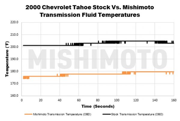

When we were designing the radiator, we noticed that the transmission cooler was located in the outlet tank. That location is a little out of the ordinary. Most manufacturers place the transmission cooler in the radiator inlet so that the heat from the transmission can be dissipated by the radiator. While that method returns lower temp coolant to the engine, the already hot coolant can’t take as much heat from the transmission fluid. Our hope was that our radiator would cool well enough to lower both the engine coolant and the transmission fluid temperature.
After logging several trips up and down the hills, we concluded testing with our radiator. But our day was not over. We had data from the Mishimoto radiator, but there was nothing to compare it to. The sun was still high in the sky by the time we arrived back at our facility and the temperature was hanging steady at 79*F. The project engineer quickly swapped out our radiator for the factory radiator and headed back out to establish a baseline. We repeated the same exact testing procedures as the Mishimoto radiator. The engineer was careful to maintain the same speed and the same route as the Mishimoto radiator testing.
The results would prove to be better than we could have hoped for.
Our radiator showed a substantial reduction in every parameter we tested. Radiator inlet temperatures with the Mishimoto radiator were reduced by approximately 20*F over the stock radiator. On the other side, outlet coolant temperatures measured in at approximately 46* below the stock radiator outlet temps. With that great of a reduction in outlet temperature, it’s no surprise that transmission fluid temperatures also showed a significant drop. Transmission fluid temps with the stock radiator peaked at around 205*F. With the Mishimoto radiator installed, those temperatures fell to a peak of 180*F and followed that 25*F reduction throughout testing.
