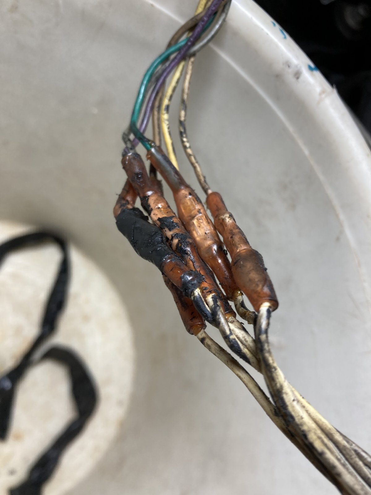

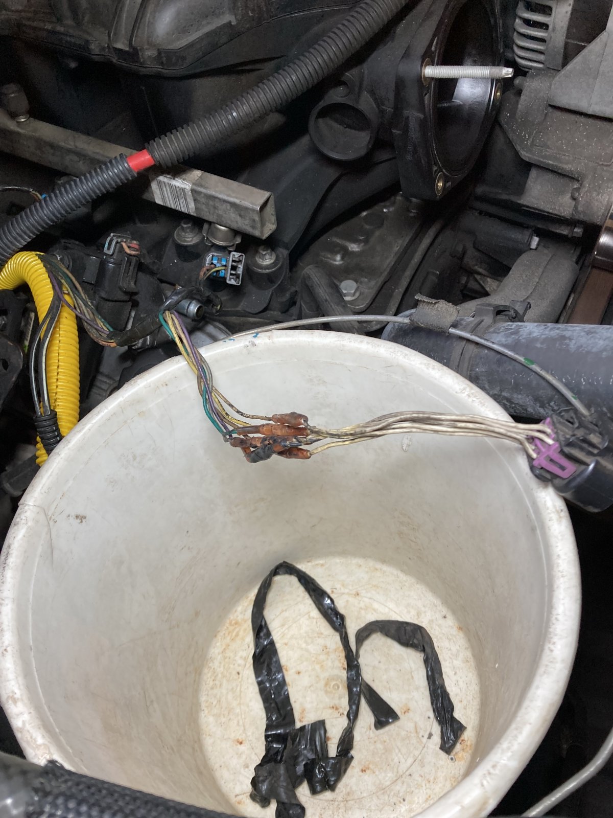

What harness? Pedal sensor? Throttle body? Other?
I'm doing one thing at a time and still get codes and reduced engine power. Last Saturday my battery read "replace", when I don't think it actually was bad. I replaced it any way.
We're afoot and it's everything I can do to keep my wife from getting another car on Marketplace. We have four cars, but only The Beast here.
Throttle body.

OK, explain what you're showing.
Is that before and after, or . . . . ????

Moderator
16,255
33,590
People's Republic of Colorado
The first two are "before" pics - this is the replacement pigtail from the throttle body someone had wired in before Paw Paw (@89Suburban) owned it. He re-did the butt connections.
The wires can break about 6" or so back from the connector, under the insulation, causing intermittent throttle position values. Best to inspect by feeling the wires for abnormalities under the insulation.
