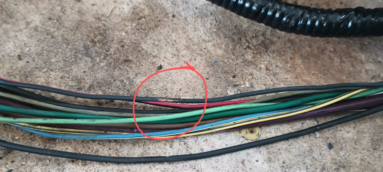

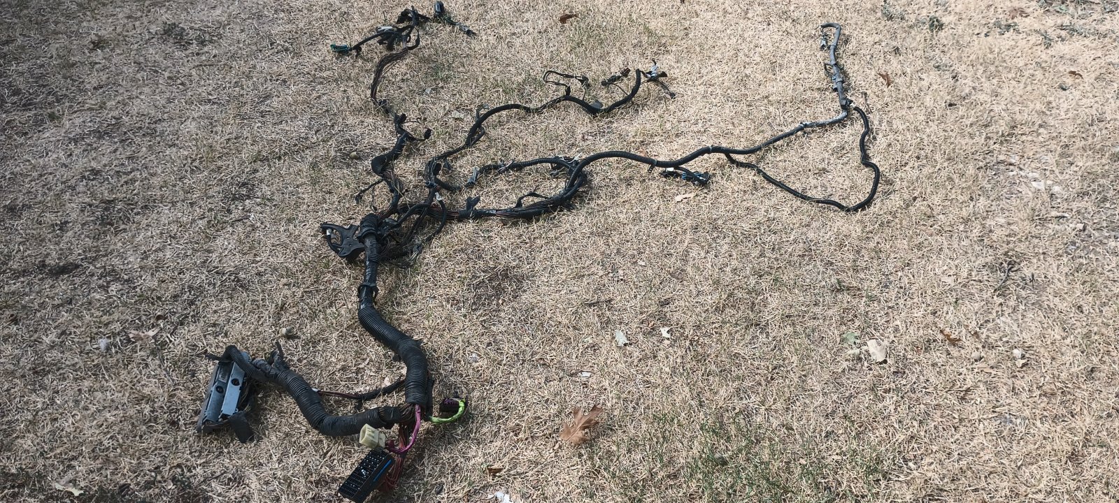

I've heard of the issue but I have no direct experience with the problem. I'm actually working on re-looming the harness on my 06 Suburban right now. I did find a few wires with chaffing and I'm fixing that. I only decided to do this because the loom was all damaged and missing in a lot of parts.
You can probably just make yourself a new harness from the ECU and run it to the drive by wire throttle body. It's like 5 wires IIRC. Just look up the wiring diagrams. They sell the little terminals that go to the ECU. I've got some pictures on how to do this somewhere; it looks intimidating but it's not that bad. You can download the vehicle-specific diagrams from AllData for $20 for one month access.

I just moved around the wires and noticed the chaffing. Some wires were pretty caked up gunk so I sprayed with purple power cleaner and wiped them down as best as i could before installing new loom. I'm still waiting on my order for the large loom to replace, so I'll be looking out for more of that.
Some wires right at the sensor connector had missing insulation, like the camshaft position sensor and one my transmission speed sensors. I applied some of that liquid electrical tape on those.
I'll probably create a thread on the procedure. Removing the harness is kinda of a pain.
