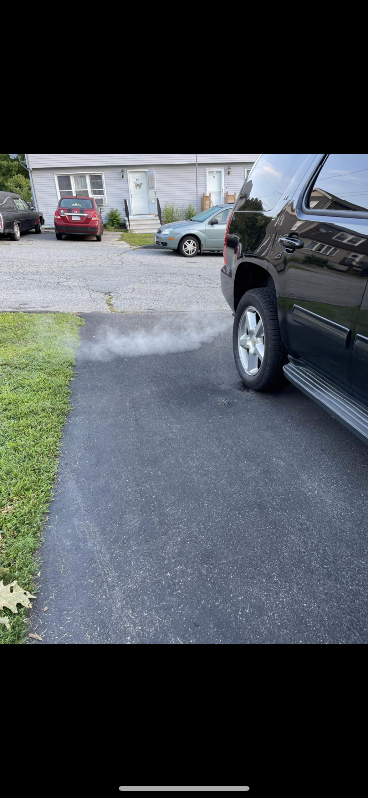

It’s usually like this picture but can be dense on occasion. Definitely when it’s cooler outside it happens more. I add coolant about once every 2-3 months, just a top off, 1/4 of the bottle. It was every 2 weeks I had to FILL before the delete.

Yup, that looks like textbook coolant entering the combustion process, but it’s reassuring that it’s only a top off every few months. My guess is that it’s entering through an intake port or otherwise outside of the combustion chamber - perhaps through a hairline crack or porous casting. If it was in the chamber, the whole cooling system would be pressurized and burp gases out regularly into the overflow tank.
I suspect that it will remain stable for a long while but if it becomes problematic, pulling the spark plugs as Marky suggests will at least reveal which cylinder head needs to come off.
