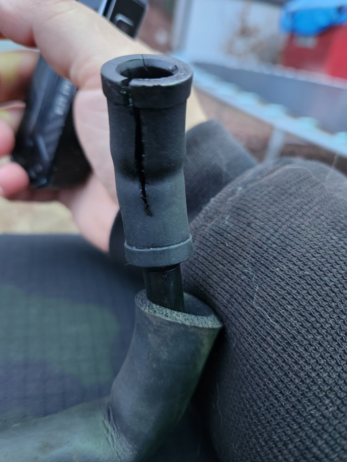

So I have slight update
First off, thank you everyone for your advice and help. I'm new to GM vehicles and their problems but have found myself with 3 of them. (3 Vehicles that is. Way more than 3 problems)
So I did the factory DoD lifter replacement and the vehicle never ran right, so, I bit the bullet and got the DoD/AFM delete kit from AMS racing. I tuned out the DoD with HP tuners, and only then, did I get the damn lean codes. So far, I've gather that there is a hierarchy to how the ECU reads codes and would not pull the lean DTCs until the others were taken care of. So I found myself chasing a problem that was coincidental to the DoD delete but a separate issue.
Now, I'm not celebrating just yet, but the HP tuners said I was indeed lean as hell and so did my white vavles and spark plugs. So, I started looking for leaks and found this (image attached). I'm going to get a replacement asap. I pray to god this is my issue because I really don't want to get a smoke machine or pay a shop.
P.S. I thought I was having issues from installing the wrong cam, however, AMR racing told me the VVT and non VVT are the same grind, just the VVT has the oil valley on the center bearing circle. At least as far as single bolt cams go.

I hope that's it.

It's a good bet that that's your problem. That crack can draw in a lot of air.
