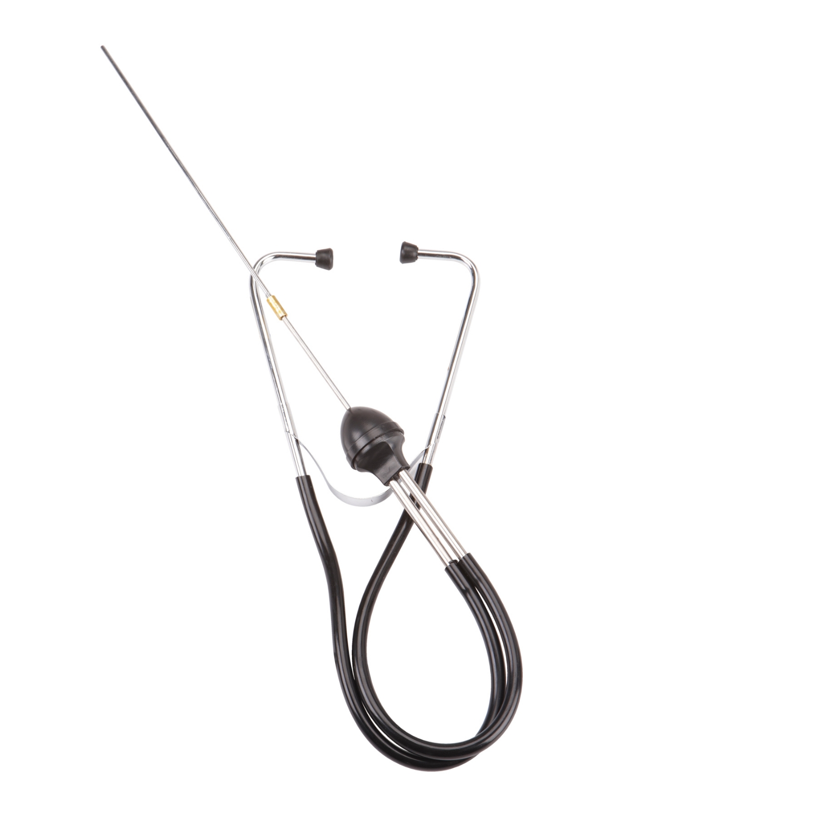

Go to your local auto parts store or Harbor Freight and get one of these so you can find the source of the annoyance:
