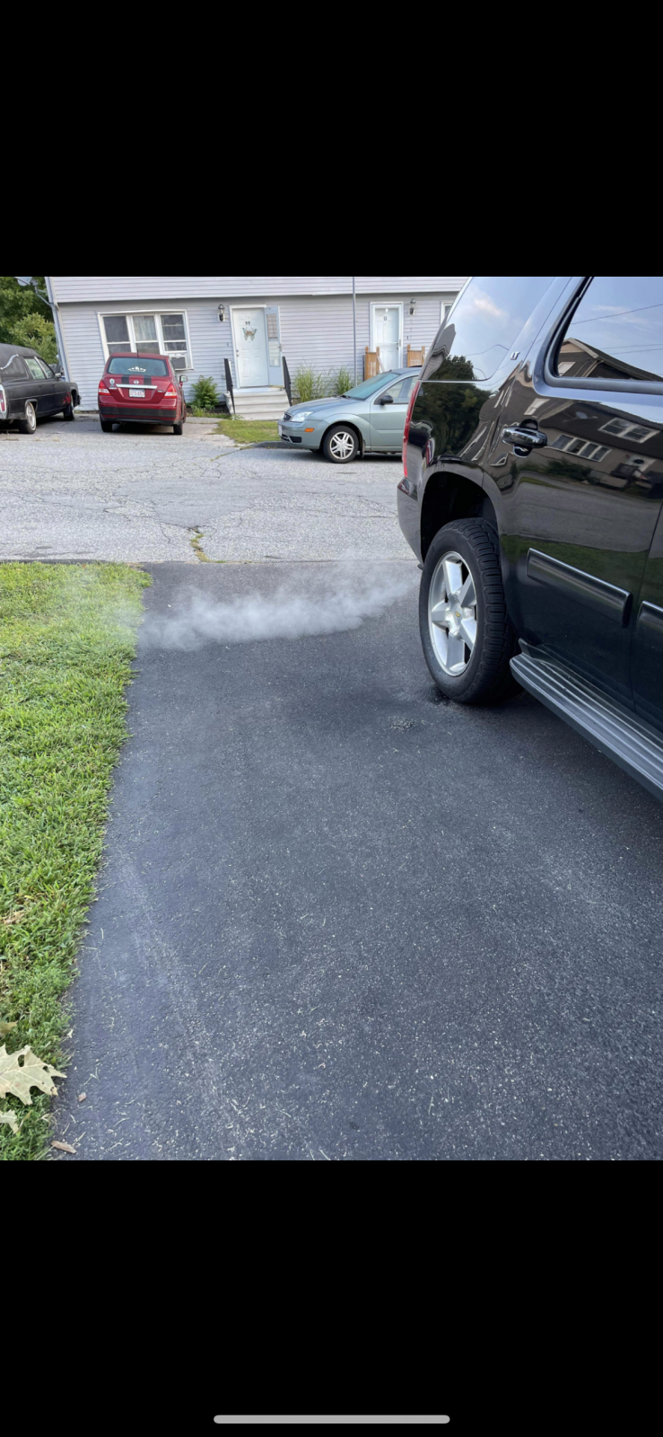

It’s usually like this picture but can be dense on occasion. Definitely when it’s cooler outside it happens more. I add coolant about once every 2-3 months, just a top off, 1/4 of the bottle. It was every 2 weeks I had to FILL before the delete.
Yup, that looks like textbook coolant entering the combustion process, but it’s reassuring that it’s only a top off every few months. My guess is that it’s entering through an intake port or otherwise outside of the combustion chamber - perhaps through a hairline crack or porous casting. If it was in the chamber, the whole cooling system would be pressurized and burp gases out regularly into the overflow tank.
I suspect that it will remain stable for a long while but if it becomes problematic, pulling the spark plugs as Marky suggests will at least reveal which cylinder head needs to come off.

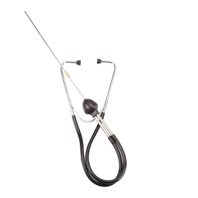

Grab one of these from Amazon or China Freight. You’ll know 100%, right away if you’ve got coolant contamination in the block.
Then check your coolant tank reservoir. It took me months to find out that was the source because it evaporated almost immediately when it leaked from the cracks.
