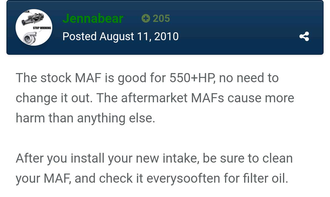

That post is 8 years old and I agree, stock MAF is just fine for under 550hp... Again, we are talking about a supercharger and headers. Once he does that I'm sure he'll add a cam down the road. He will be closer to 700-800hp if done right. Stock size MAF isn't gonna cut it with a Positive Displacement Blower at that point. Bigger the better for the intake, 4" to 5" preferred or you're leaving free HP on the table. Whoever says a bigger MAF causes more problems simply doesn't know how to tune a MAF sensor and/or doesn't wanna spend the time to get it right. I've been tweaking my MAF calibration for months to get it perfect for every throttle position and load. It takes time and patience to get it right, most tuners don't care. They tune for WOT, take your money and move on to the next person.

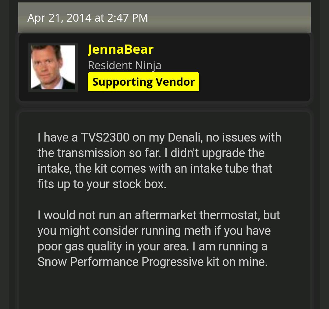

Yeah. I am not disagreeing with what anyone here is saying, especially not someone who is running a supercharger and is putting out great numbers.
I was simply trying to point out that while alot of folks think you need to swap out to some fancy intake/filter it's not necessary in all cases.
If Jenna Bear is running a supercharger on a 6.2l with the stock air box then to me that says something.
I don't think anyone would argue that the 6.2l would be a heavier breather than a 5.3l.
If she thinks it's good enough for her, and I think the argument could be made that she has access to any intake she wants as well as a dyno to test it all out (and probably custom tuning, lol), then its good enough for me.
Again, I don't know what all was done to her truck but I will assume it is stock internals so adding a cam and more cubes like @67RS427 is running and you probably do need more intake.
