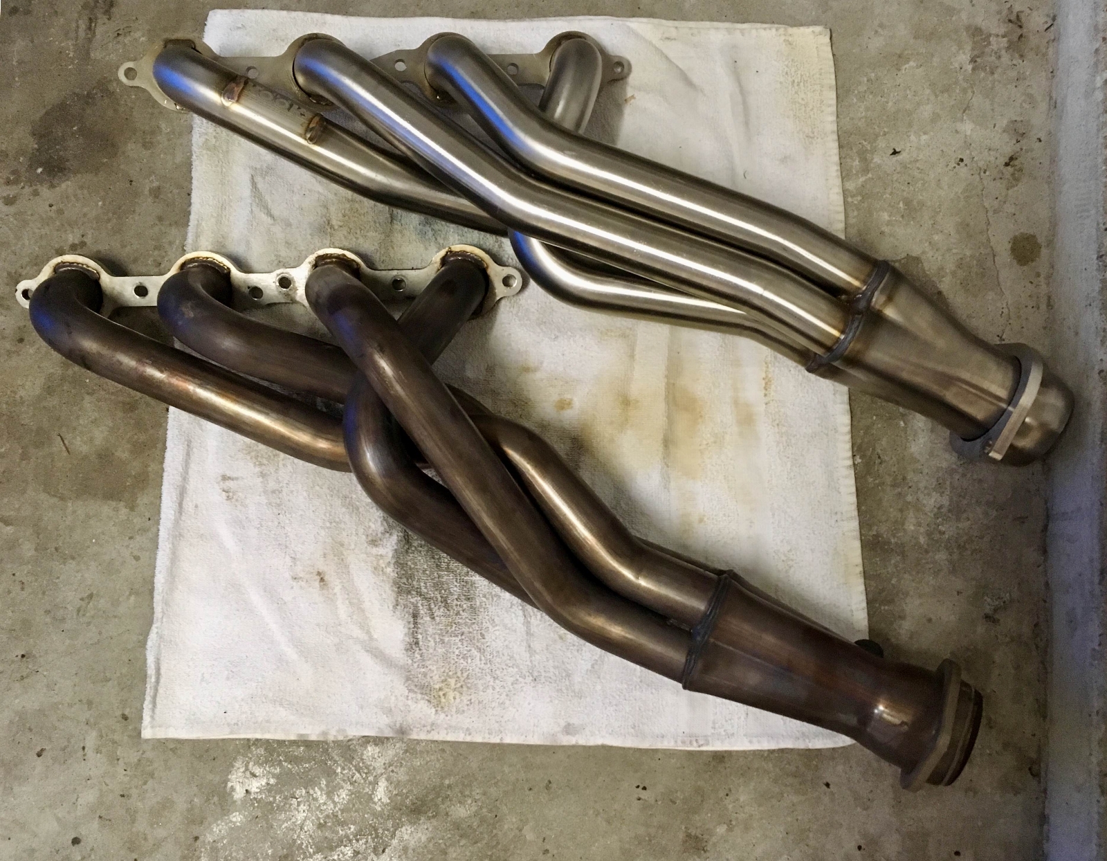

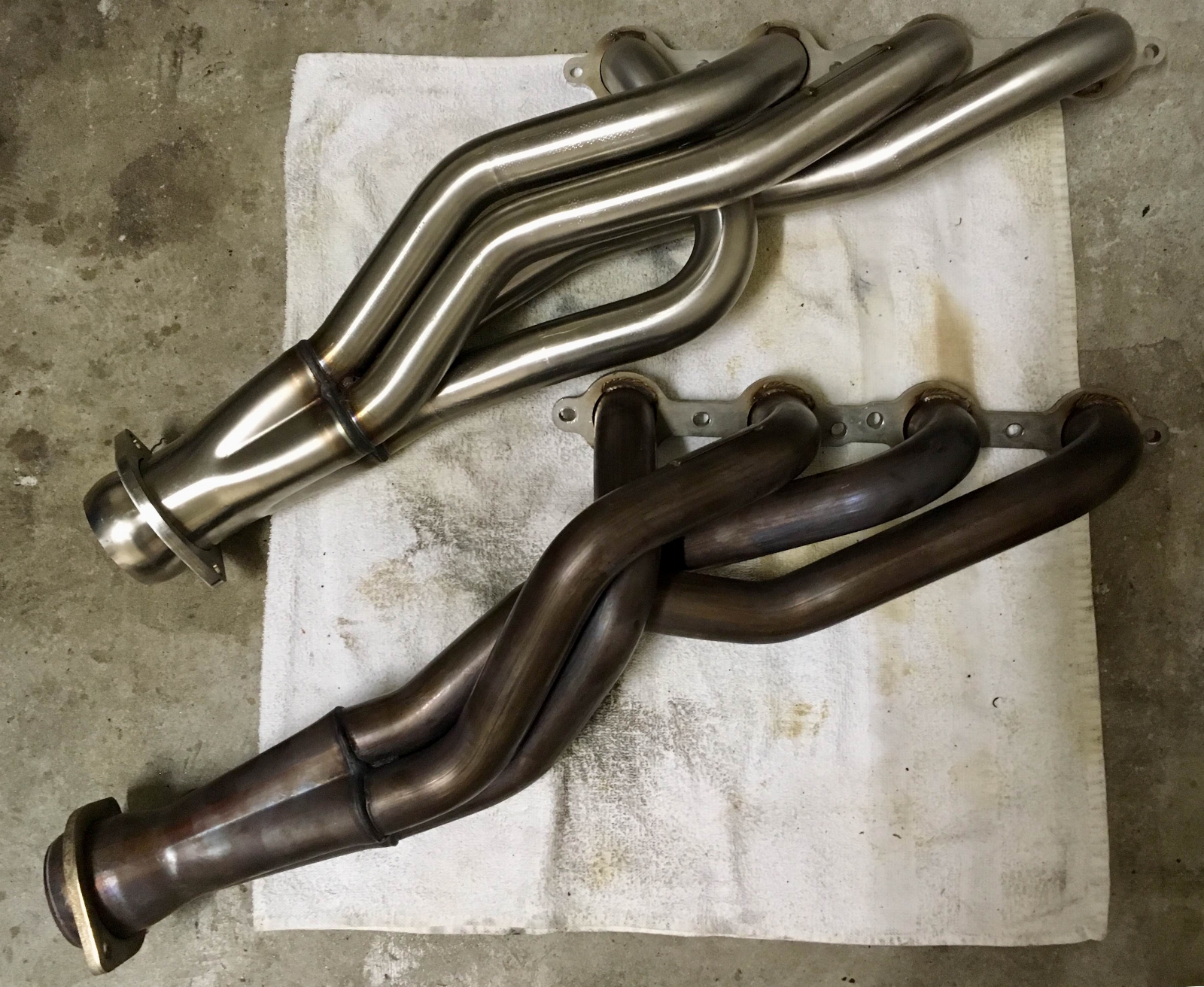

I'm following your build closely, you are doing a lot of what I'm planning for mine this spring. I am still on the fence between kooks and American racing headers. Out of curiousity, what made you pick kooks?
Having owned both I would definitively conclude you can’t go wrong either way, one isn’t better than the other....think of it as like choosing between Lamborghini or Ferrari, there’s no wrong answer, neither has a clear cut advantage over the other
here are some side by side pics I took for comparison:
Top kooks 1 3/4" // Bottom ARH 1 3/4" (both for NNBS trucks and SUVs)
If anything I might give the slight design edge to ARH as you can see below on the passenger side header (1st pic) with the Kooks you have to route a starter ground wire (requires removing 1 bolt) through the primaries where as with the ARH design you never have to touch this wire and it already clears underneath the header, but then again when it comes to the y pipe design I prefer the Kooks Y as they offer a Y Pipe specific to the year model since they changed the cat-back connection between 07-08 and 09-14...Kooks offers 2 different Y Pipes where as ARH Y Pipe just comes pre fit for 07/08 and includes an adapter for the later years

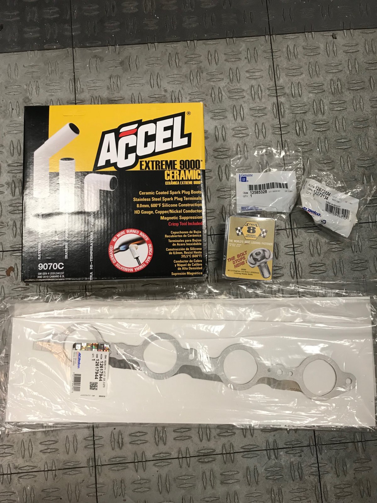

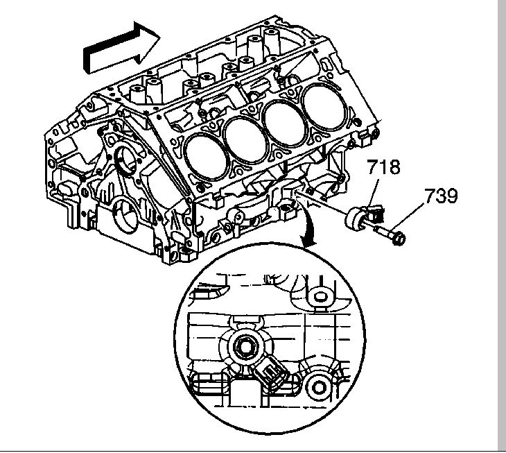

ok just order the ACCEL ACC 9070C Extreme Ceramic Boot Plug Wire for GM LS Gen IV Engines will see how they fit, and since already have the AC Delco OEM plugs and ACDELCO D513A D510C Ignition Coil will put them in.
edit. also ordered

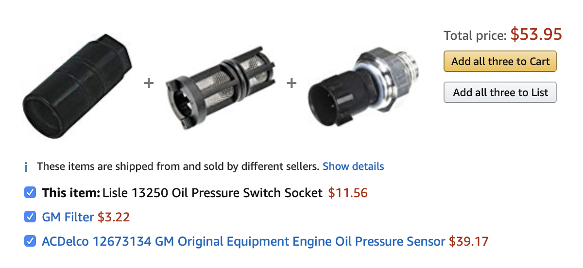

ACDelco 12673134 GM Original Equipment Engine Oil Pressure Sensor

9. Accel 9070C Extreme Ceramic 135 degree boot Plug Wires
10. AC Delco 12673134 Oil Pressure Sensor
11. AC Delco Ignition Coil D513A
12. ACDelco 12617944 GM Original Equipment Exhaust Manifold Gasket
13. Stage 8 8900 Locking Header Bolt Kit for GM Small Block
