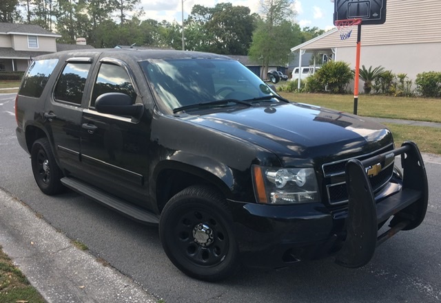

Hello fellow PPV owners,
Just introducing myself as a new owner of a retired FHP (Florida Highway Patrol) 2012 Chevy Tahoe PPV with 175,013 miles on the odo. I apologize in advance for the long intro, but I am excited to be a member and owner of these not so common special SUVs. A la The Blues Brothers, “It's got a cop motor, a 323 cubic inch plant. It's got cop tires, cop suspensions, cop shocks.…..”! :Big Laugh: Although I’ve never owned a Chevy Tahoe before, I’ve always been a fan so this is my first, but I’m no stranger to the GM full size SUV. My family previously owned a 1989 and 1998 GMC Suburban years ago, so I do have experience driving these bad boys. I have driven a newer model Tahoe once as a rental in 2018 while on a family trip to the San Fran bay area. That was a nice truck I enjoyed driving, and hoped could get one sometime in the future, but I couldn’t afford to buy new so when the chance to buy this special PPV came up I couldn’t pass up the opportunity to get one for a bargain.
