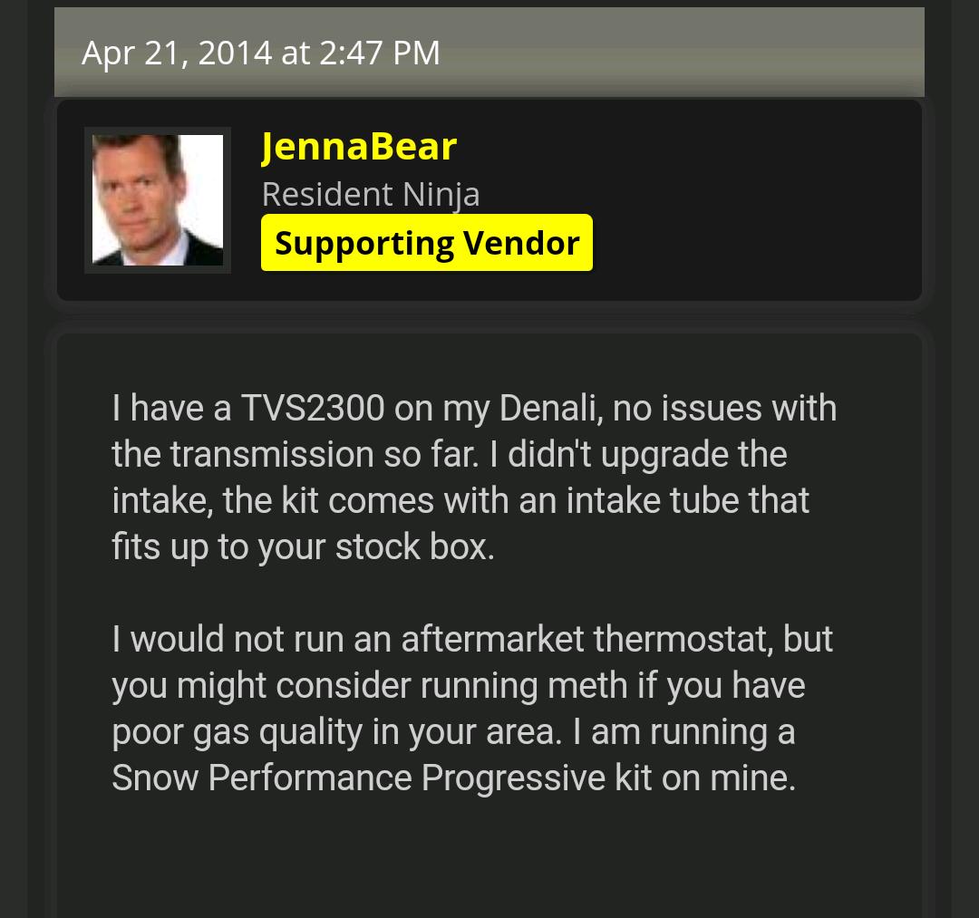

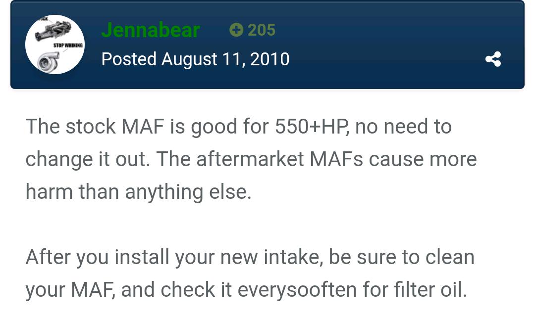

I understand what your saying and I agree. I wish I could remember where I found the info for how many CFM the stock air box could flow. Unfortunately I can't seem to find the info now but it was quite a bit.
***edit***
Here are a couple things I found...
Not the CFM ratings I was looking for but circumstantial evidence at least.
I know in the Magnuson supercharger install manual it tells you to swap the paper filter for a K&N style filter and hook the new intake pipe that comes with the maggy to your stock air box.
I believe most other brands recommend the same.
Not trying to argue or start a fight just saying that the stock air box is not as restrictive as some might think.
