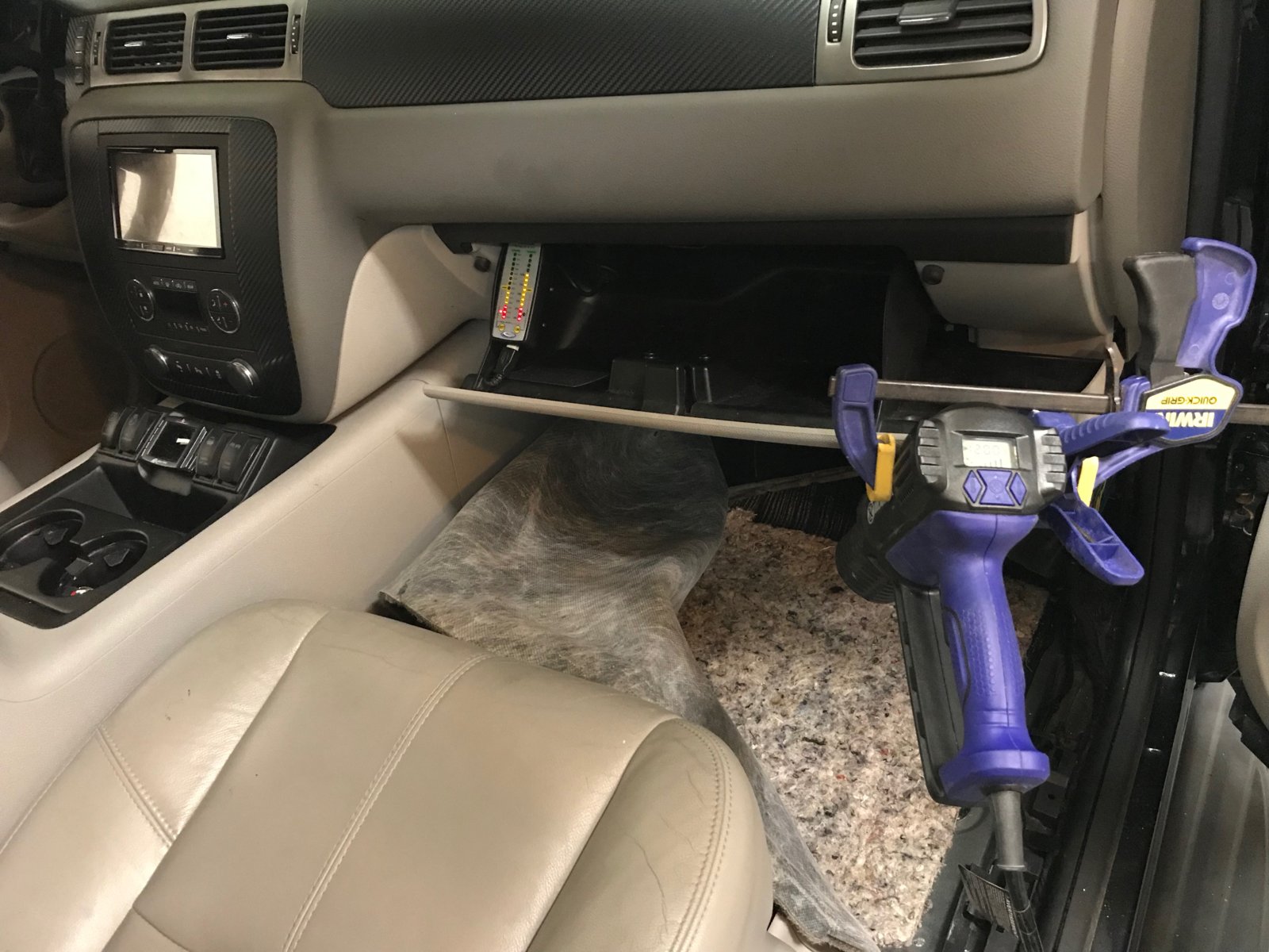

Guys bit off topic question, I still have a problem with passenger side carpet being wet, have clean the AC vent, also sealed rubber door jam boot. What else could it be?
kbuskill
Mar 11, 2017
5,825
9,836
NE. FL.
Leaking heater core, leaking drain tube from sun roof, leaking windshield.

not sure if it makes a difference but its the underlayment not the carpet.

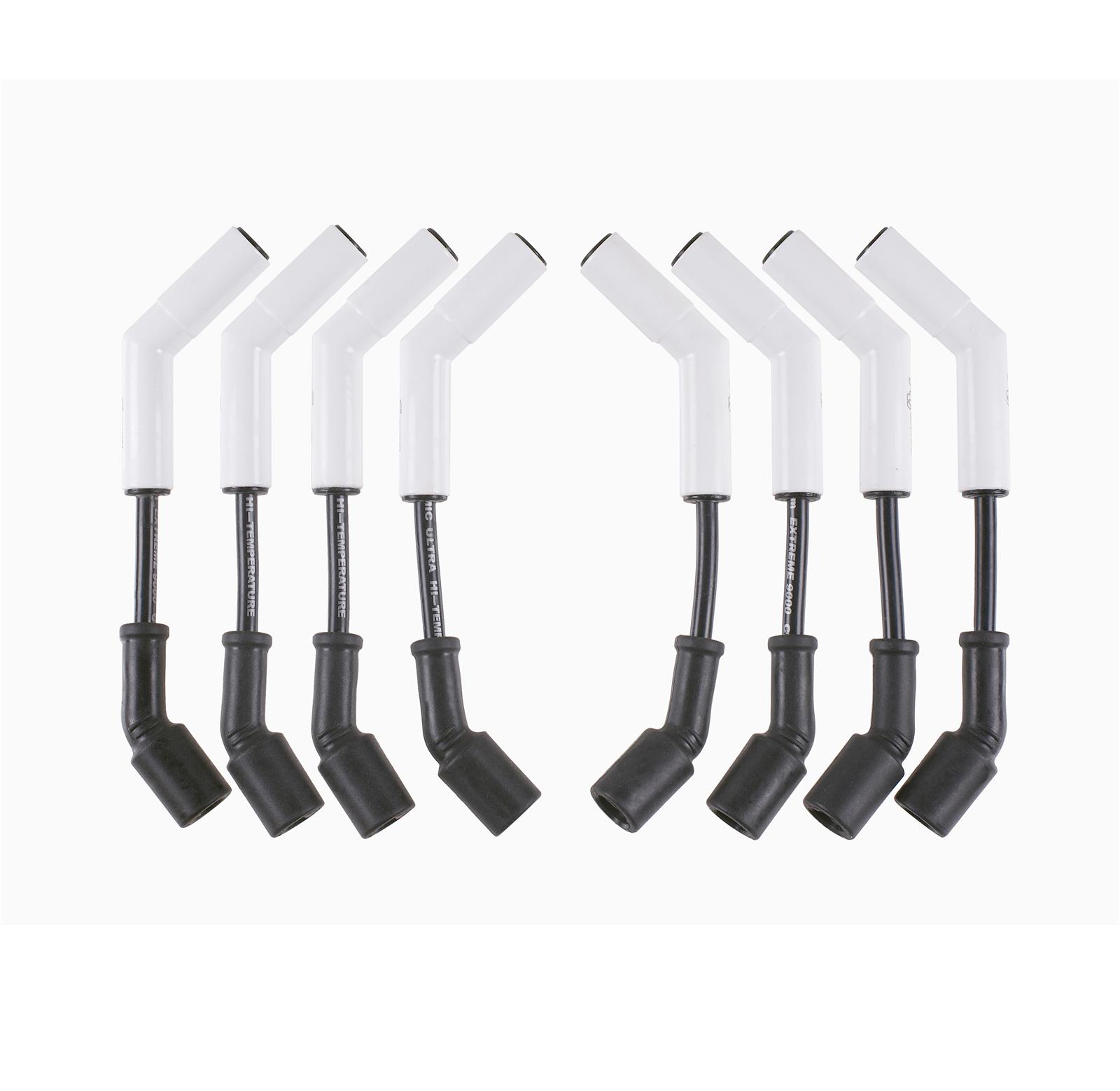

*Plug wires you will need a 135 degree boot... I burned up a set of modified OEM wires like Kooks suggested. I went with blue Taylor wires and had issues since they didn't clip on very well. Honestly, get the Accel Ceramic Boot wires and be done. Universal set it like $90 on Summit. I had one come apart on me while changing plugs last week and Summit sent me a whole set to replace them even 90 days after return window closed.
*OEM coils, I don't recall which year you have but the truck coil is the most powerful. I'm running the Delco D514A coils. They look great on a ICT Billet coil bracket and my wires are super short.
https://smile.amazon.com/Square-Bra...encoding=UTF8&psc=1&ref=ppx_pop_dt_b_pd_title
Doesn't look like Accel makes wires that fits 2012 Tahoe, have checked several sites. But the Accel Extreme 9000 series looks like it might.
or this might be another option.
I'm personally not a fan of the boots but the ACCEL Extreme 9000 Ceramic Spark Plug Wire #9002C is what I decided to run... I made them to length but the ones you posted look plenty long, mine are a touch shorter.

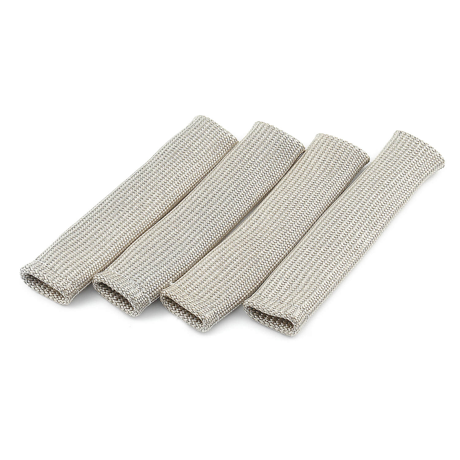

maybe a set of MSD wires and Accel boot guards, plus getting headers ceramic coating.
