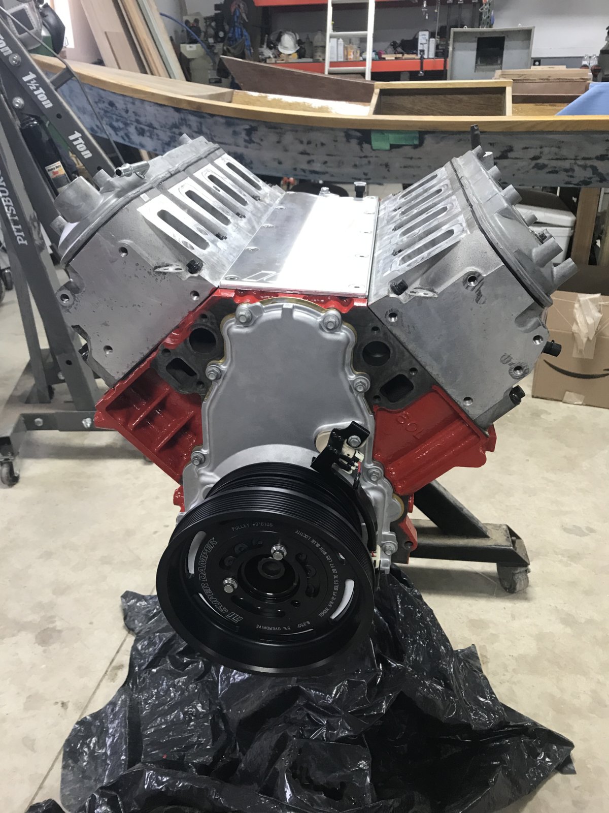

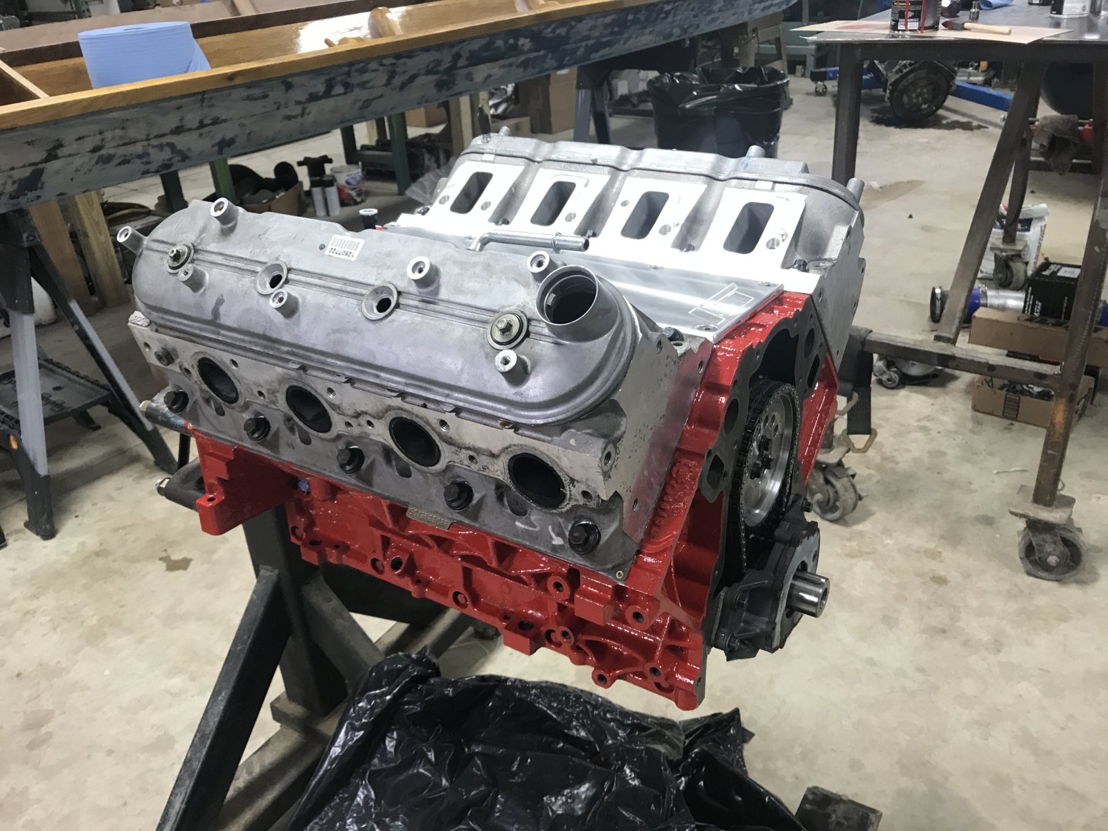

Next up is a coat of red Por15 paint on the block and slapping on the oil pan. As you can see I machined off the stock pulley on a bridge port and the new 2.5" WeaponX pulley will go on after I do some porting on the snout and blower intake runners.

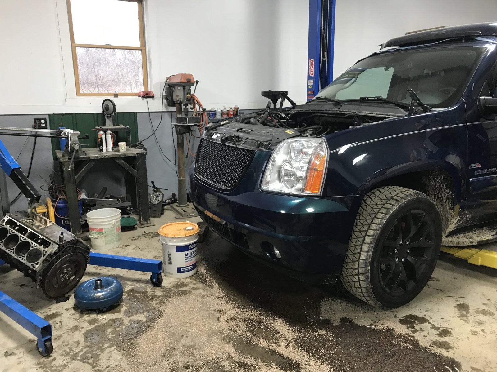

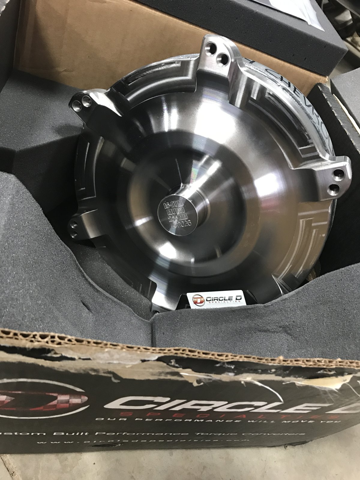

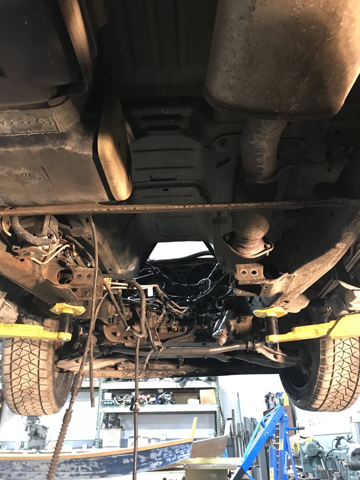

Things are moving along... Out with the old, in goes the new 402" beast. Wasn't planning on pulling the transmission but my crankshaft was so out of balance from the worn bearings that it chewed up my reman convertor and bell housing of the transmission. Luckily I have this awesome Circle D Triple Disc convertor.

What's the difference between a reg tc to a triple disc tc?

Triple disc is like a transmission clutch pack. It has 3 clutches and with 3 vs 1 it can be locked up for WOT shifts.

About $700 Lol. The holding power is much higher. This is a cool build. What type of transmission is this being bolted to?

Your right about the cost lol, it sure wasn't cheap but I needed the extra clamping force with this much power. It's the 6L80e that came with the truck but I built it up a bit. I'm still worried about locked WOT shifts breaking the input shaft at this power level because I didn't use a 300m input. I might regret it or just not lock up on shifts since this is my daily driven street truck.

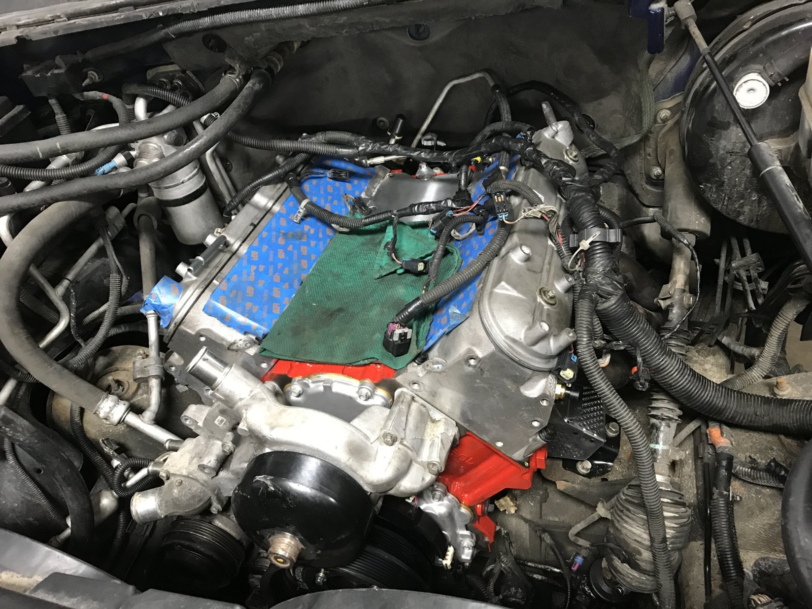

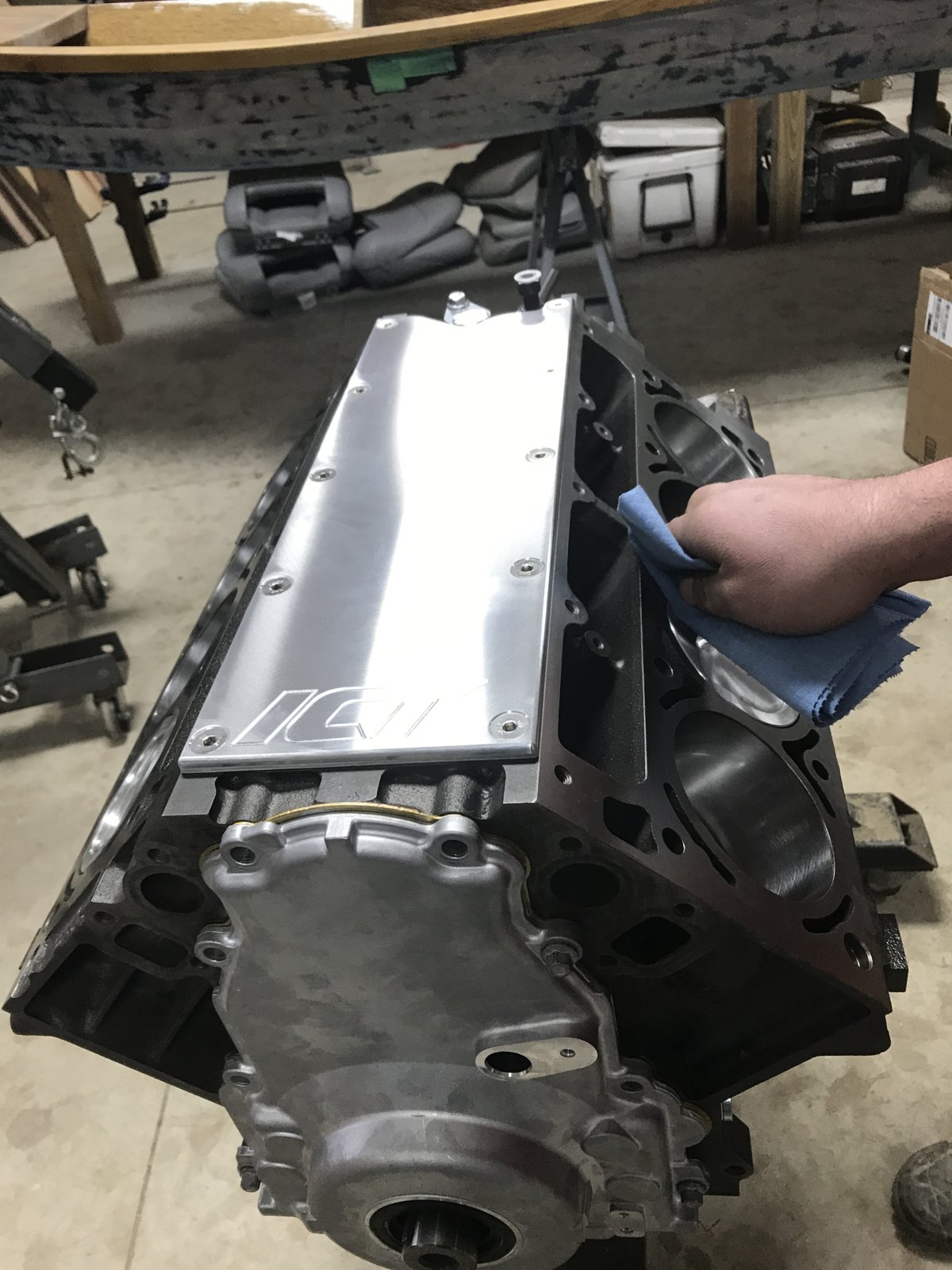

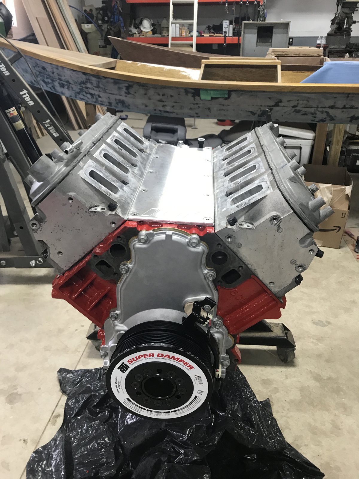

Laid down some paint today and installed the ATI 5% overdrive damper... Coming along, I would have had it all together today but the oil pan still needed to be jet washed. New motor mounts will be in tonight and motor will be back in the truck tomorrow.

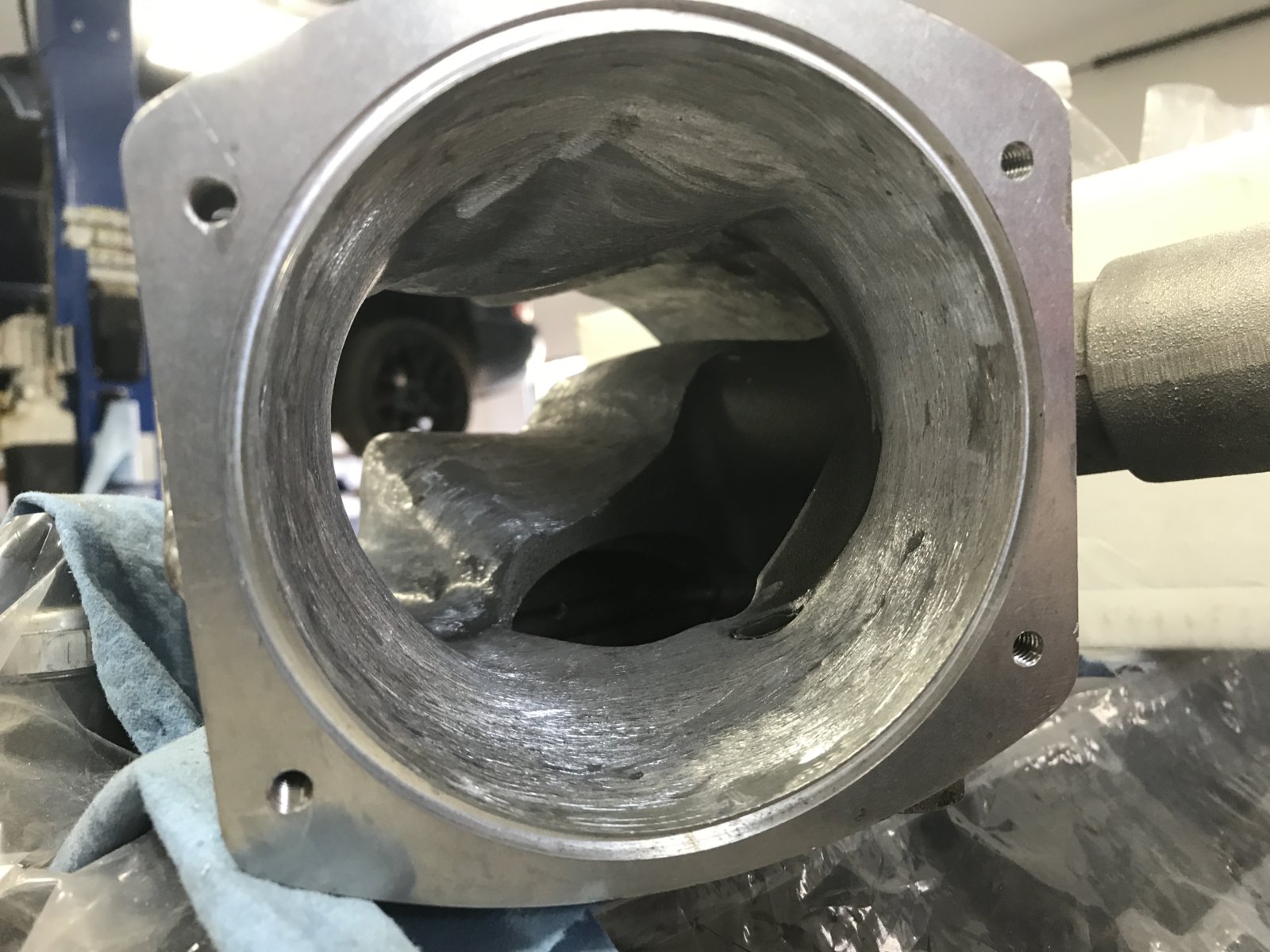

Blower porting:

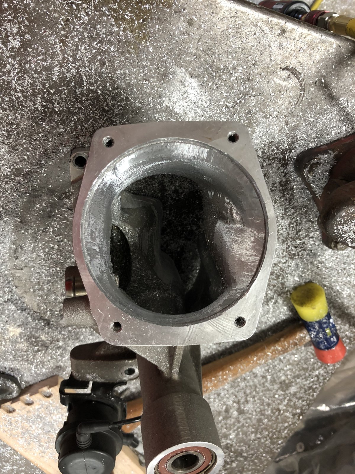

Snout - It's amazing how much material can be removed from these things. Easily took a few pounds of aluminum out of this thing. Opened it up for my 102mm NW TB and welded on an O Ring flange...
