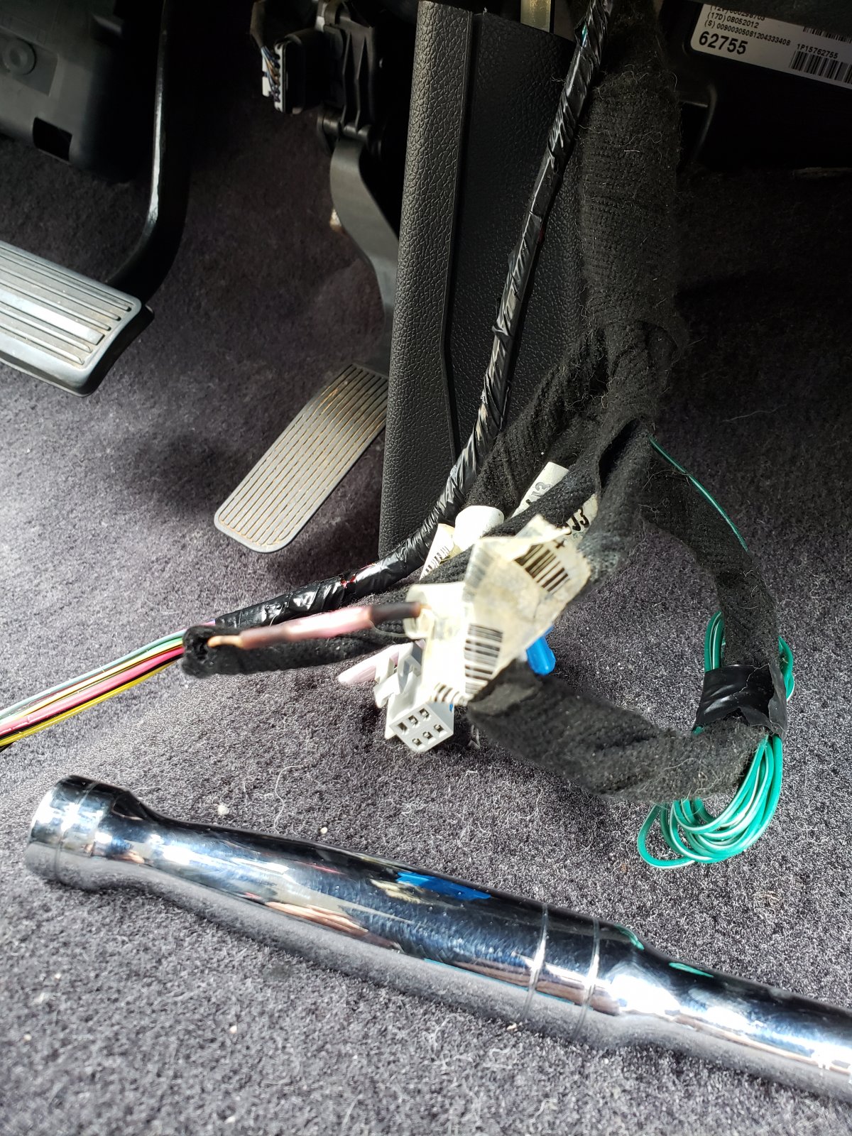

The horn on my 2014 PPV didnt work. I traced it to two light brown wires under the dash, under the HVAC controls. They are usually run to the control box so the siren will work off of the horn. When the box is removed no one hooks them back together. Just need to put them back together. I did so with solder and heat shrink.
Cool!! Thanks for the tip!! Will check that out! Prolly the same!

Horn wiring was probably cut under the dash under the radio... take off the lower dash cover on the passenger side... look for this bundle of wires... the pink butt connector pictured is the horn wire... the wire color is light brown...
Excellent. Gotcha! Will definitely check that.
Thank you so much!:D

Today, I got the horn working. :happy107: Thank you to you guys for the advice and the pics. They really helped. Got the wiring from under the radio, found the cut light brown wires, spliced them back together and HONK! It works! :D

Glad the picture helped... it's not a bad job to fix the horn when ya know where to look...
