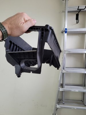

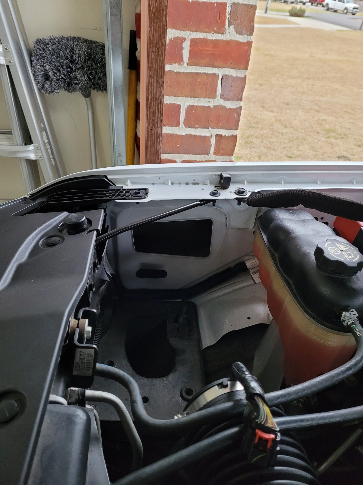

Here is your fender and airbox area...trim to allow most airflow...I do this on EVERY vehicle I own. I trim as much as possible below the filter, but try to leave all mounting points in tact
