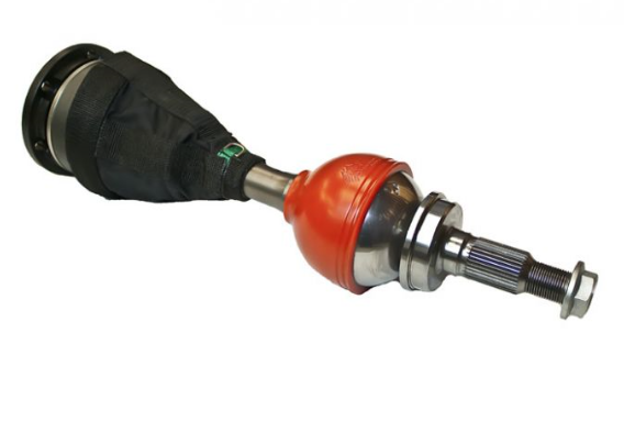

With regard to front axles, I found these from RCV, granted at 2500 a pair they are expensive but they are guaranteed to be indestructible.
https://www.rcvperformance.com/ultimate-ifs-cv-axle-set-for-gm-1500-88-and-up.html
