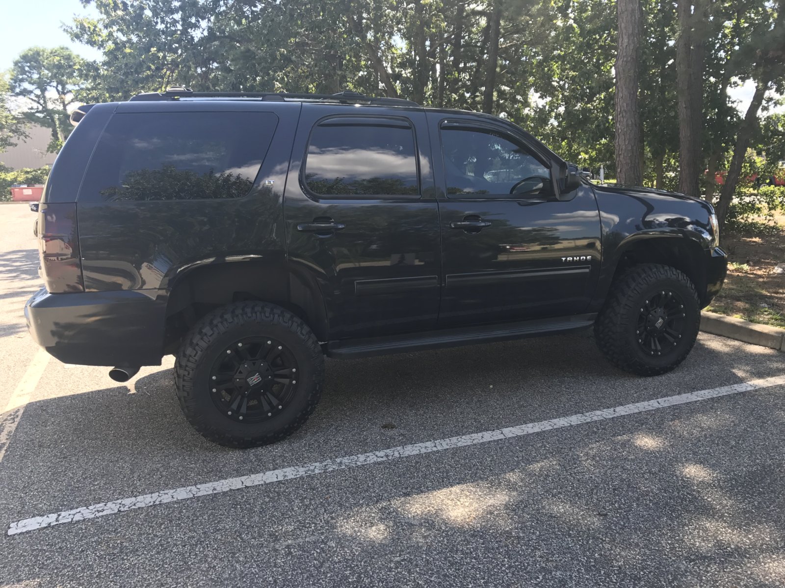

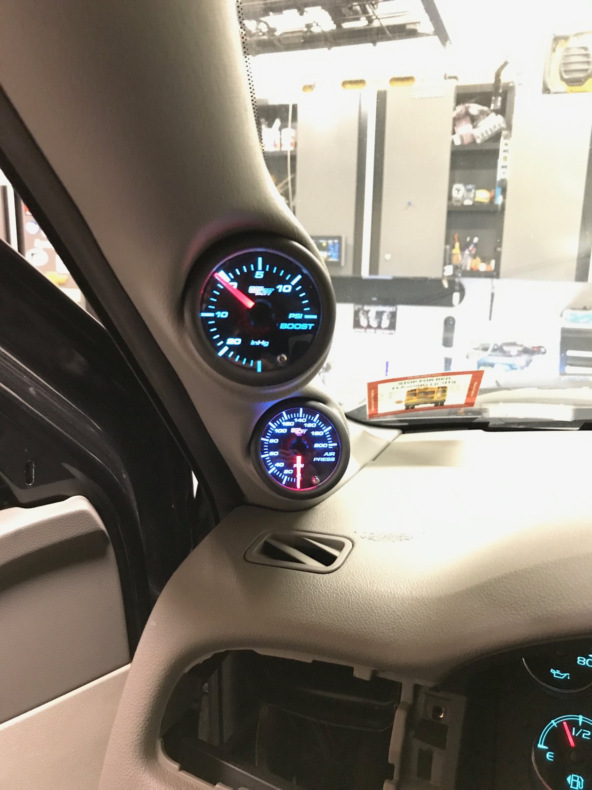

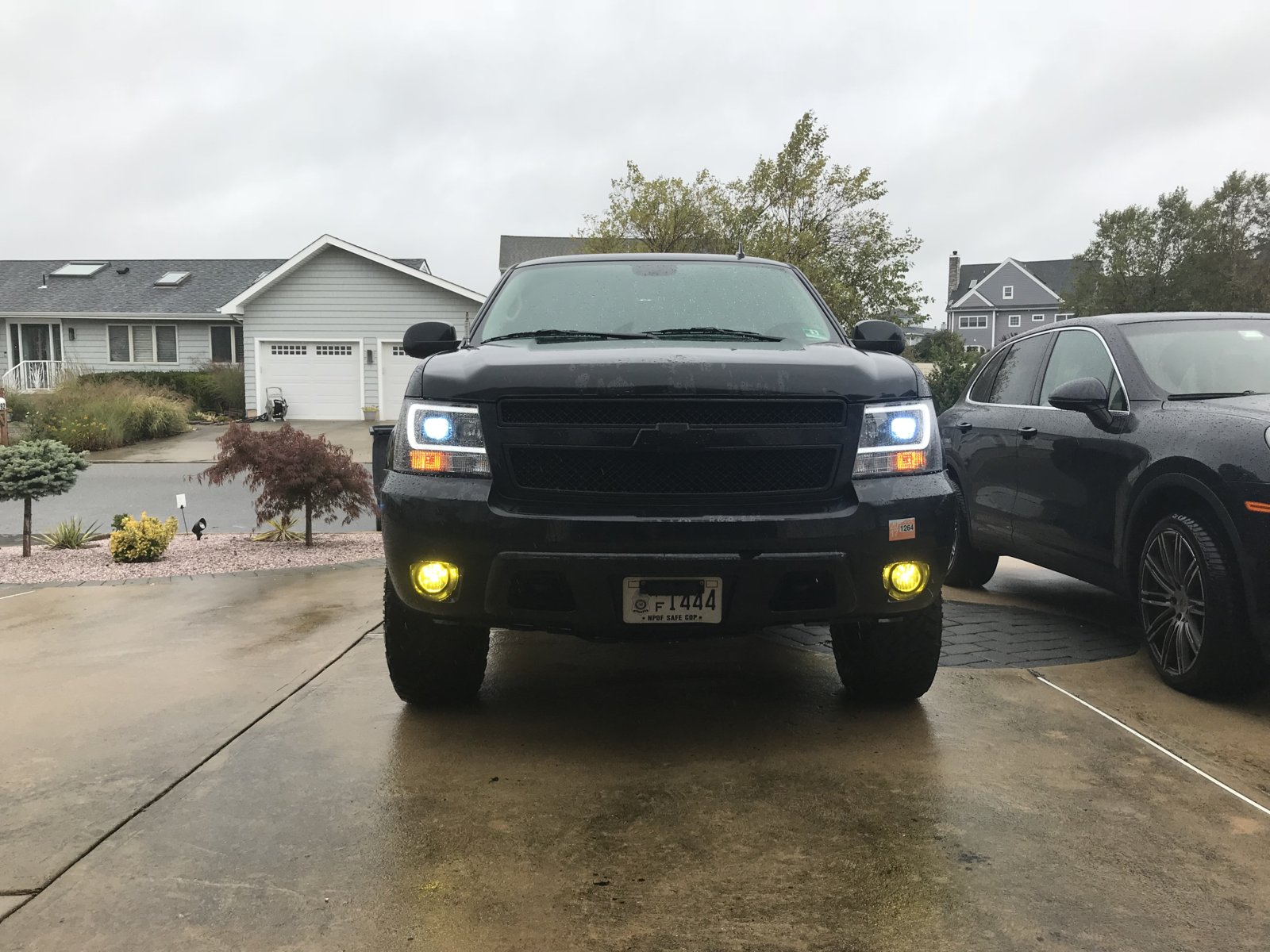

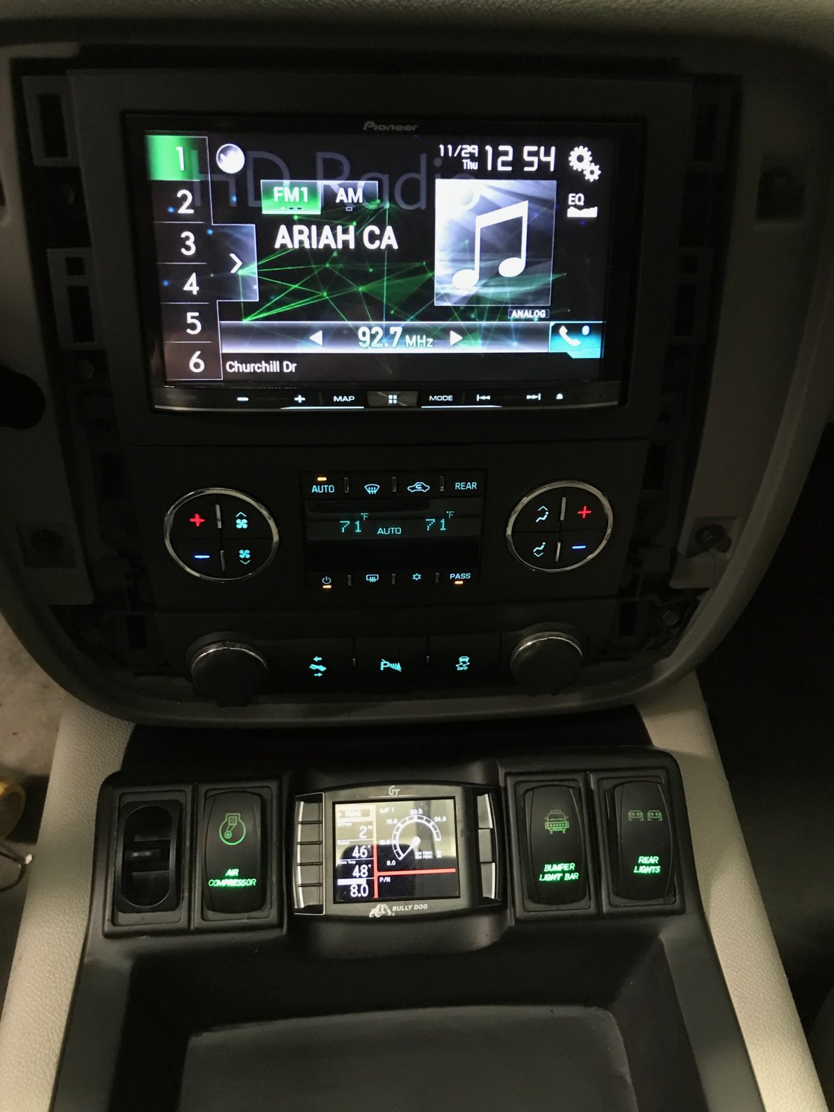

Here is some pics of the ride

Where didn't you get the center console bit? Nice.
Chrismnj
Chrismnj
Sep 17, 2015
1,227
2,121
NJ
Here you go...
