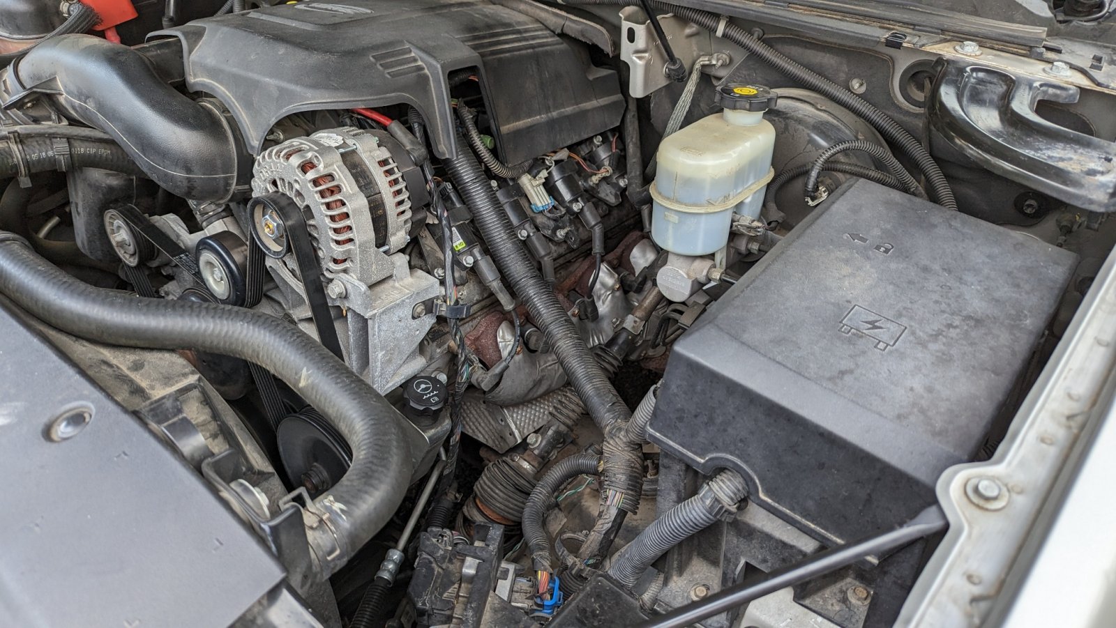

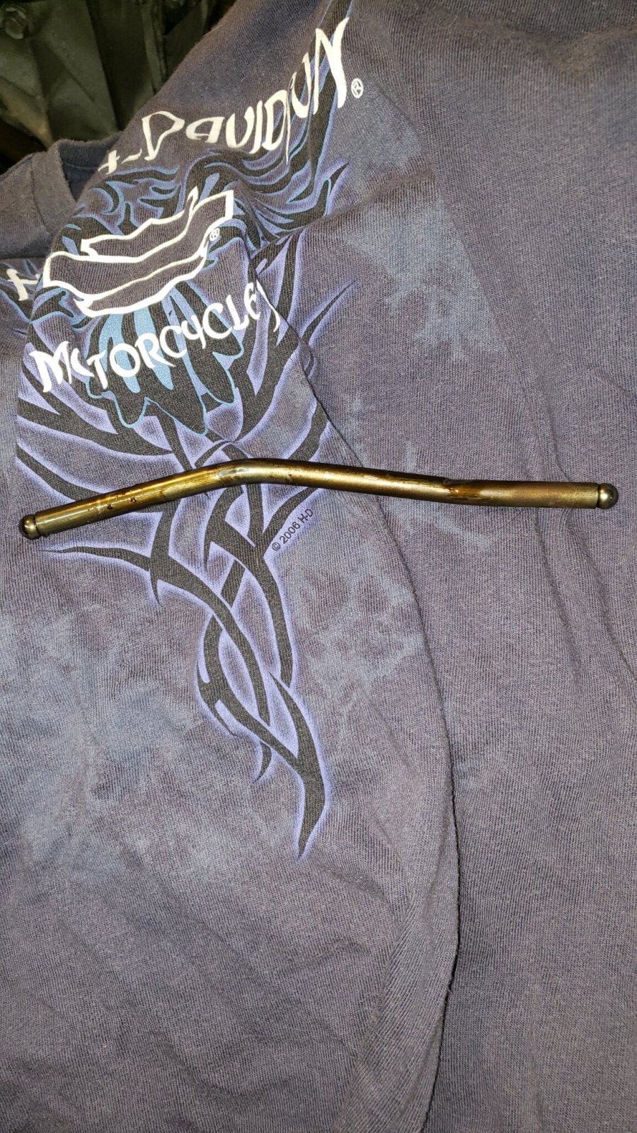

Bought a 2007 Tahoe LT in very nice condition a few weeks back with a ticking sound from the engine. From reading here I thought I could handle the repair. Bought it for $3500. Wanted to put it back stock as I didn't want to remove the cam if I didn't have to. Was hoping the cam would still be good. Upon opening it up found a bent pushrod on #4 cylinder. Cylinder 5 seemed to be burning lean from the rest or vice versa. Pulled the lifters and they all looked great on the roller to the cam and the cam surfaces. Replaced all the parts with OEM components. Started it up and it ran with a misfire. Tuned ethanol back to 3% from 70% and no improvement. Pulled injectors and they looked like they need replacing. Started and drove today and runs like a charm! Very smooth and no codes at all. The misfire and fuel rich codes and cleared up the Stabiltrak warnings too. I don't usually open up engines to work on but this one was pretty easy for what it was. Plenty of room to work. Learned a lot from reading here on the subject, so thanks everyone who has contributed over the years. Mostly going to be used a a third vehicle and boat and other towing duties. Probably last the rest of my life in that role. I spent a little more than the bare minimum trying to be proactive in replacing in sets where possible, rather than piece by piece only what was broken/worn out. YouTube was a big help too with disassembly/assembly instructions.

Any idea what actually caused the bent push rod?
Dustin Jackson
Aug 9, 2018
1,788
2,065
@tom3 I've seen a few people post situations like this and the best theory I can think of is that the lifter collapsed enough to allow the push rod to unseat from the center and ride of the outer lip of the lifter allowing the pushrod to get squished next time the cam and lifter cycled. But what do I know lol
TollKeeper
Feb 21, 2010
3,596
7,563
Brighton, CO
I also had the bent pushrod on my 2006 LH6. Lifter gets collapsed from the dumb AFM/DOD, pushrod comes out of cup on the rocker, cam follower pushes lifter up, pushrod goes up against the trunion, and if your lucky, bends the pushrod. If you are unlucky, rips the trunion out of the head.
