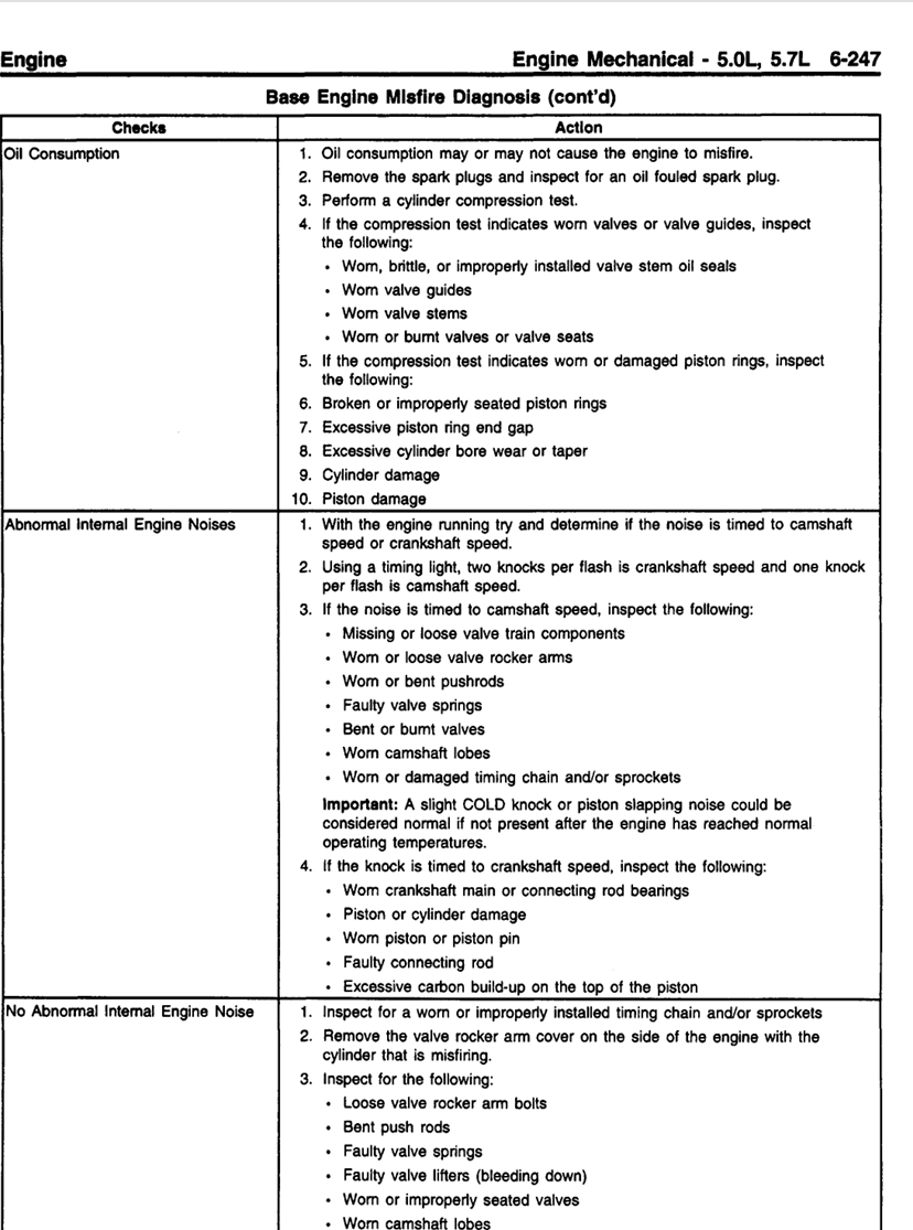

Using a timing light, I get one knock per flash which (per GM) should point to the valve train.
Pulled the right valve cover and watched the rockers. I’m not exactly sure what a collapsed lifter would look like, but they all seemed to move identically. The noise didn’t seem to be focused on any of them in particular. Is there a way to tighten/loosen the rocket nuts to verify if it is actually lifter issue?

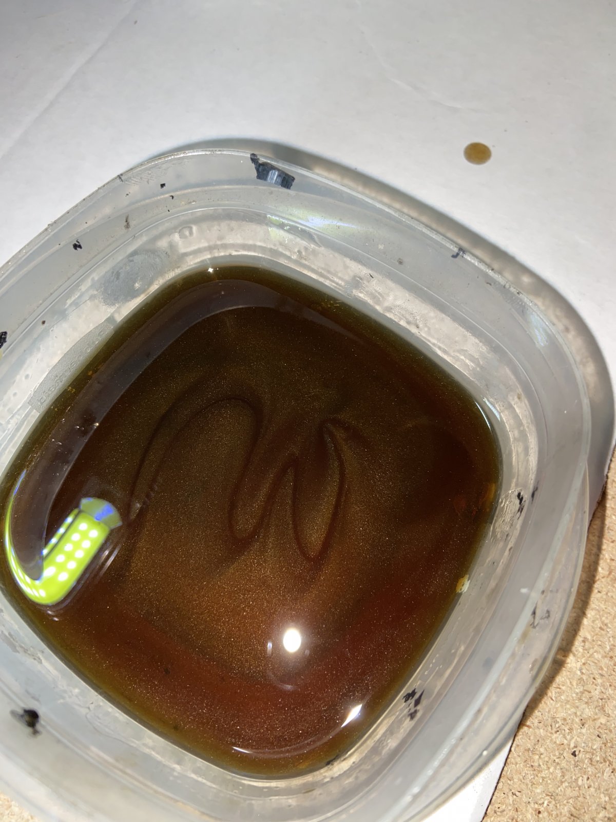

Pulled the filter (Mobil) which had 230 miles on it and poured some in a bowl.

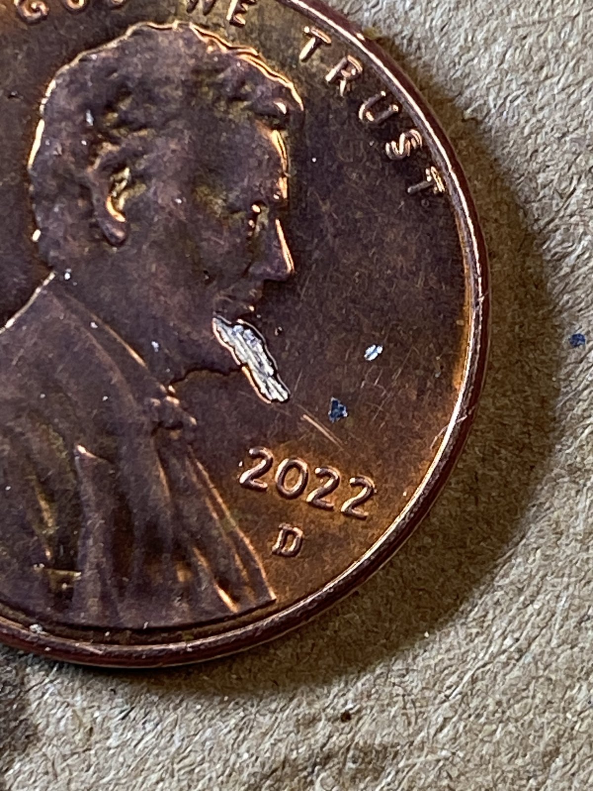

Cut the filter open and do have metallic dust in the pleats (upstream face). None are magnetic and you have to hit the light just right to see it. The largest piece is this one on Abe’s chin, the majority are the size of the two pieces to the right above 2022.
