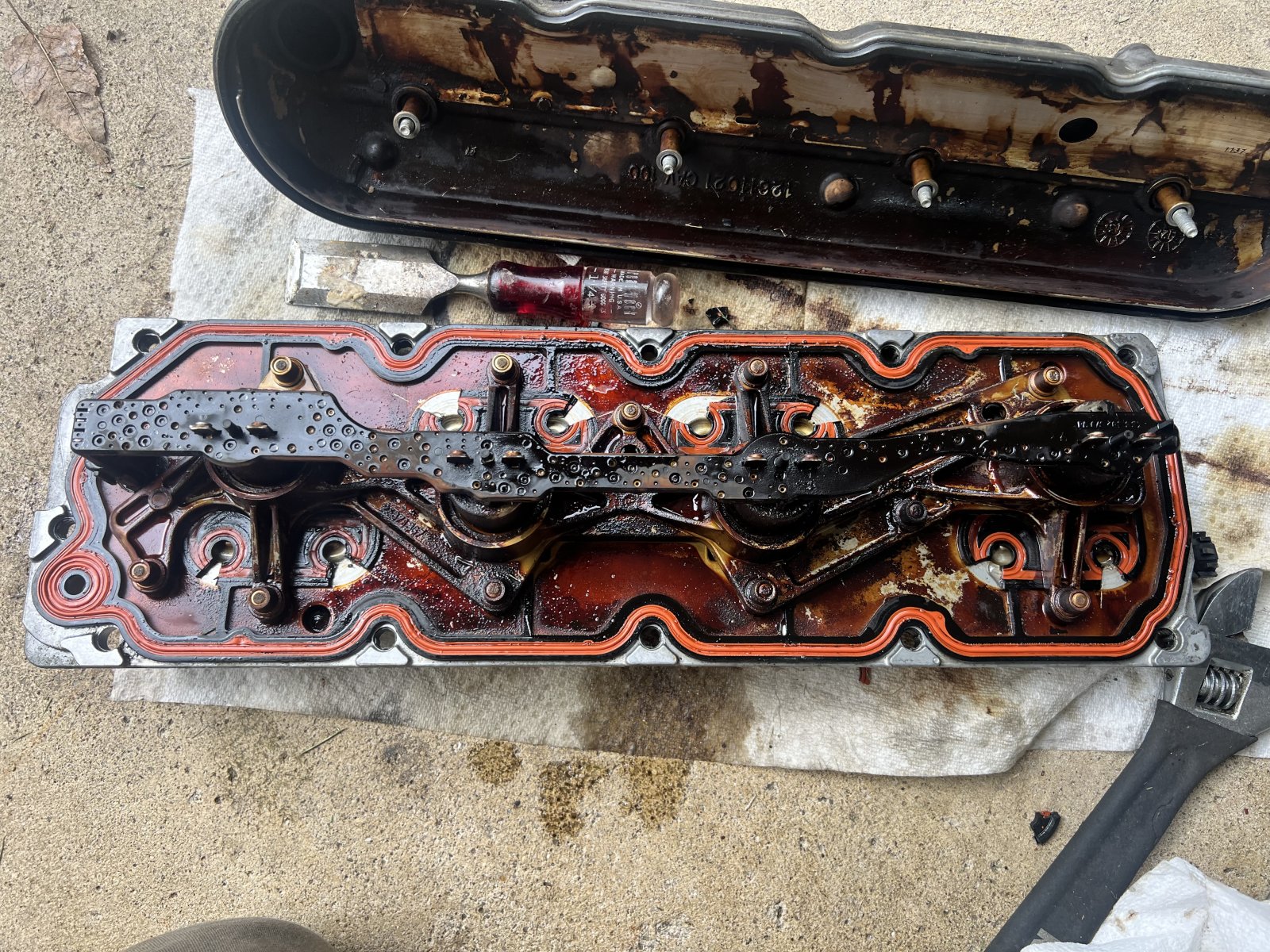

I could start it but don’t try to drive it or I will initiate the AFM and cause same thing to happen again.
Something that can get you by for a little bit (I think, someone else please confirm) is keeping the vehicle in m5 whenever you drive it. (After you get your lifter released). It won’t activate AFM and will get you down the road without having to spend $200 on a disabler right now.
I cut my gaskets on my VLOM to make it so AFM physically could not activate, even if for some reason it tried to with my disabler. This was secondary insurance, along with the Crazed Performance release kit that has a plug for the VLOM to block the oil passages
I know it’s hard not having somebody to look over your shoulder, but many of us are very active and will reply ASAP to any kind of help you need
I hope you updated that valve cover to the newer style.
thefrey
Feb 3, 2025
419
469
If you mean the flat style VLOM (pre AFM), then yes I put a new one on. Was part of my texas speed DOD kit.
It had gaskets for the towers but I still plugged them with tapered bearing rollers and still put the gaskets on for redundancy.
