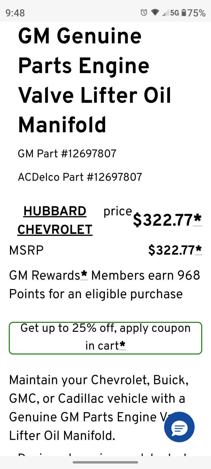

did you disassemble the entire vlom (afm actuators) from the underside of the valley cover? the gasket does come with the pedestal gaskets but kinda hard to mess up. and the perimeter gasket doesnt do anything for oil pressure
