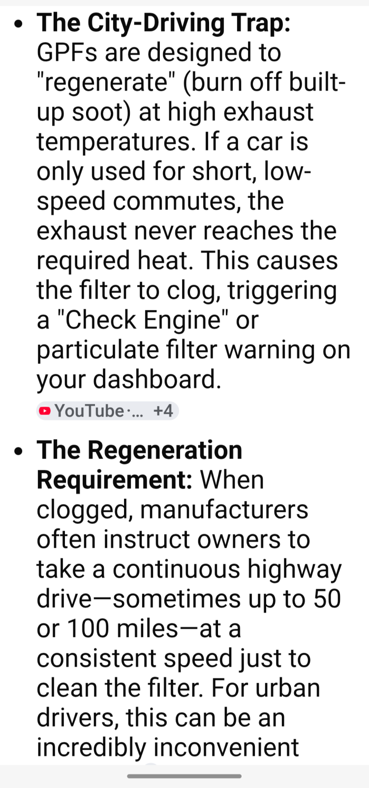

Be cautioned about any of these new vehicles if your commute is shorter than 20 or 25 miles across town. When that check engine light comes on for the GPF, and it's too plugged up to clean itself..... You're at the mercy of the dealer who will have to remove it to clean it and potentially replace it. Driving the car not as it's intended is not covered by warranty. This is the big issue the rest of the world has lived with, and now it's going to be dumped on us.

Just imagine.... Your engine has been derated because that light came on. And first they want you to take it on a 50 to 100 Mile drive maintaining 3200 RPM to see if it will clean itself. So what, after work take a 100 mile trip in third gear on the freeway? And this saves emissions? No way in hell I would ever purchase one of these vehicles.
