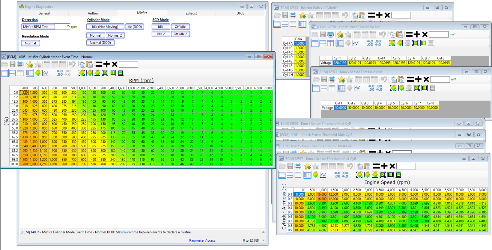

You mean know how to turn off misfire monitors? There is no spark or fuel by cylinder tuning on these platforms, so I don't see how it can be tuned for it.
The issue is an imbalance in events because of different lobe profiles on the dod cylinders.
There are misfire sensitivity tables that can be desensitized.
Don't know if those tables are available after HPT Version 2.4?
They're available to the older tuners who got OBD2 TunerCAT before it got sold to 'JET'.
They're available to the older tuners who have OBD2 TunerCAT.
Yeah they still have that. Is it knock frequency calibration vs cylinder, or a blanket sensitivity vs rpms and grams per cylinder load?
I can see changing the frequency calibration for the dod cylinders only to compensate for the misfire, but it is still ultimately misfiring because of a mismatch between the lifter specs and the cam specs.

It's POSSIBLE to tune for this, but the tuner has to know how to do this specifically.
NO, I don't think you can tune for wrong lifters..
For one I think AFM lifters are longer, base circle maybe smaller. Possible for longer pushrods to compensate maybe?
But easier to just get 1 AFM lifter if the tool doesn't work or you want more peace of mind.
Making sensitivities lower won't help anything unless you are getting FALSE knock/misfires?
Here's what I could find for individual cylinder tuning regarding fuel/knock/misfire..
No individual cylinder misfire, probably a calculation of crank position, ignition timing, and rpm?

Why am I the only one NOT typing a word about 'individual cylinders'? Not about to start now.
What I AM saying is to desensitize the misfire detection to the point where it does not care about the difference between AFM vs non-AFM.
Obviously this makes misfire detection nearly useless. What would happen if every value in table 14005 was raised to 1,760?
Obviously just adjusting the entire misfire detection would work, but then you don't have a properly functioning misfire system.
I would never run a dod cam with non dod lifters, but if I was forced to do so, I would still try to keep as much of the misfire detection functionality as possible. Even if you fudged the numbers enough to stop picking up misfires, only on the 4 dod lobe sets, it would still leave 4 that are operating properly.
Its a dumb idea either way. If someone is going to pull a head and not do a dod delete, might as well just throw in another dod lifter and carry on with life.
