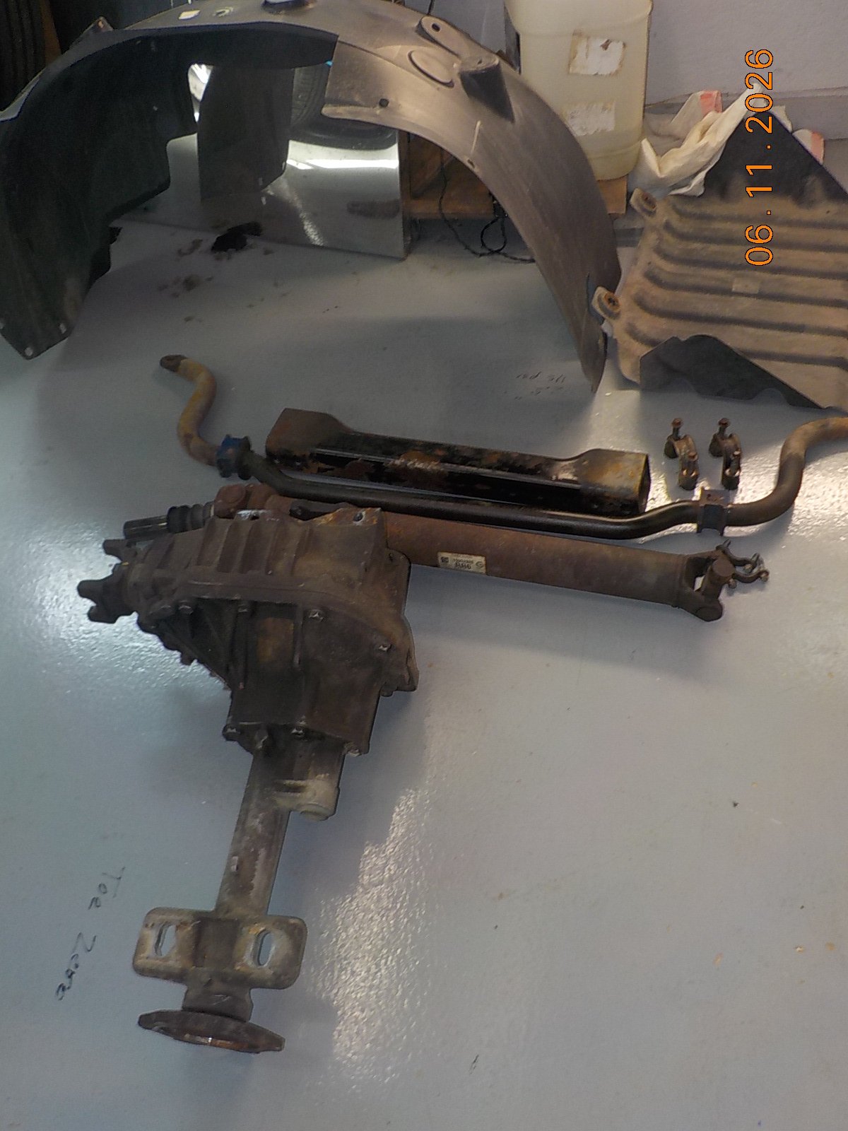

I always drop the front diff
and use a floor jack to reinstall
donjetman
Oct 22, 2018
2,010
3,694
@opfor2
I took the trans pan off too
