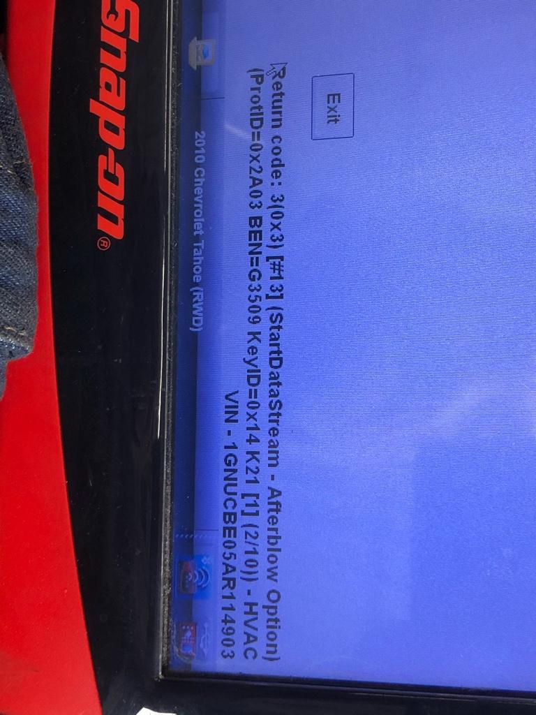

Hey guys. When we tried to turn on the afterblow option we got an error. Anyone have any idea of how to fix this?

Check afterblow option if it's enabled. This might not be an error after all.
