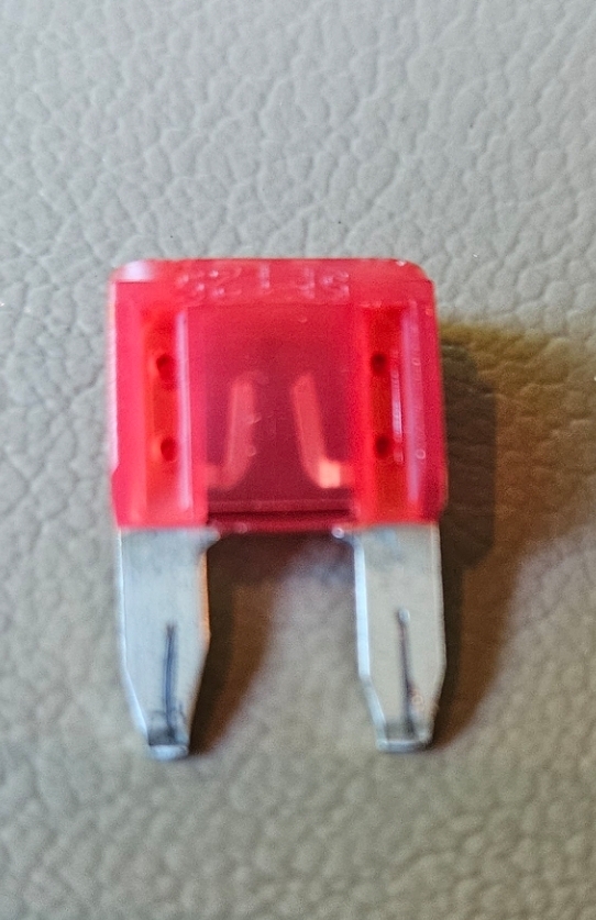

Last night I started it up to find only the IC lights flickering....along with the 3rd one blown now.
#17 IS LPS.
I will have to recheck the visors. The only thing I have done in the last 3 days was move my LH visor over to block the sun.
D
dkad260
Jul 21, 2019
659
674
Looks to be the driver's side visor causing the issue, I know @mikez71 mentioned the visor in the beginning, what threw me off was the passenger visor had similiar readings. I moved the visor to the side to block the sun and extended it, that night I noticed the flickering. I replaced the fuse and all was good, my son drove it another day and the following night he said the lights were flickering, I asked him if he extended the visor and he said yes. I have since unpluged the visor and no issues since, I do want to take it apart and see where the likely chafed wire is. The fuse would blow only when the visor was extended, not when just moved to the side.
