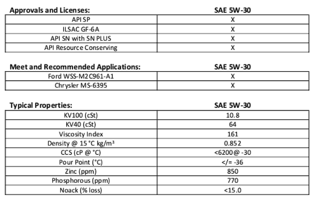

I’m using 5w30 restore and protect. I have been wondering if additives would help but it’s about 50/50 whether the lifter is noisy or not
21,321
30,318

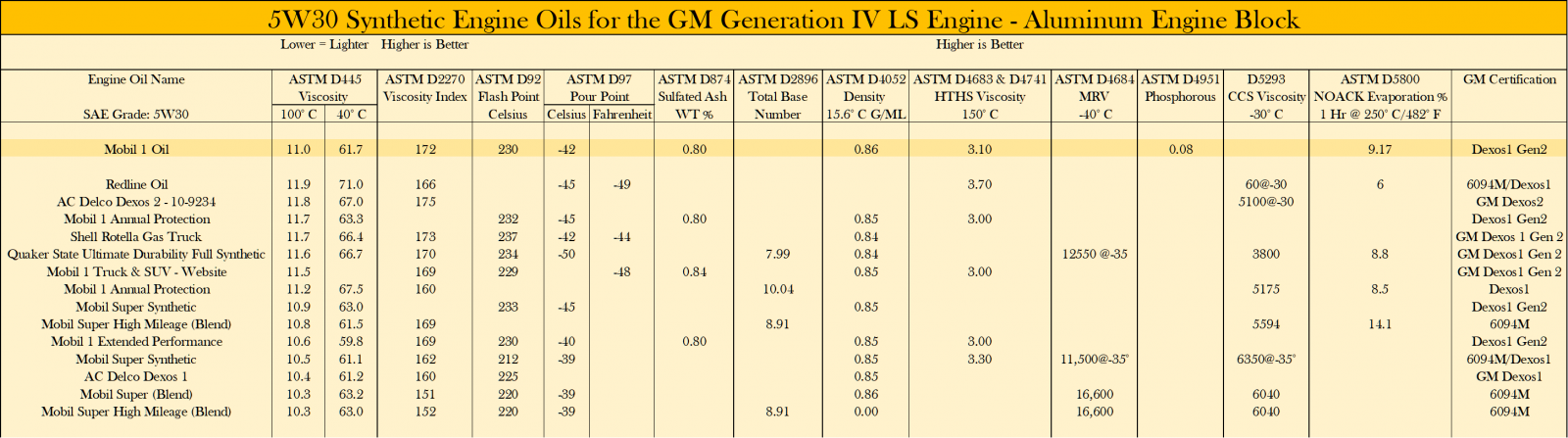

Your oil is too thin. Valvoline Restore and Protect, right?
See that KV100? That oil is 10.8. Too thin, you want well over 11. See the Viscosity Index of 161, too low. These LS engines like higher, around 170.
Quaker State Full Synthetic works as well as ACDelco's oil and even Red Line's for reducing lifter rattle.
Those "thin" oils leave a lot of metals in the engine oil at the end of their run. I documented this with regular Mobil 1 and ACDelco and Quaker State in 2 different LS engines.
