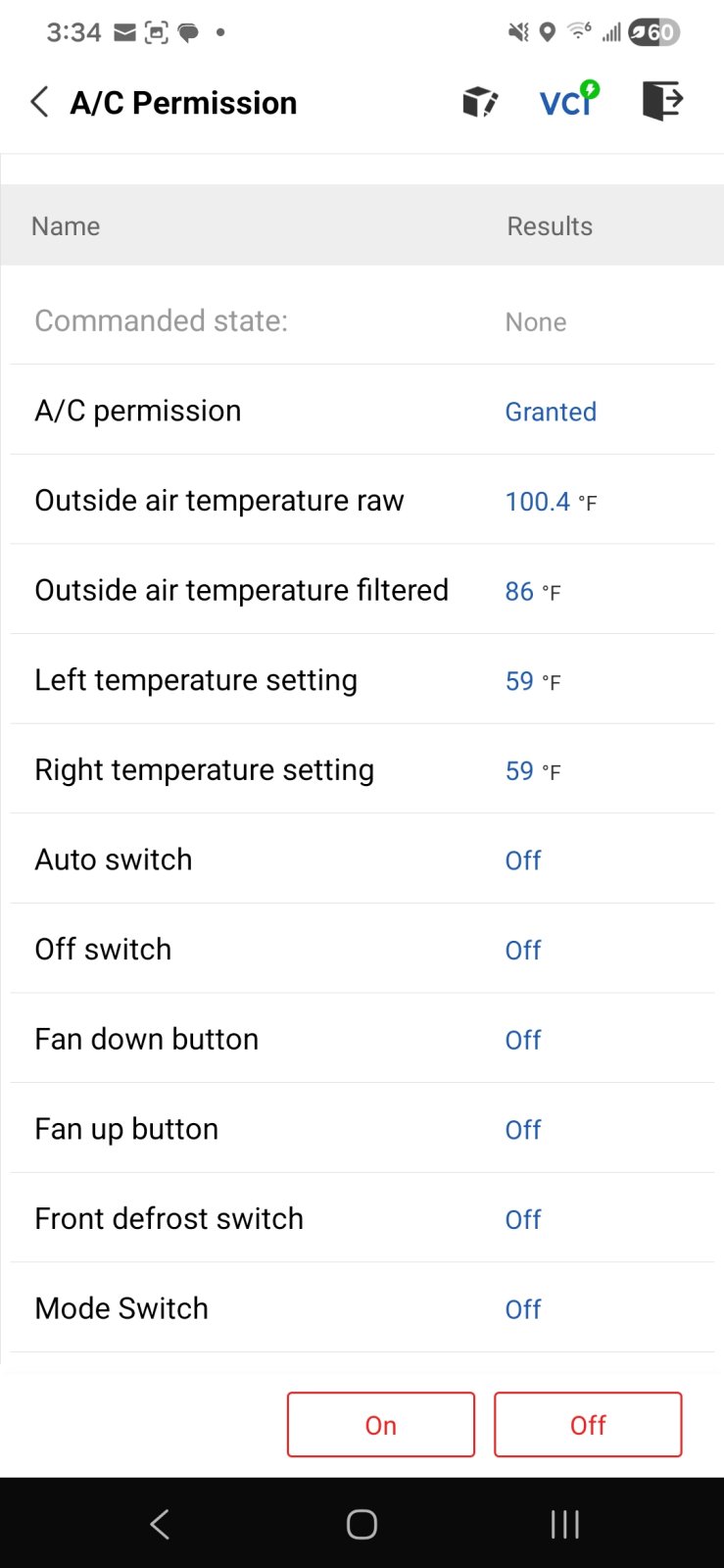

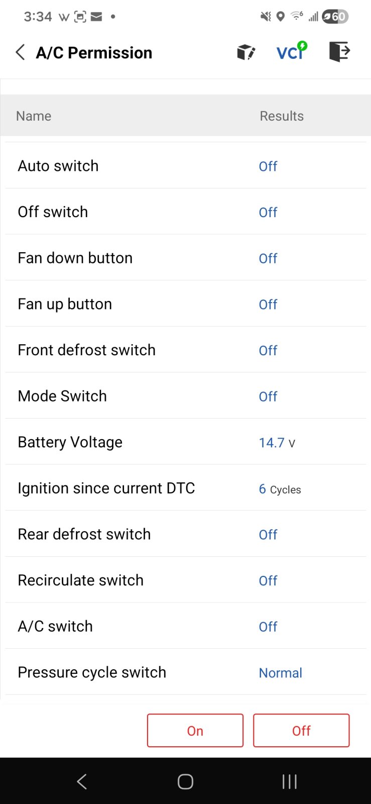

Get a scanner that will read all the AC PID. My 50 dollar top scan dongle will read all of this.View attachment 490272View attachment 490273
I have an Autel MaxiAP200 that does much the same. Bought them years ago for $35, they are now like $60.
Also of course the Tech 2 knockoff.

It might be under another tab. This is the HVAC tab. Actual pressure feedback is probably under the general tab if its there.
It will show me rear air ride system pressure so I would assume it would show actual ac system pressure too.
A/C high pressure will be shown in the engine section. This is because the high pressure sensor is wired to the PCM, not the HVAC module.
Anyone with Torque Pro or similar can read the high side pressure if they set up the custom PID for it. It's not hard to do. I can advise if anyone wants to do that.

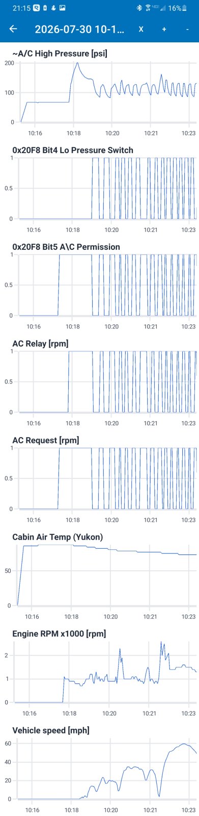

I had to run a short errand this morning. Decided to grab some data. Seen here is recorded data using Car Scanner ELM OBD app and a Veepeak Bluetooth OBDII adapter. Depending on specific Veepeak model they run from $15 to maybe $30. Some of the PIDs are custom, I created them for the 2005 Yukon 5.3.
