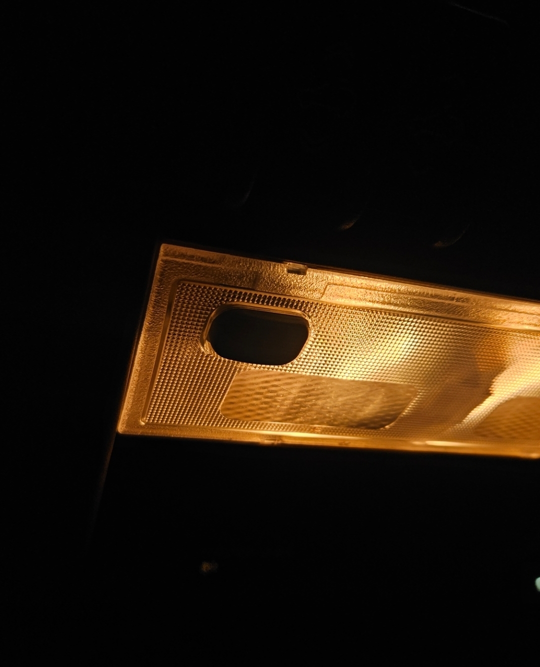

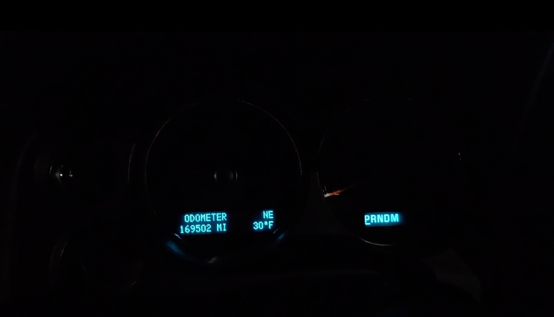

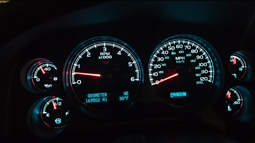

When I press this overhead map light button...
My cluster lights turn off.
Currently, the map light button will not turn on the map lights, but the interior dimmer switch will.

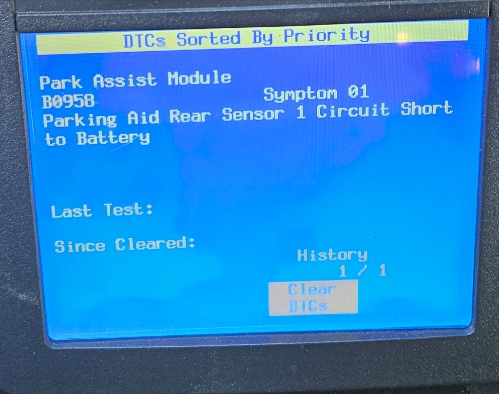

Sorry for not staying on this...but have had alot on the plate recently...but back in the game.
Symptoms of the IC lights are the same, but my parking sensor had been intermittent during this time and I didn't give it much thought. So I went to pull any codes and found this...
May or may not either be a correlation or possibly the causation. Going to take a look at the sensor.
