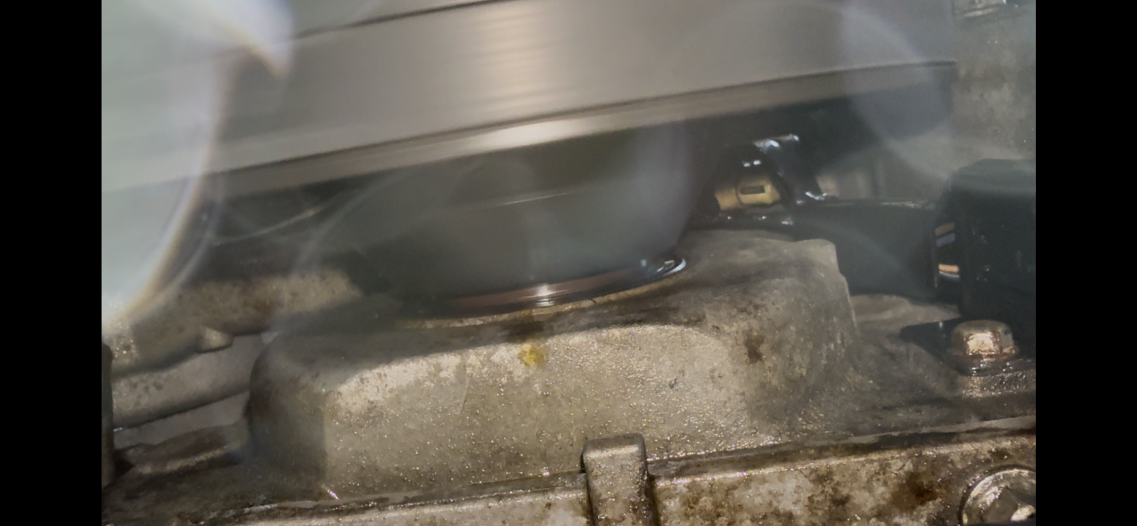

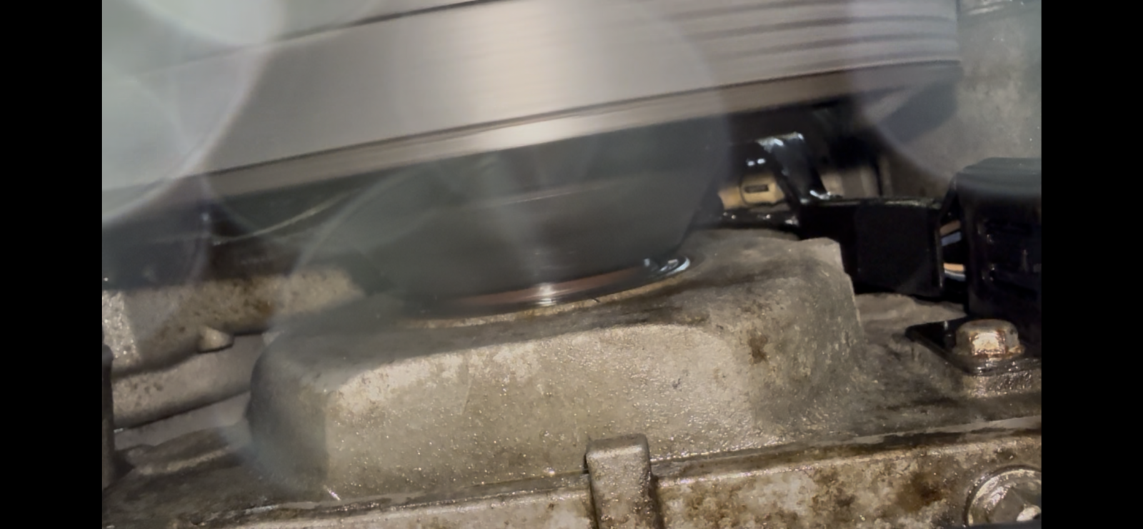

Update: it’s 1000% the front crank seal. Took a video and it’s leaking real bad. Don’t know why but need to figure out how to fix it…

Here’s the succession of photos as I went up in RPMs, though

This is where things make me scratch my head… I installed my front timing cover without the pan on so I am confused how I ended up with such a bad leak. I don’t really know how I could’ve been THAT far off from center unless I did something really wrong. I am gonna pull the harmonic balancer and try to measure how centered things are

It can be off left, right, up or down. I would guess where the seal lip is tucked inside could be the direction it's off.
It could also be a case of you have it centered and it somehow got damaged installing the balancer.
