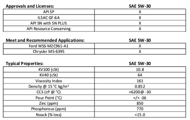

Your oil is too thin. Valvoline Restore and Protect, right?
See that KV100? That oil is 10.8. Too thin, you want well over 11. See the Viscosity Index of 161, too low. These LS engines like higher, around 170.
Quaker State Full Synthetic works as well as ACDelco's oil and even Red Line's for reducing lifter rattle.
Those "thin" oils leave a lot of metals in the engine oil at the end of their run. I documented this with regular Mobil 1 and ACDelco and Quaker State in 2 different LS engines.
Yes that’s what I’m using. Huh. Interesting considering 5w30 is what’s recommended
Is the KV100 dependent upon oil spec or is it the same across all viscosities?
I switched to Valvoline restore and protect because that’s what a ton of people have recommended in this forum since it seems to do a really good job at cleaning.
So, is a potential fix (maybe not fix but higher KV100) going up in oil viscosity? Or is it changing brands totally?
Is the lifter rattle potentially a byproduct of thinner oil which would cause the lifter to not pump up fully or is there another reason?

We're not talking about changing from 5W30 to something else. We're talking about the makeup of the oil you are using. The KV100 or ASTM D445 spec does change the range when you use different weight oils. But we're talking about staying with 5W30 and there is a variance between brands and their offerings as shown in the attachment.
Does that make sense?

5w30 can have a small range of 9.5-12.5 cSt for it to be 5w30.
I'm not getting a good signal on what the exact viscosity is for Mobil1 5w30. The two links below show two remarkably different viscosities and indicies.
The later link has a 'global' indicator and the former has a 'United States' indicator.
I would assume supply chains here in US are getting the oil with lower viscosity (10.8 cSt)

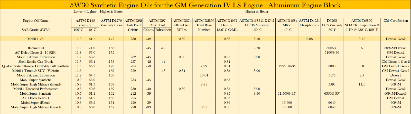

I would not change from 5W30 to something else. Definitely not 0W20 as it cannot handle the heavy loads on the engine when towing or racing for long term. The engines weren't designed for it anyway. GM used it to squeeze every last ounce of MPGs out of the engines at the expense of durability.
No additives either, the modern engine oils have good additive packs for our modern engines. One might need additives for an engine 40+ or more years old.
