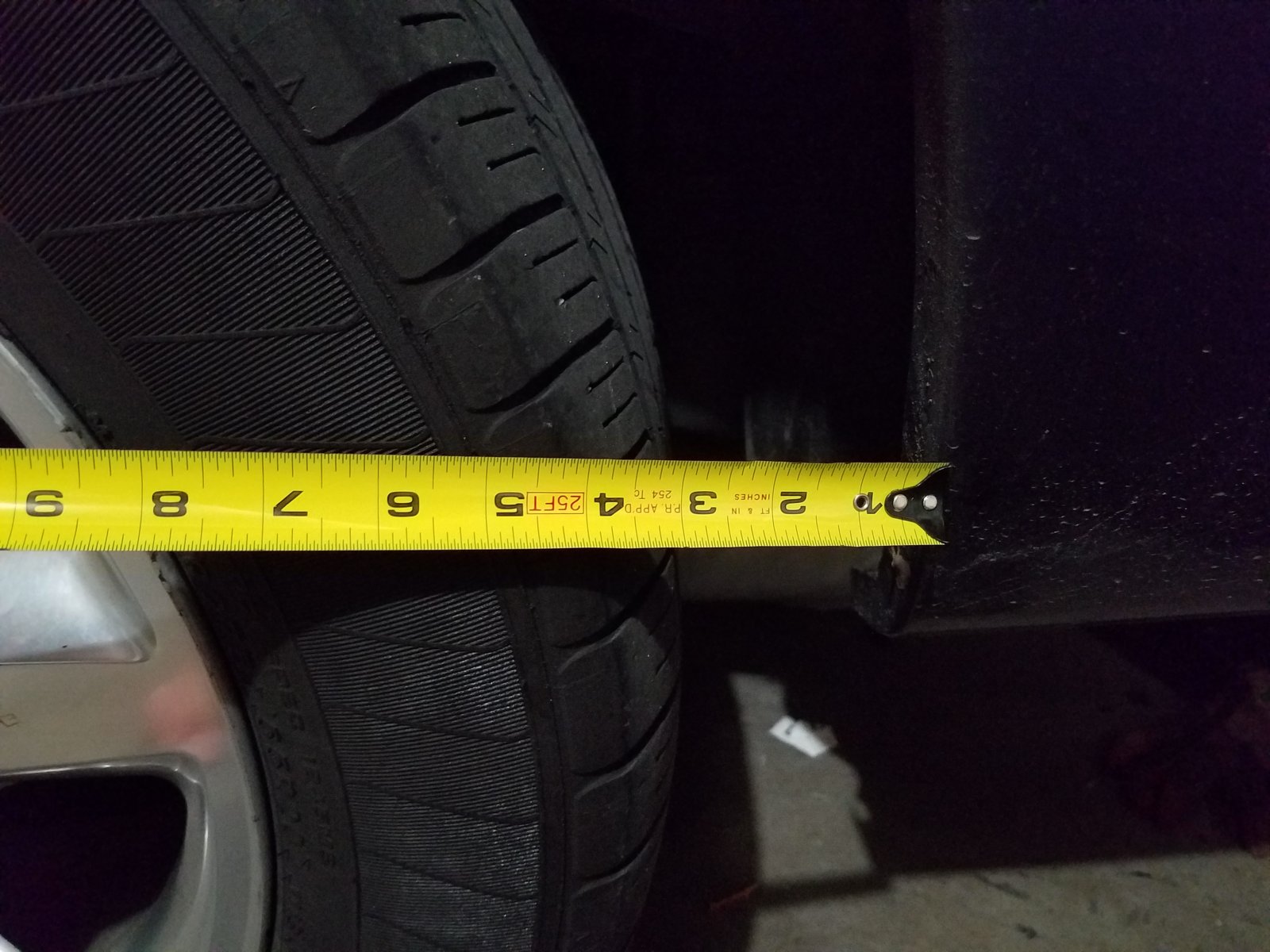

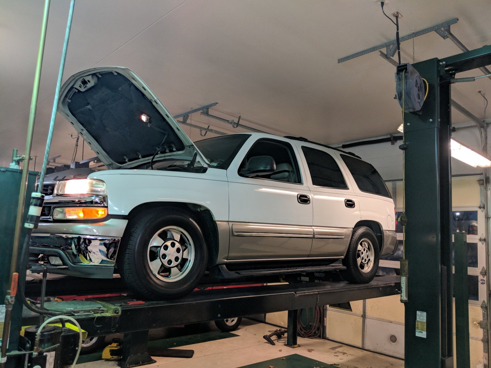

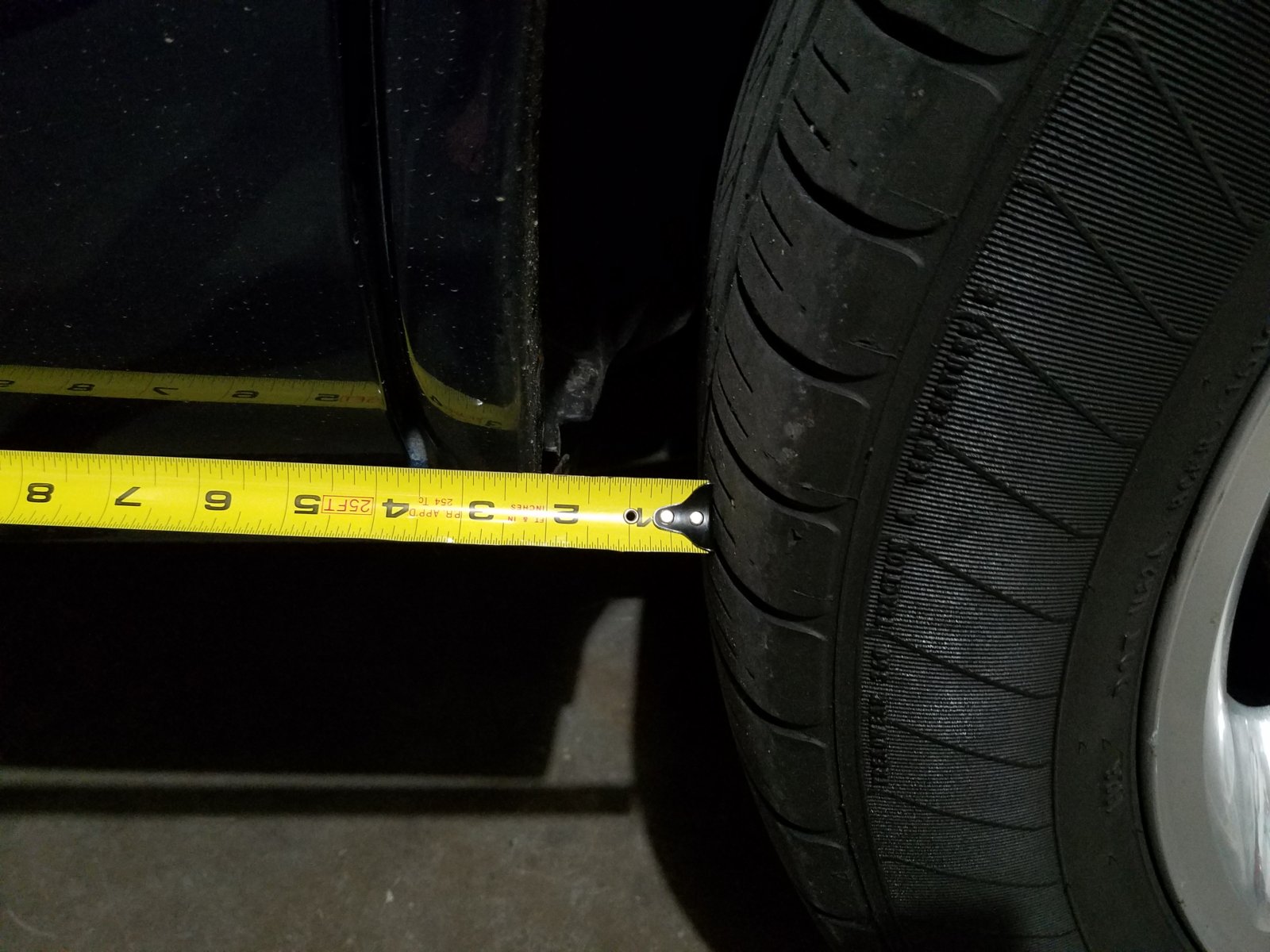

Feeling bumps more than before. Stocks need to be replaced tho. More sway and roll, but not in a "dangerous" manner. Suspension has settled, hate to do it but need to raise font one inch to match the rear ar 33.5"View attachment 208267 View attachment 208268 View attachment 208266 View attachment 208269
Any rubbing issues with those 275/55's at your current drop?
05Single
afraid of the dark
Feb 26, 2015
8,244
11,648
No and yes. Everything clears, but sharp right turns combined with bumps-dips my drivers side rear tire hits the wheel well liner. But that's because theres a bulge for the autoride compressor. So a typical non autoride tahoe would not hit. I need to find out the offset on these ltz wheels, might get 1/2" or 1" spacers.
