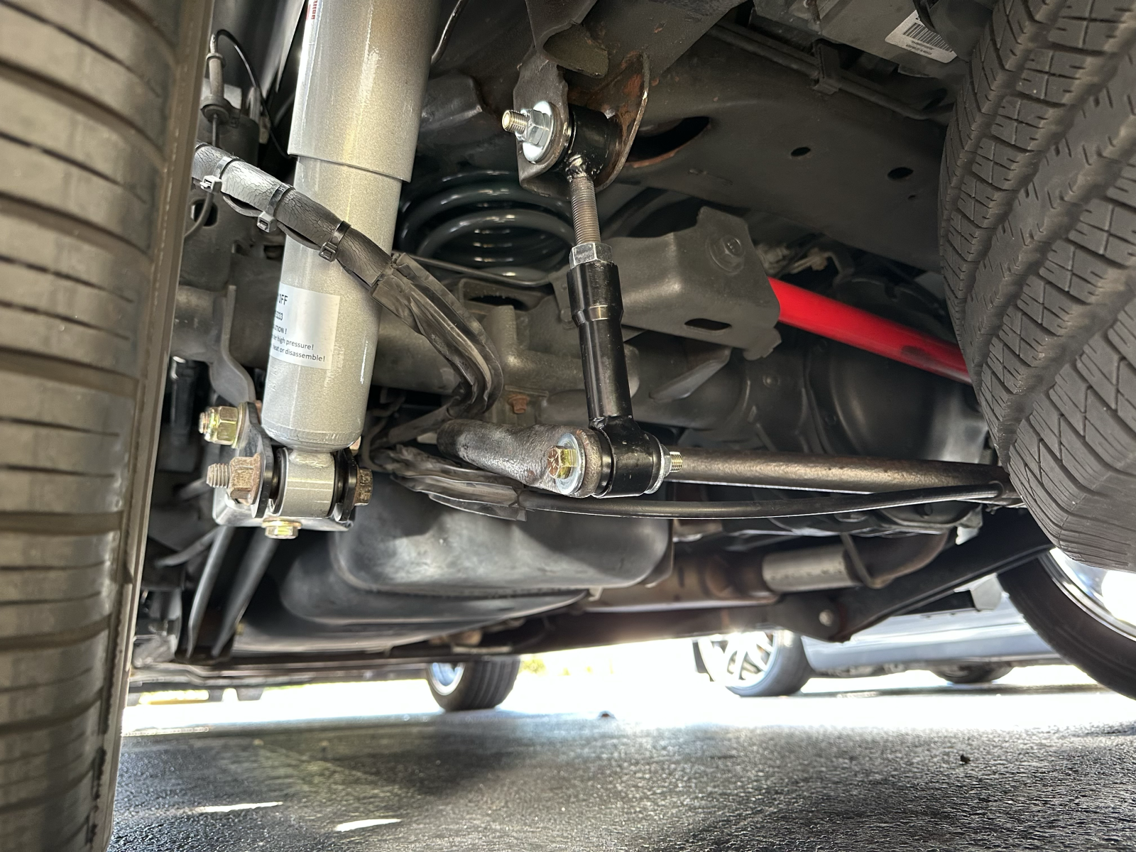

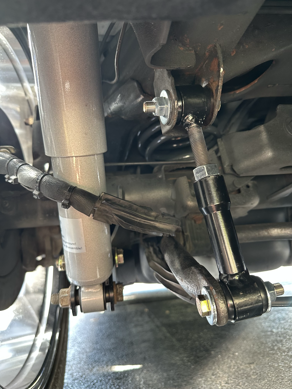

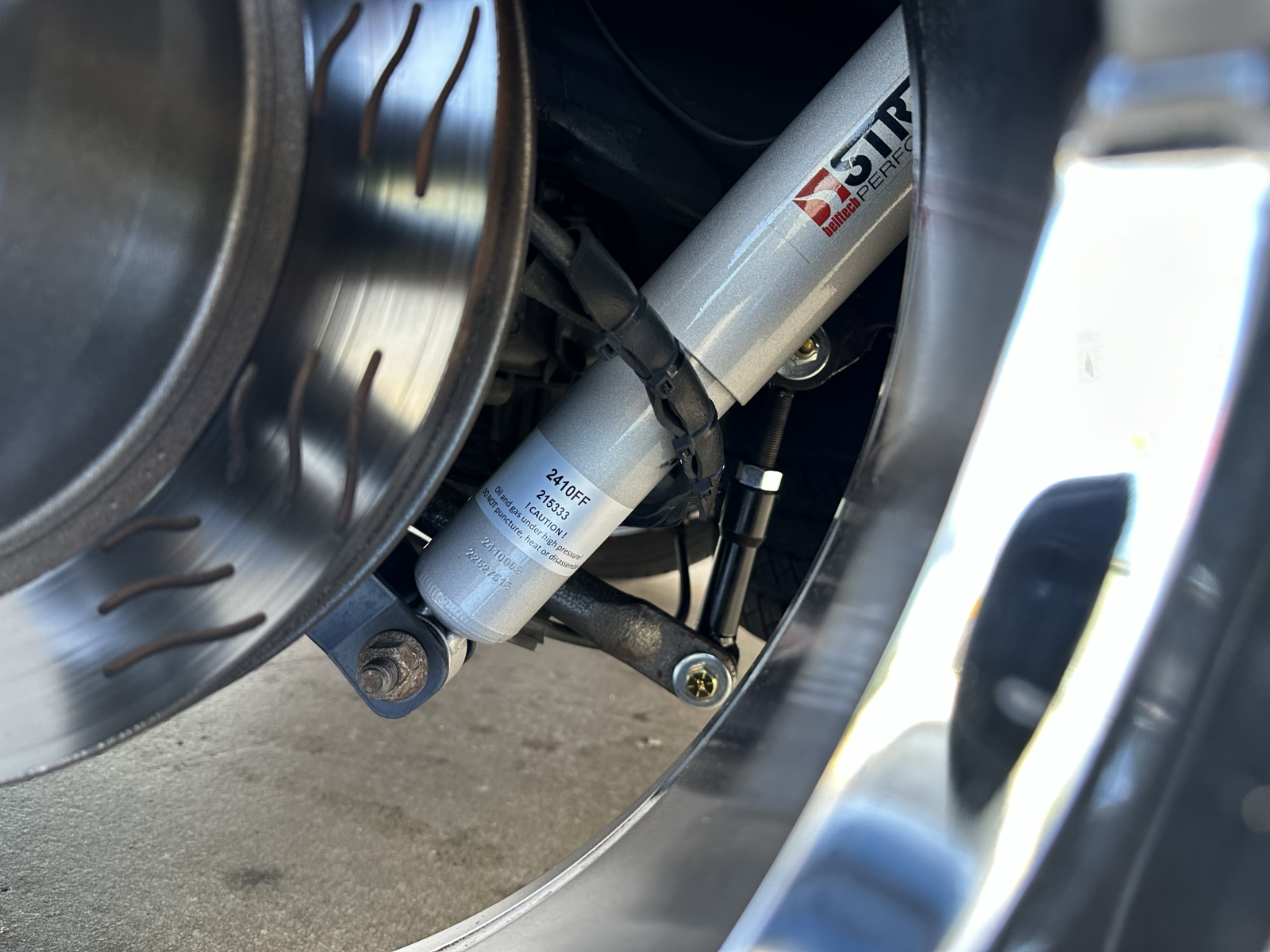

Had the shop install the Hellwig 7960 Adjustable End Links 6-8" yesterday which took care of the position of the rear sway bar. Just a bit down tilted below the horizontal now. I did have the DJM offset end links on hand for them in case they were a good fit, but they went with the beefy adjustable Hellwig's. Better choice and direct bolt on. Everything has clearance back there.
Thx @91RS for your input on the Hellwig end links. Good call!!
Can find them on Amazon or from Hellwig direct. When I called Hellwig direct to ask them for assistance, they could not have been nicer. From the lady who picked up the phone, to one of the techs in their shop. The few minutes in helping me find the right part for this install was very appreciated.

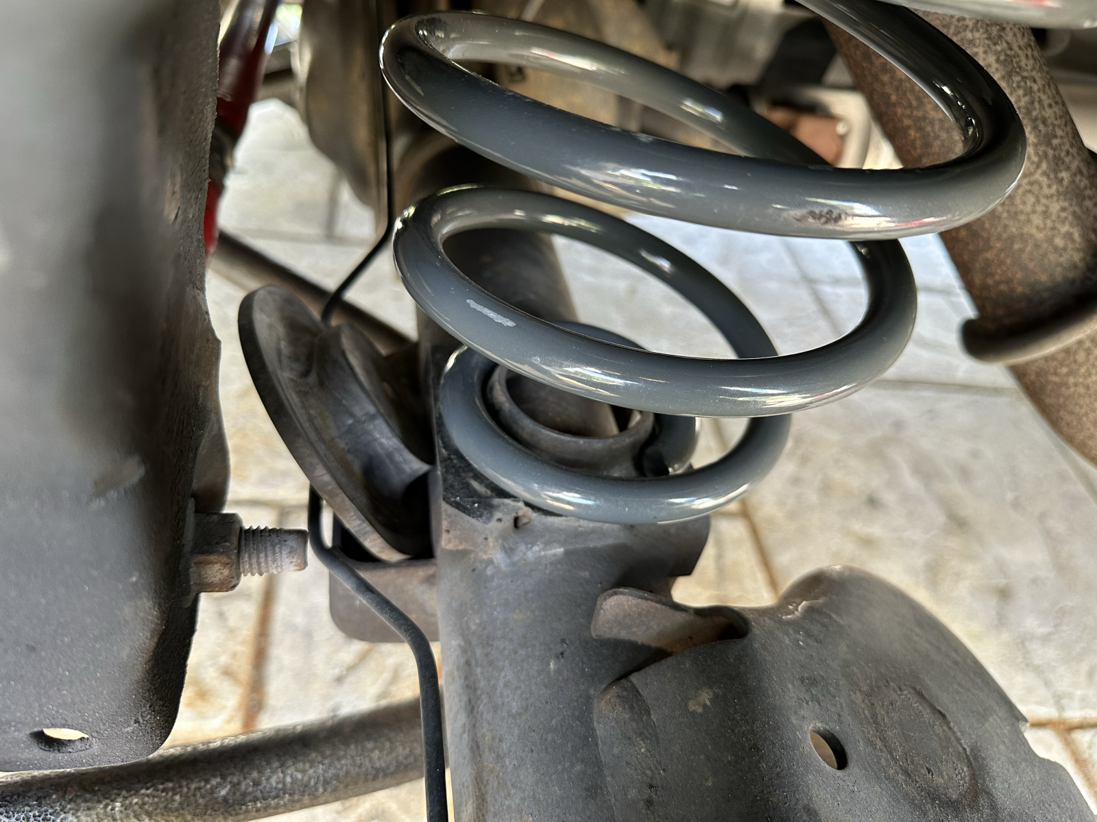

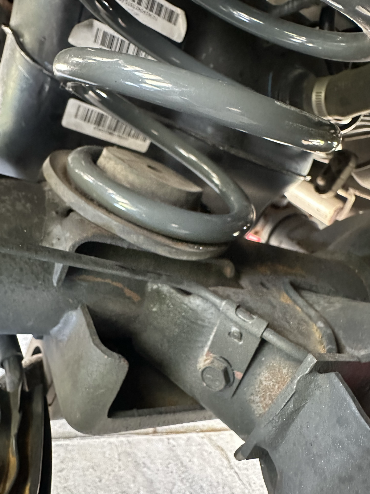

Somehow the rear coil rubber was either not installed or popped out? Not sure, but it was sitting on the frame after the first install a few weeks ago, so they put that back in place.
Found it sitting right behind the coil on the passenger side.
In place on the driver's side.
Handles like a 3 ton sports car. :driver:Everything seems to feel tight on the side roads and I-95 at 70mph. Just some front tire rub at full lock and can occasionally hear the rear tires on the fender liner. And the truck just looks good.

Those Hellwig endlinks look great! Much nicer than the DJM endlinks. I may have to grab a set for the Esky.

i have some very similar ones(maybe even older gen?), but the threaded side wasnt threaded very far, so i had to cut some of it off and buy a 1/2-20 tap to run some more threads on it. so i didnt recommend them
we gonna keep commenting, bar should be as flat as it can be lol
and make the bolts point the same way, my preference is head out
@07Burb Yes I was impressed. Not far off the diameter of the sway bar itself. They are stout! The DJM are nice, but the offset diameter is thinner and I have seen other threads of guys showing them snapping with too much sway. The Hellwig end links are 2 parts screwed together and quite a few threads down. Some solid hardware.

It's crazy that isolator just hung in there like that and didn't fly off. Those links are nice. @07Burb order me a set when you order yours.

I was thinking about removing my isolators to get that extra 1/2" of drop.

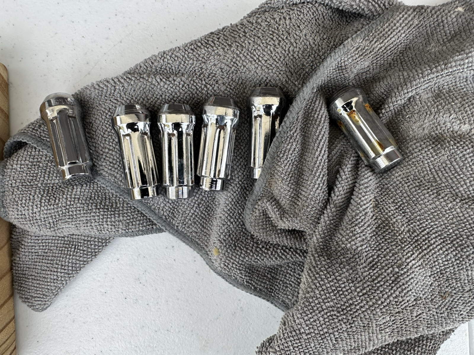

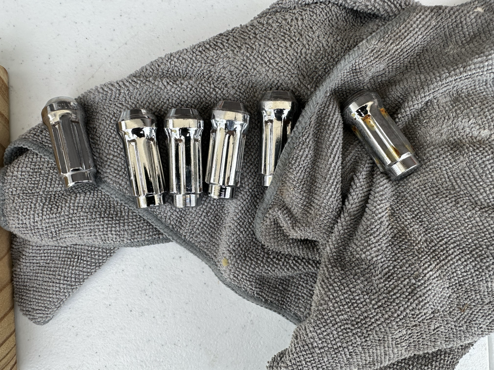

I gave the calipers and rotors a quick fresh coat of spray paint, then polished out the inner barrel, lug nuts and lug holes for both front wheels. Those spline lugs nuts do not like to stay clean in the grooves. Might have to go with another style at some point.

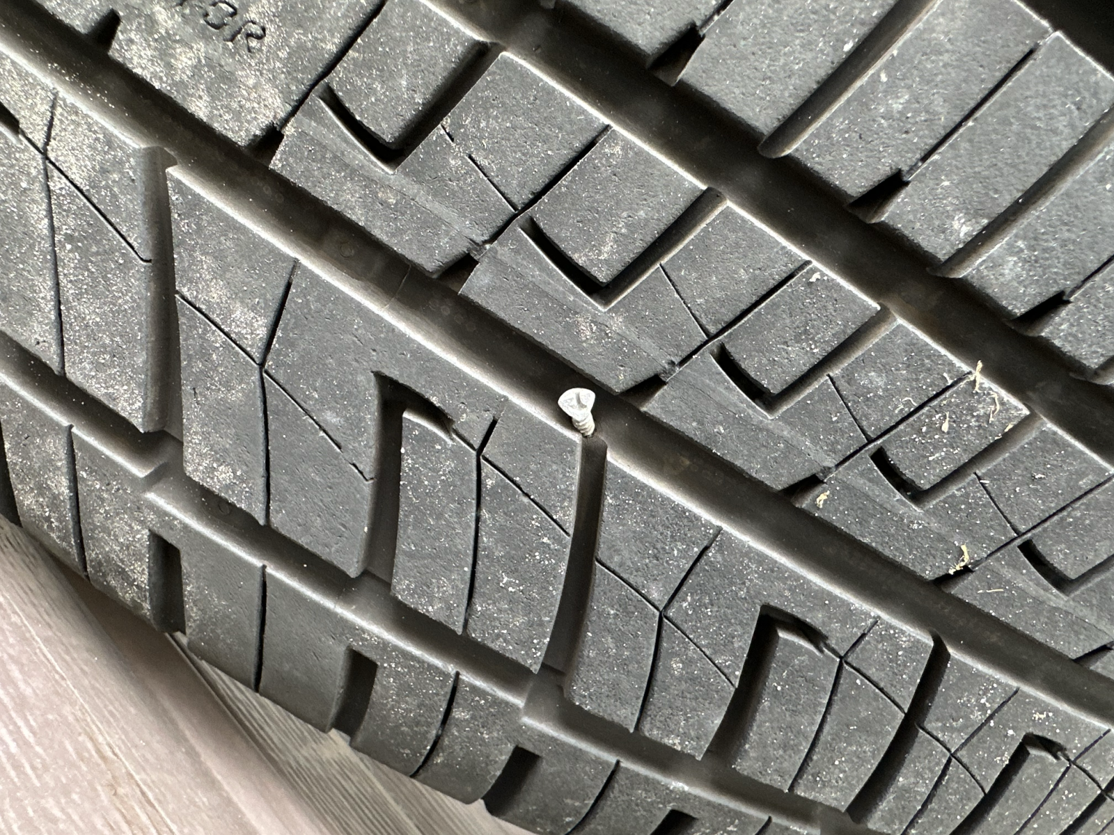

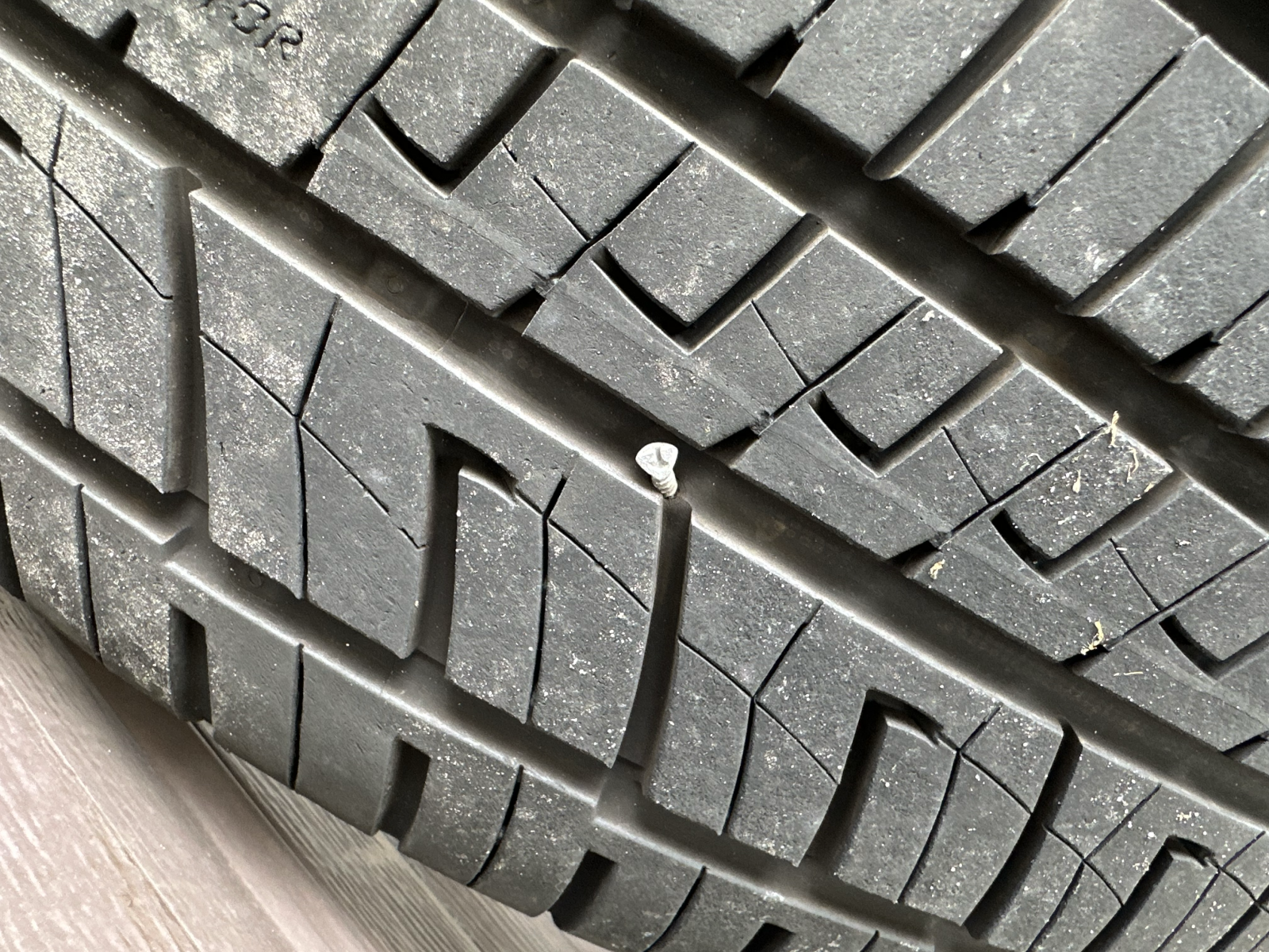

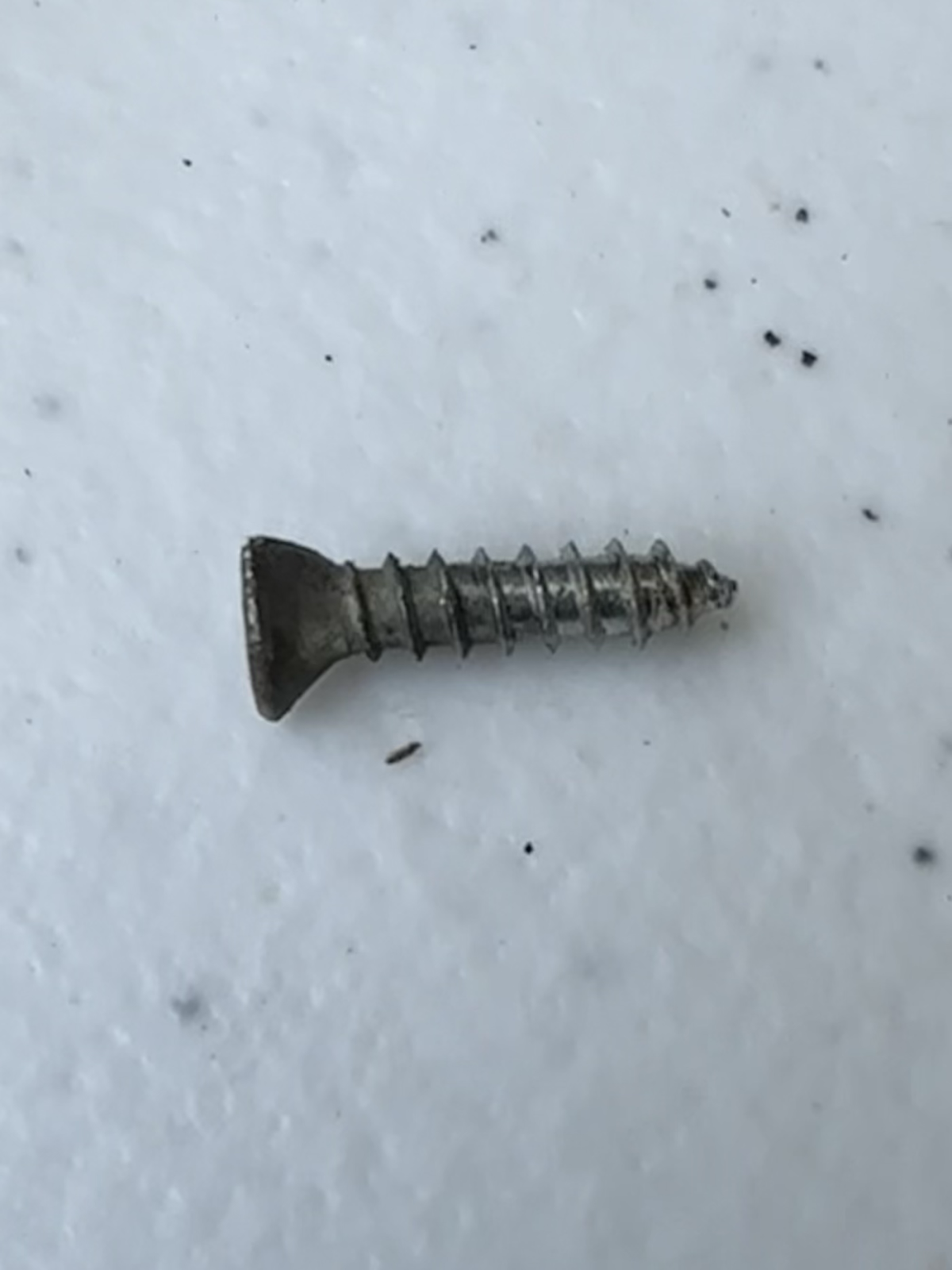

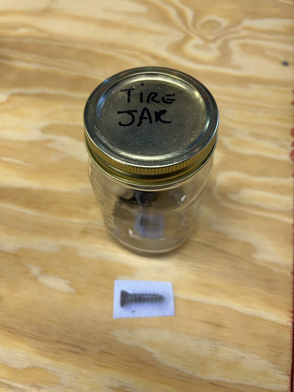

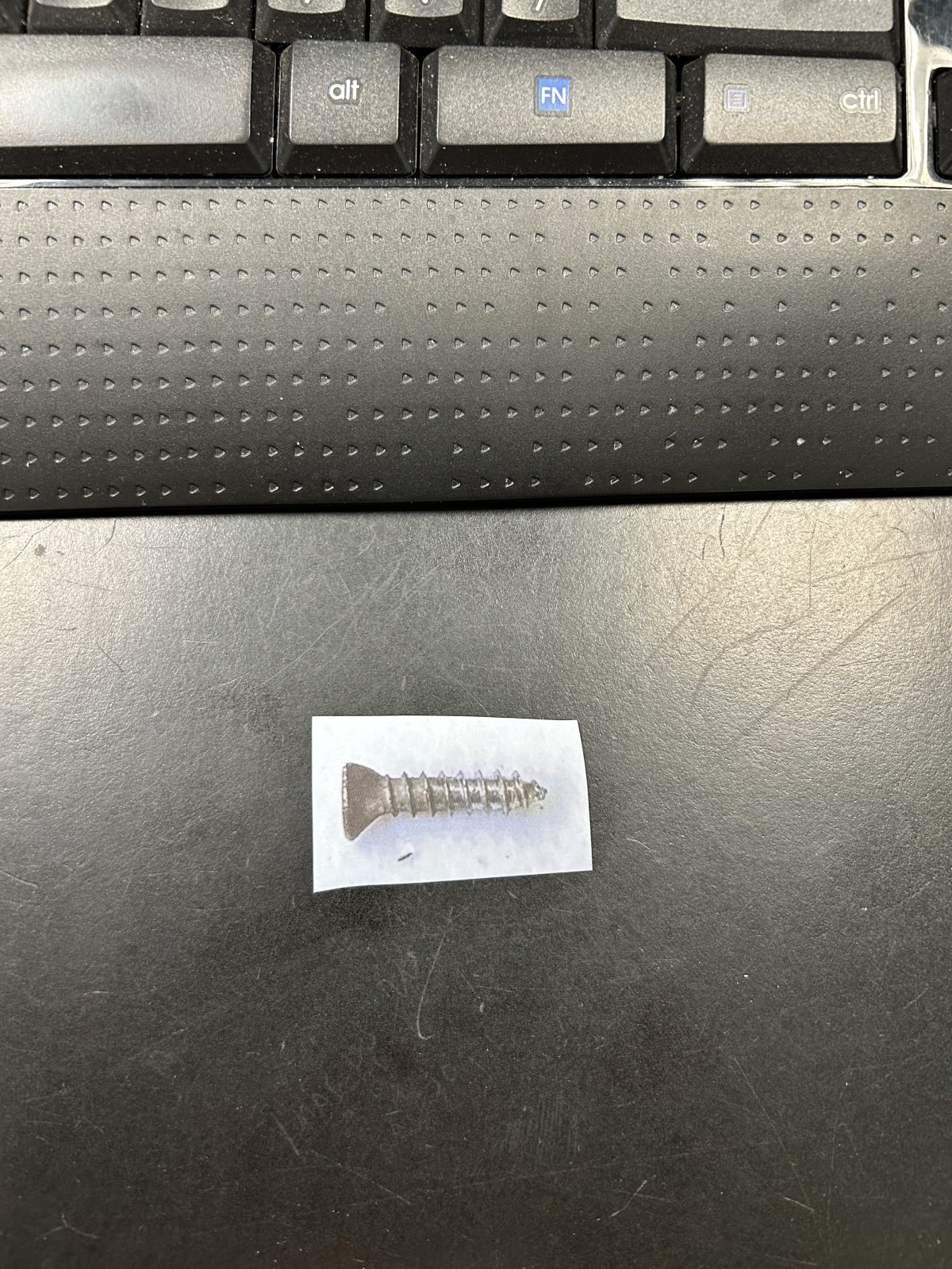

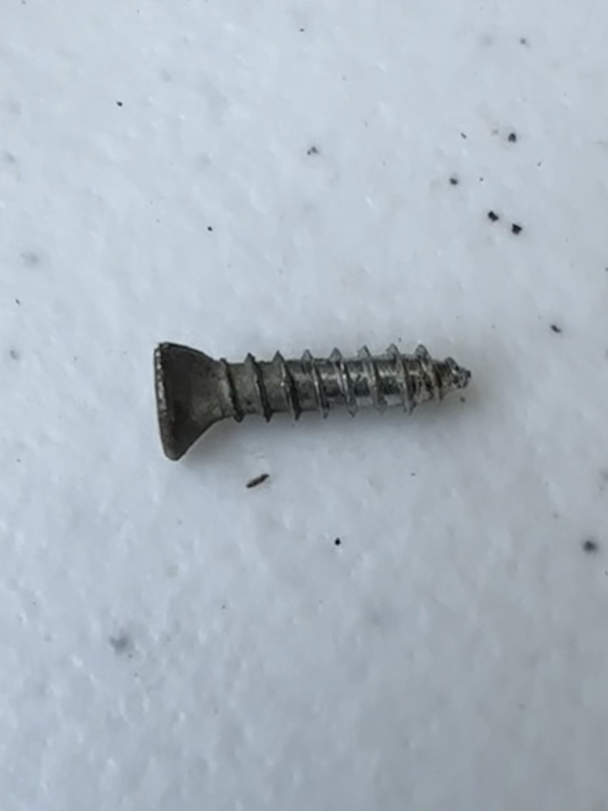

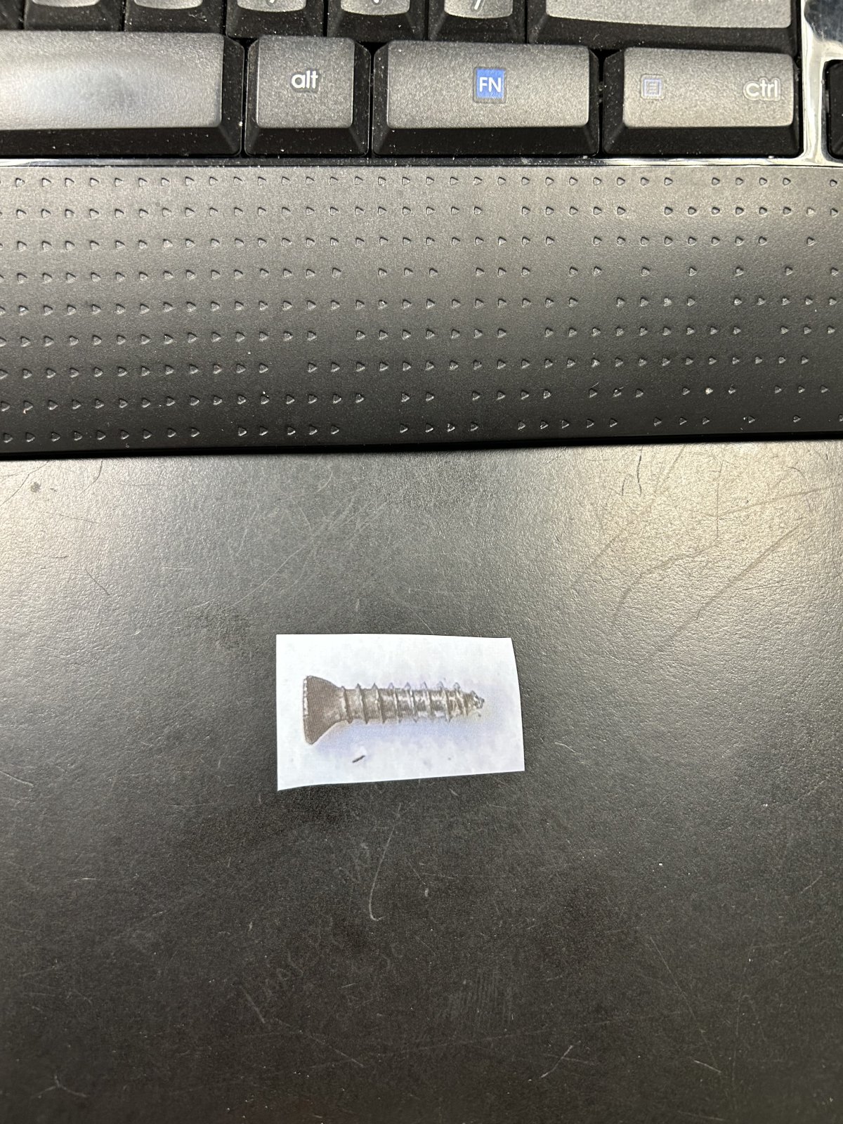

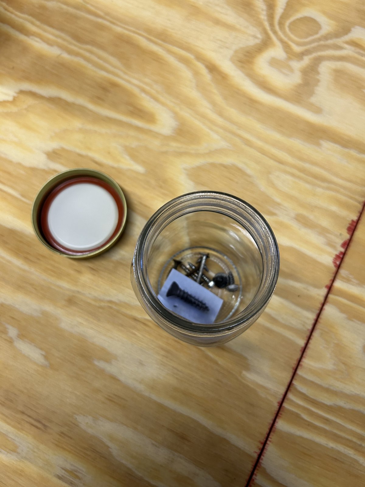

Once I got the passenger wheel off to detail it, I found a small screw in the middle of the tire. I pulled it out, dribbled some water on the spot and no bubbles, so that was a win.

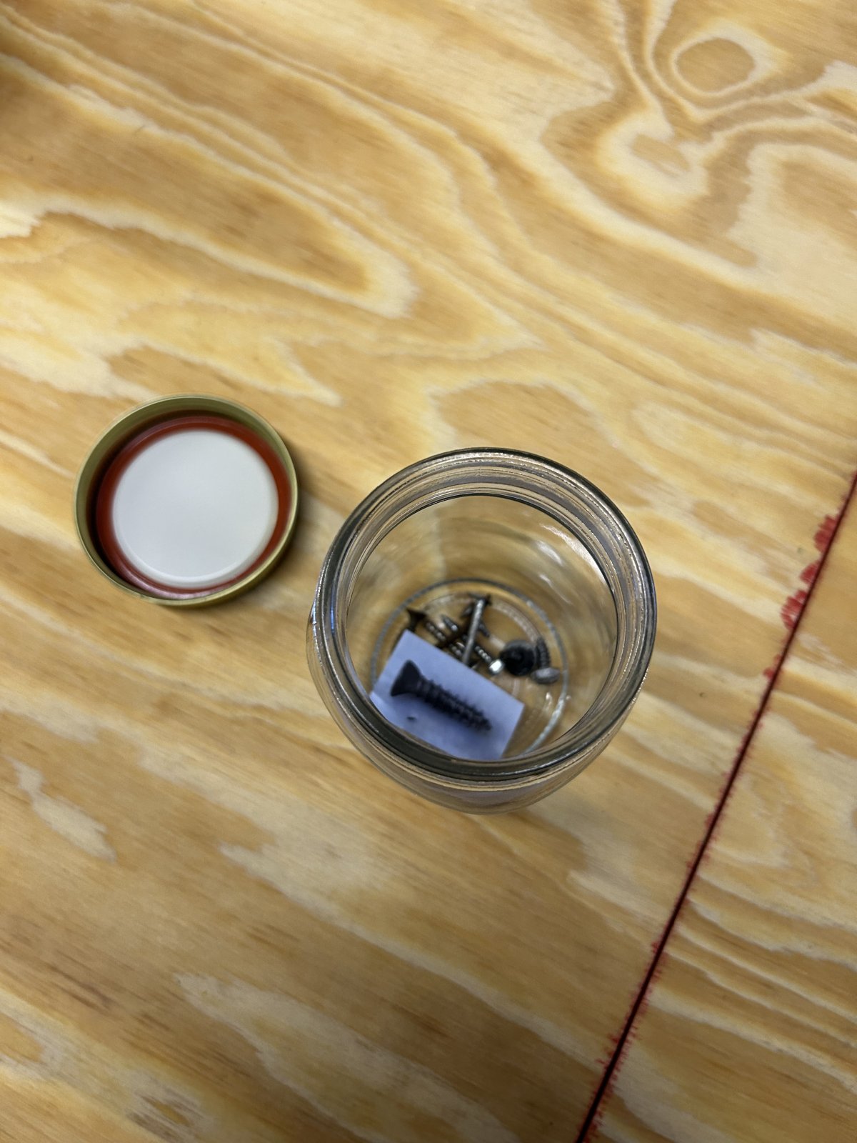

That's for your screw jar @89Suburban

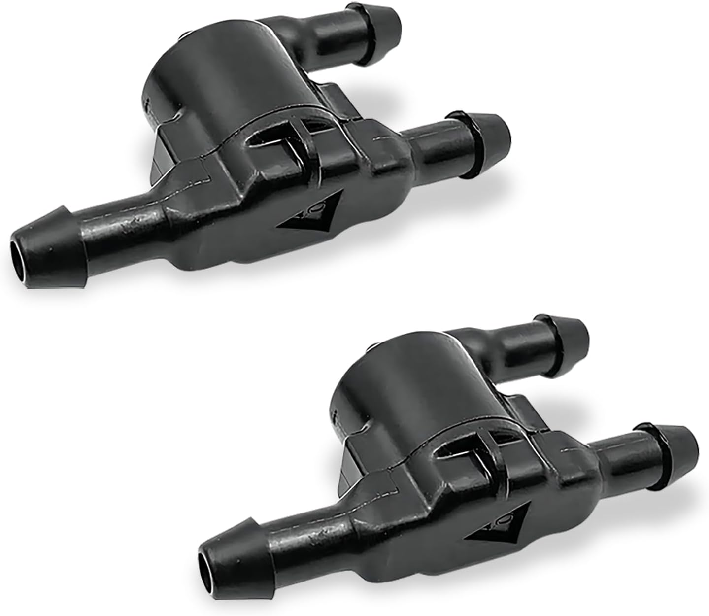

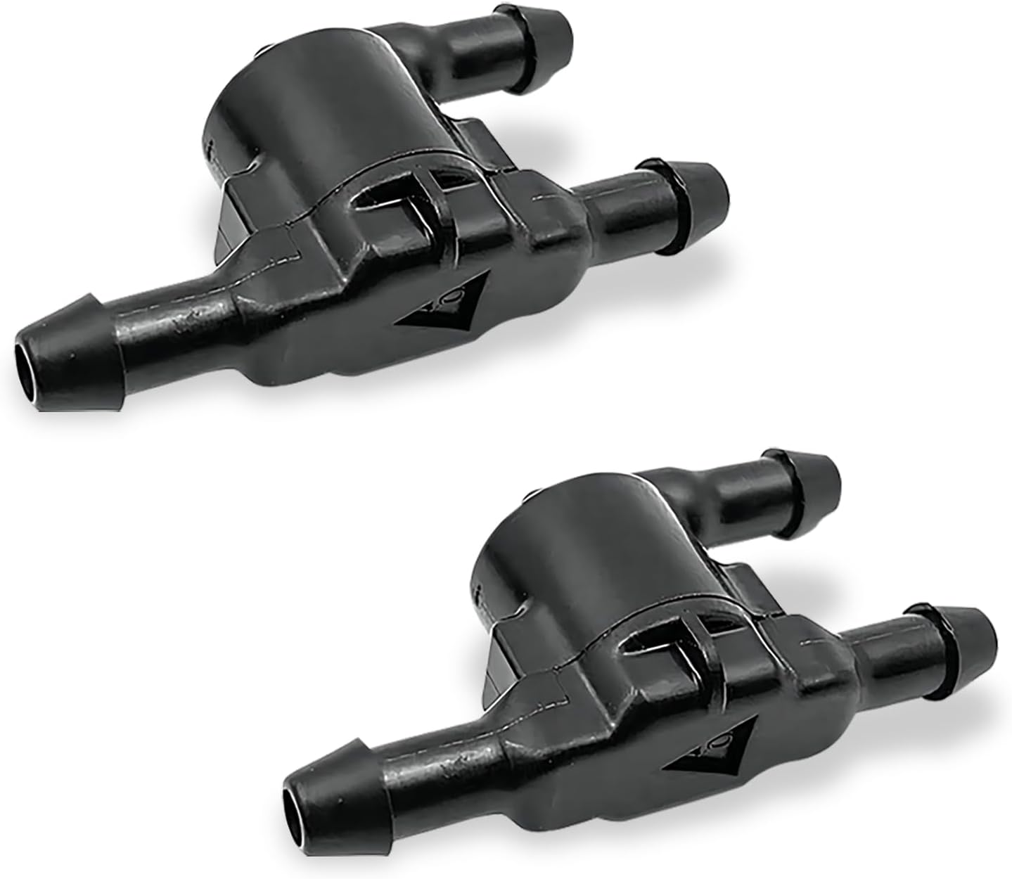

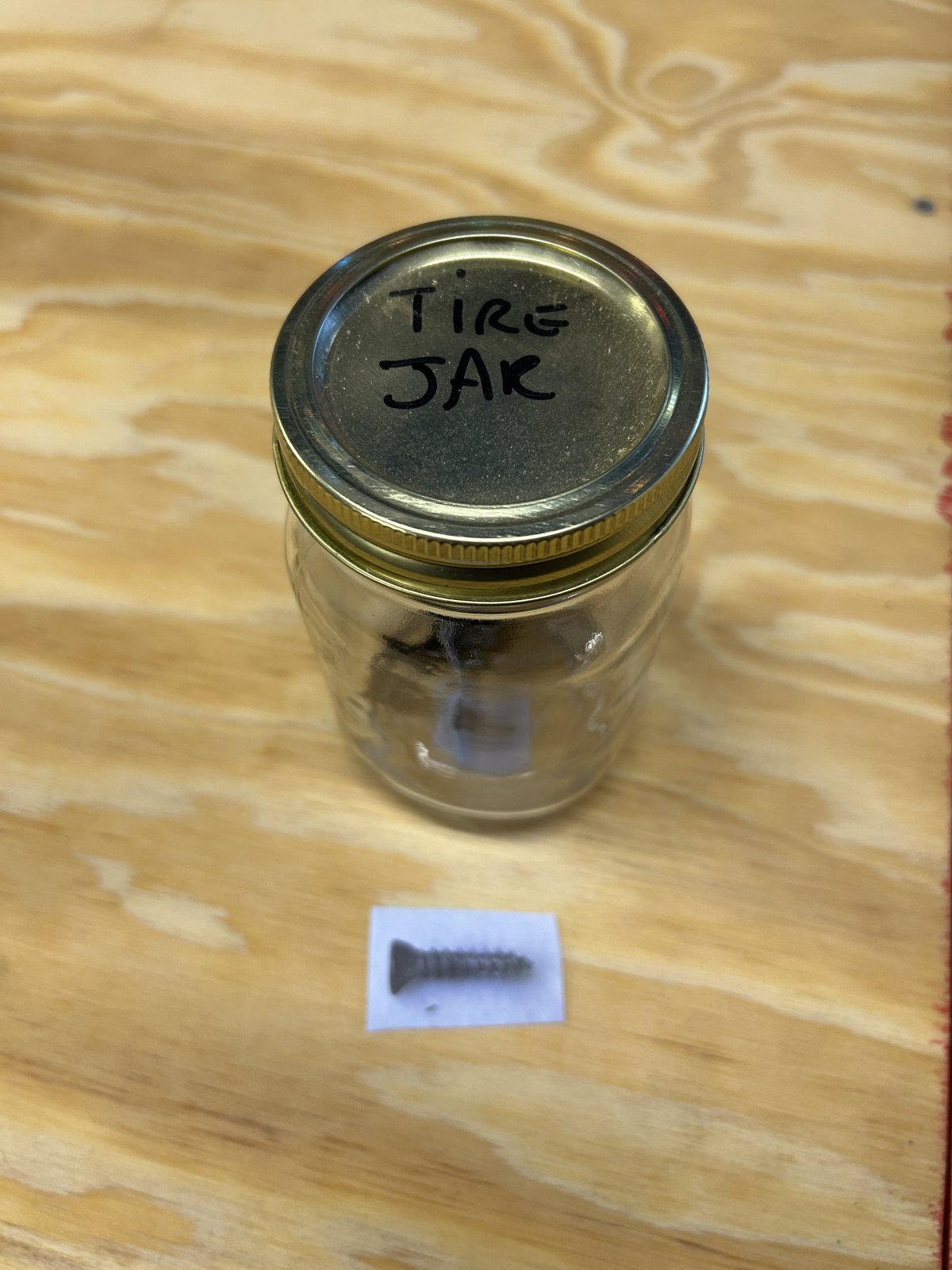

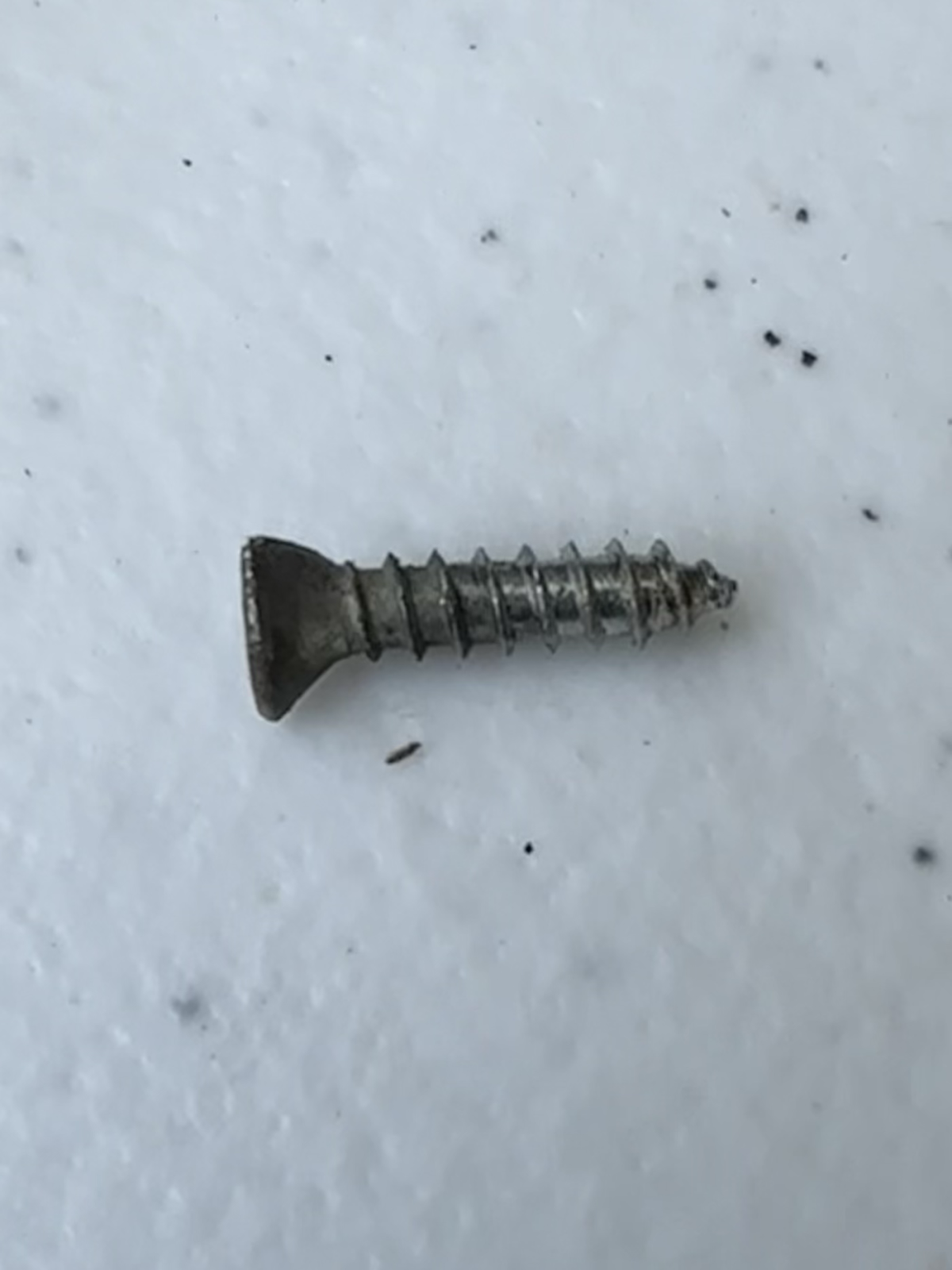

My son mentioned that his Camry passenger windshield washer was not spraying. The last time I looked at this for him, the hose had come disconnected from the reservoir and required removing the passenger front tire and going in behind the fender liner. So I got started with that and then decided to look at YouTube and put the tire back on. Then I followed the washer hose from the nozzle as it went behind the heat shield and disappeared down the passenger fender.
I decided to start there at that connector to see if water came out. Water flow was confirmed, but I broke the brittle, dried out barb. I used a safety pin to poke the sprayer hole to see if any grit was in there. It was dripping, but not spraying. I tried the middle T-shaped connector and still flow, but that brittle connector broke as well. Darn it.
Managed to get the sprayer off without breaking it and confirmed water coming out of the hose. I did not break the sprayer thankfully. I suspect it was the T-connector. I jumped on Amazon to find some connectors and will have those the next day and see if we can get it back in business for the lad.
