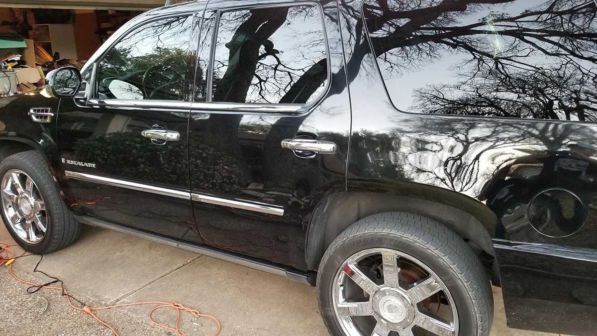

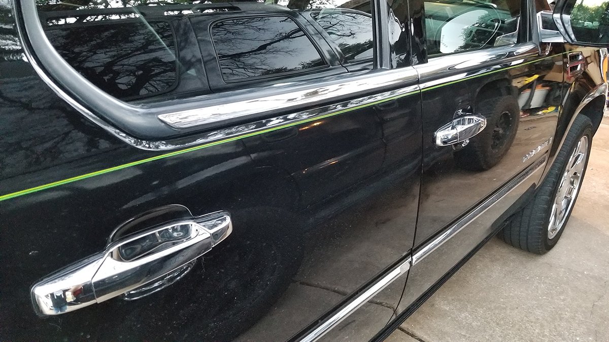

First thing I did when I got it home was remove the grey vinyl pinstripe that drove me crazy. I figured it would be pretty easy, which that part was, but little did I know it was there for a reason. Apparently it was put on to cover up a previous pinstripe that was painted on. It was a sweet lime green and yellow masterpiece. I had to bust out a little lacquer thinner for that one. Worked great, just took a little time. Now I have to do some buffing and polishing. I wish I would have remembered to take better pics, but here's what I got...

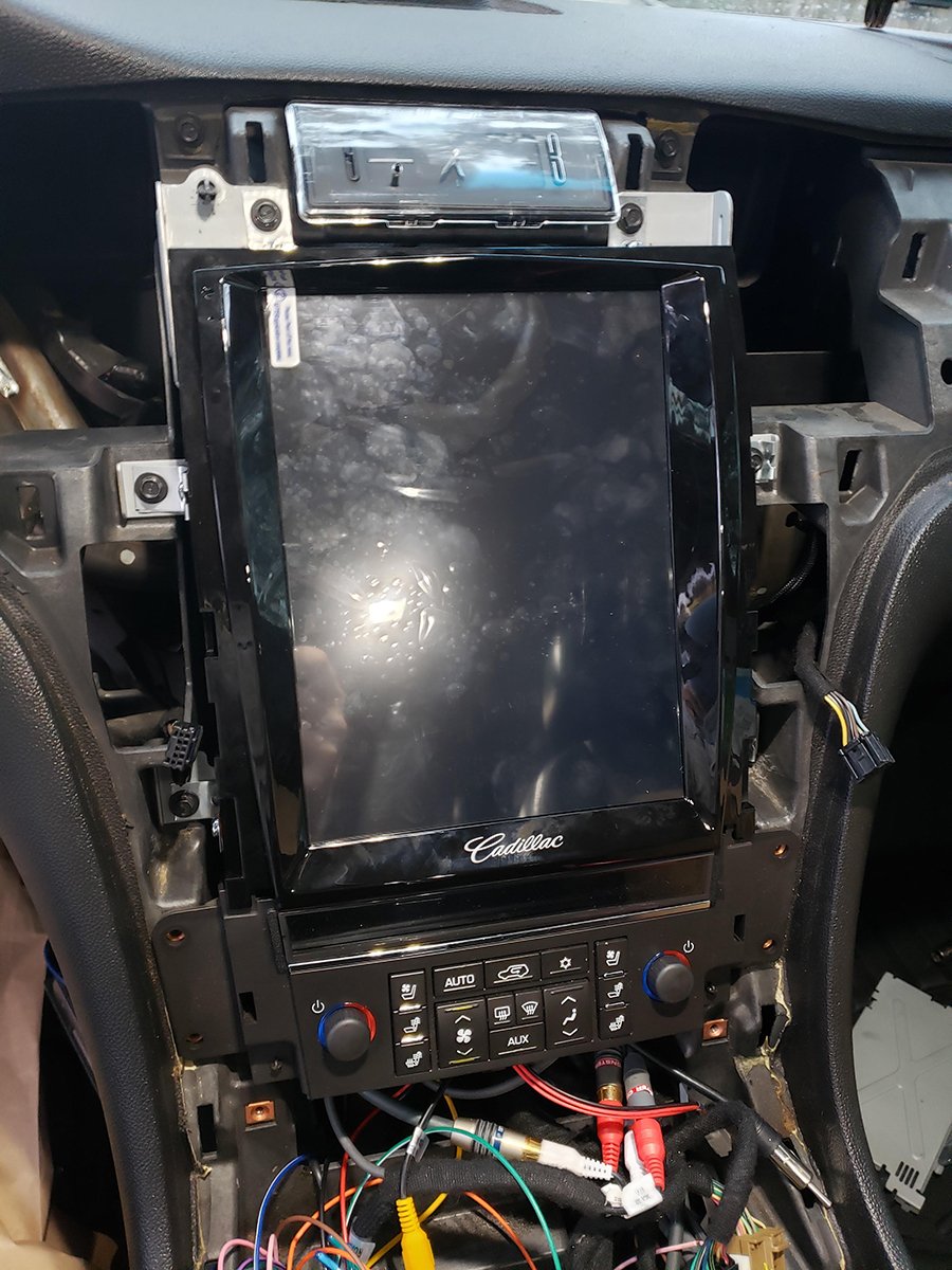

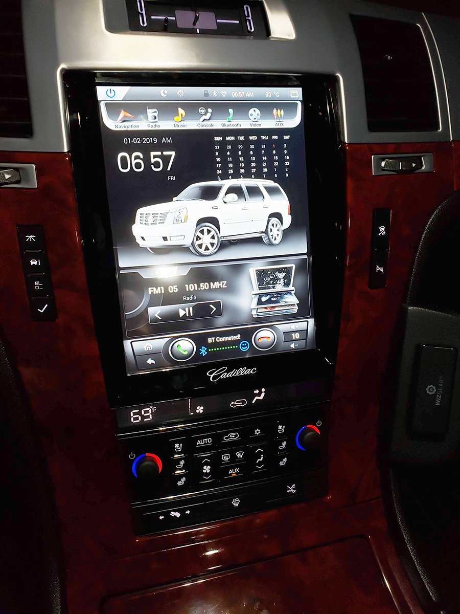

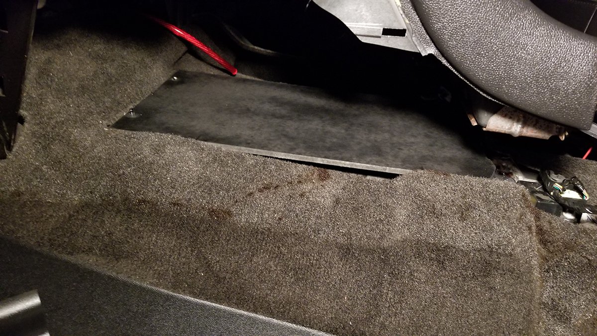

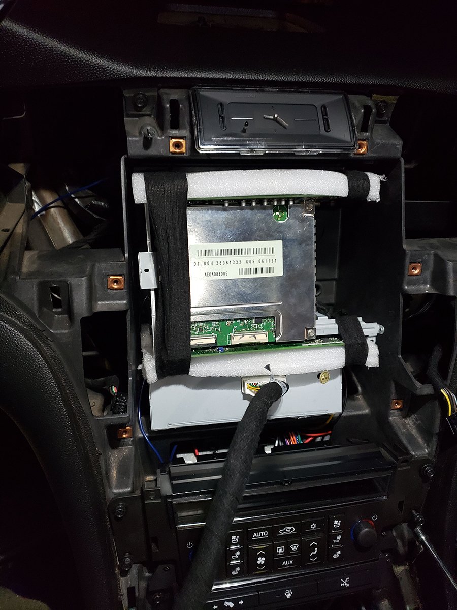

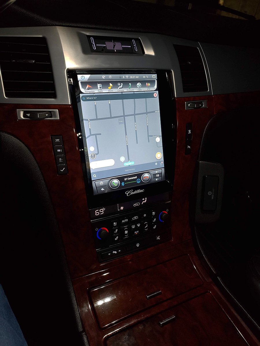

The Install of the 10.4" Vertical Screen Tesla 1024*768 Android Car DVD GPS Navigation Radio RAM 2GB 4 Core was a little more difficult than I was hoping. I don't think the brackets for the one that I bought were designed to fit an Escalade like the description indicated. I found another listing that popped up shortly after mine arrived that had brackets that looked like they were the right ones. So I had to come up with some jankity brackets that would work. You also have to cannibalize your stock stereo since it works in conjunction with the Android unit. I eventually got it to fit properly and look good, but it was a PIA. And most of the instructions were written in broken english. It is a pretty cool unit though and looks awesome. If anyone is looking into getting one, send me a PM and I'll try to steer you in the right direction.

Nice build I need to try that pin stripe removal on mine, has white vinyl pin strip covering a grey painted one lol

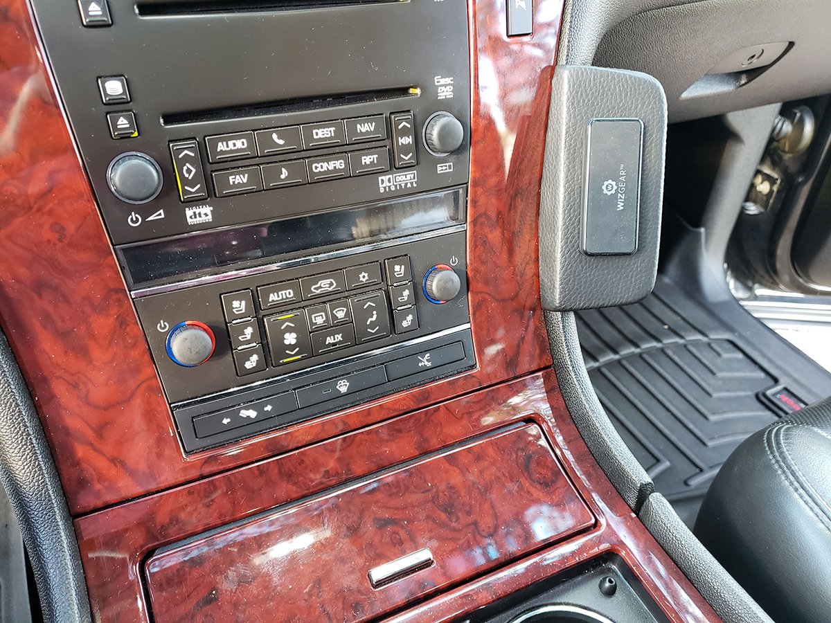

I've tried like 3 different phone mounts for this thing and best one that I have found so far is the Kuda Mount. I added a WizGear 10 magnet mount to it too. Looks great and works awesome.

Haha, yeah I was nervous AF to use the laquer thinner, but I watched some YouTube vids and read up a bunch on it first. It wasn't that bad really. And thanks, I can already tell this thing is gonna cost me a crapload with all the mods I have planned.

Came out great. I'd love to do this to my nbs.

Nice change out to the Esky. Yes, better dig deep for the mod monies. Audio install looks great and nice pin stripe delete. Interested to see how you move forward. Guess it's time to add to your sig pic now. :thumbsup:

One of the coolest interior mods I've ever seen
Well thanks man! I wish I could take more credit for it, but really it's those guys in China that designed the sucker. I kinda wish it was more of a semi-matte finish to match the rest of the control panels, but overall I dig it.
Maybe instead of semi-matte you could wrap it or paint it to match the wood grain?
