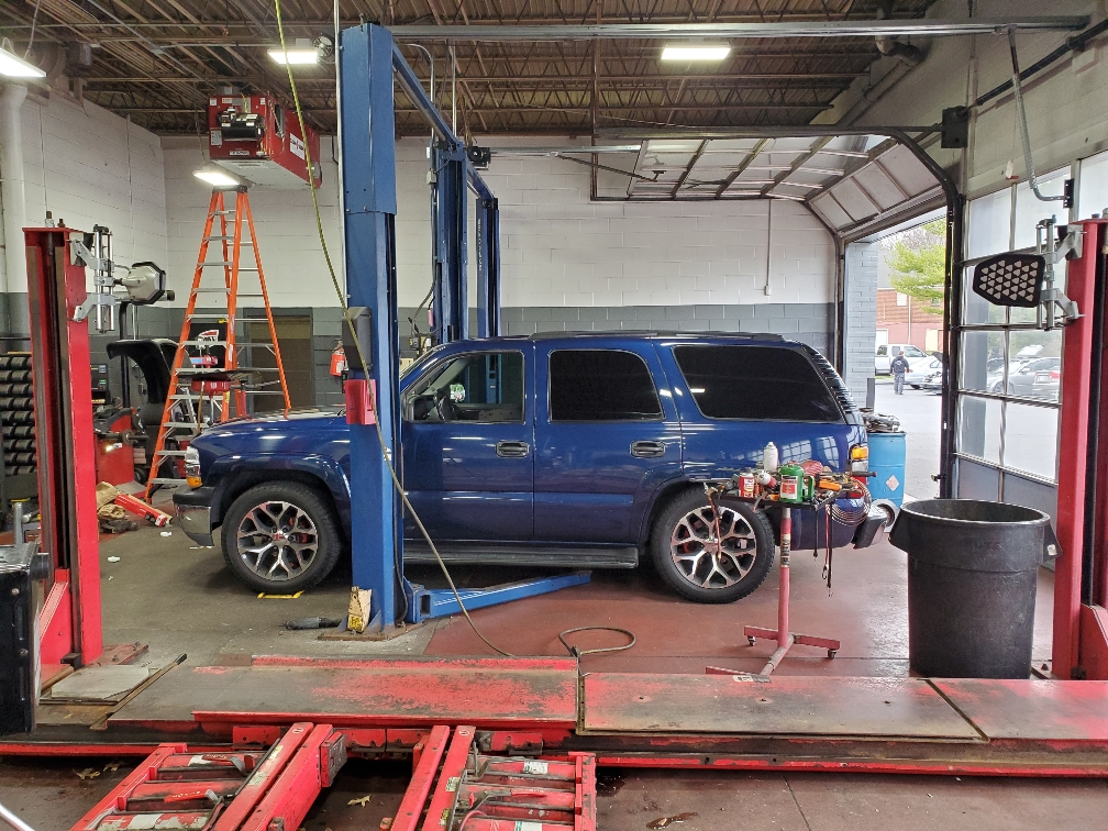

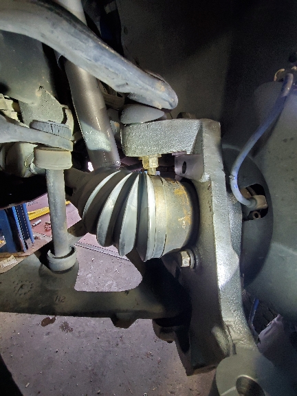

You can see in this pic how close it is to the axle.
Sent from my SM-G973U using Tapatalk
Looks like it's right on top of the axle.
ThwopKing
Apr 26, 2010
319
36
Bunker Hill, WV
Nevermind figured it out lol. But we didn't install the pucks in back. Will most definitely have to lol. Im not into squatting....

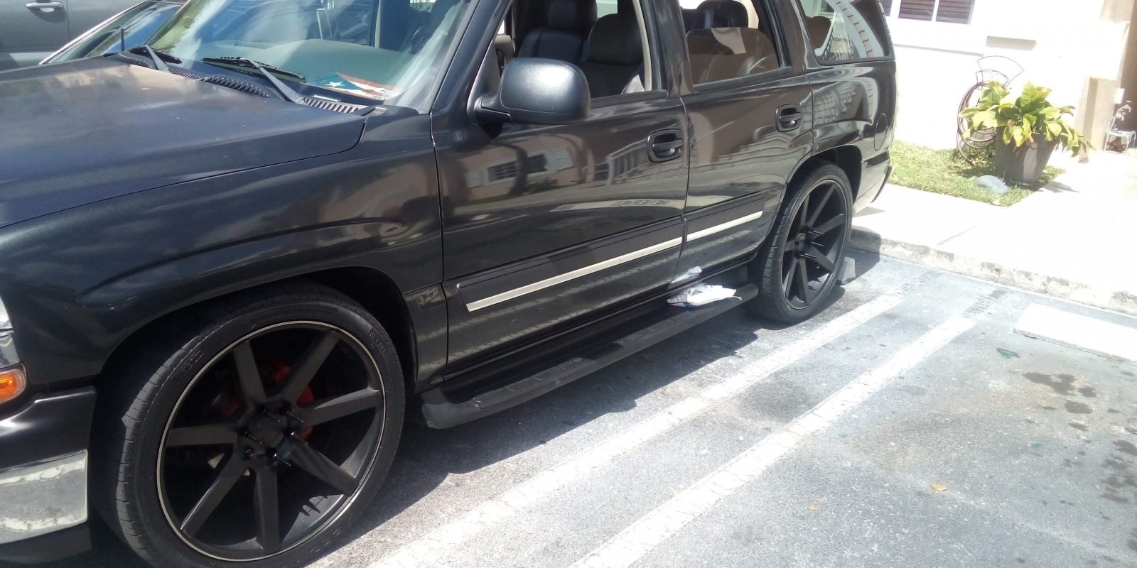

got a 04 tahoe
2inch drop spindles
torsion keys lower a little
3inch lower springs
and belltech lowered shocks
new front and back sway bushings
has dubs 24 inch with spike lugs
pzero 305/35/24
rides good but when i hit bout 70 or so it has a wobble and i notice that my front driver side sit a little lower than passenger side . cam that be the wobble issue ? other than that it run

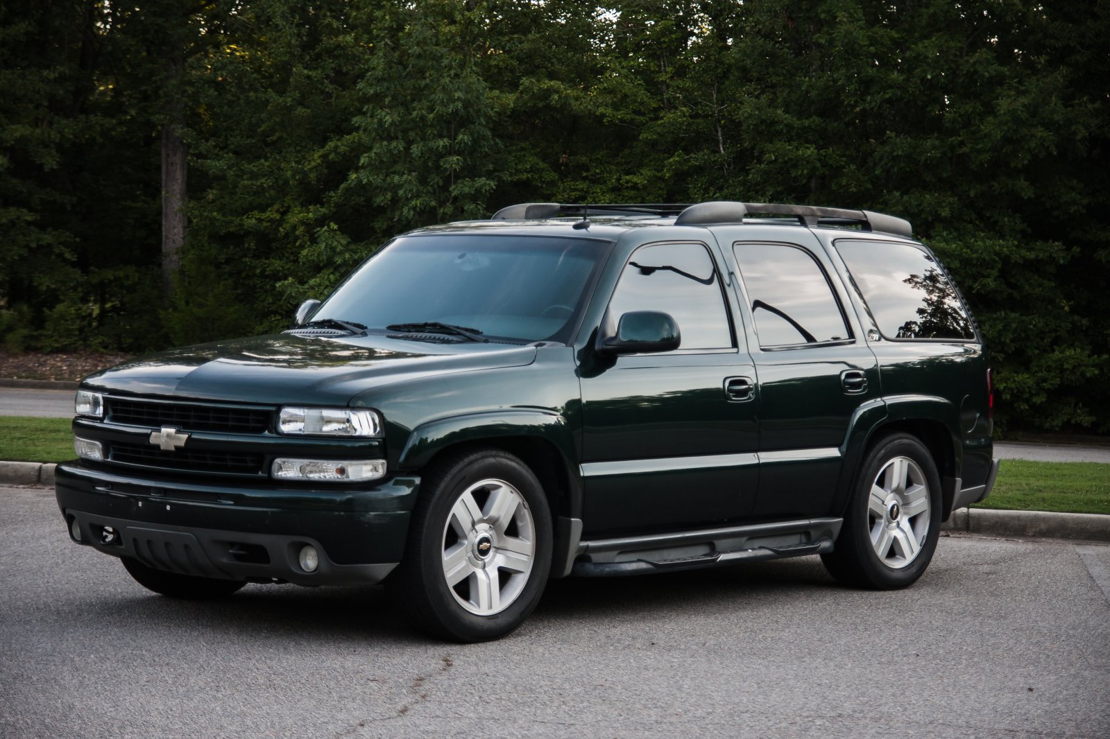

Model/Year/2x/4x/AWD:
- 2003 Tahoe Z71 4x4
Advertised drop:
- Not sure/2"
Fender height front/rear:
-34.5" Front / 34" Rear
Front:
- LCA's : Stock
- UCA's : Stock
- Spindles : Stock
- Sway Bar : Stock
- Tie Rods : Stock
- T-bars : Stock
- T-bar keys : Stock decranked
- Shocks : Belltech Street Performance
- Steering : Stock
Rear:
- UTA : Stock
- LTA : Stock
- Springs : Crown 2" Drop Coils
- Panhard : Stock
- Sway Bar : Stock
- Air Assist : None
- Free Travel Mod: Yes
Wheels & Tires:
- Wheels : OEM Texas 20's
- Tires : Cheapo 275/55/20
Considered upgrades:
- 2" MCG/BT drop spindles and 3-4" drop coils for more low. Pictures make it have too much fender gap lol
- Helper bags in the rear
Brief impressions of setup:
Overall, the ride is firm but not stiff. For me, it's low, but not too low to where I have to worry about scraping. It's a great daily height.

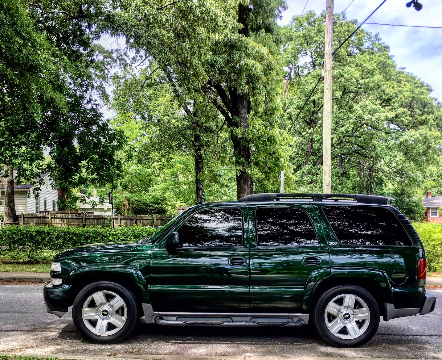

Advertised drop:
- Belltech 2/4
-33" Front / 33" Rear
Front:
- LCA's : Stock
- UCA's : Stock
- Spindles : Belltech 759
- Sway Bar : Stock
- Tie Rods : Moog
- T-bars : Stock
- Steering : Stock
Rear:
- UTA : Stock
- LTA : Stock
- Springs : Belltech 759 4" (not using the 1" spacer)
- Panhard : Spohn Performance Adjustable
- Sway Bar : Stock
- Air Assist : Airlift Helper Bags (Model 60769)
Wheels & Tires:
- MAYBE upgraded sway bars, happy with ride for now.
Haven't had a chance to really put it in turns, but handles great. Firm, responsive suspension cycling.

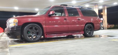

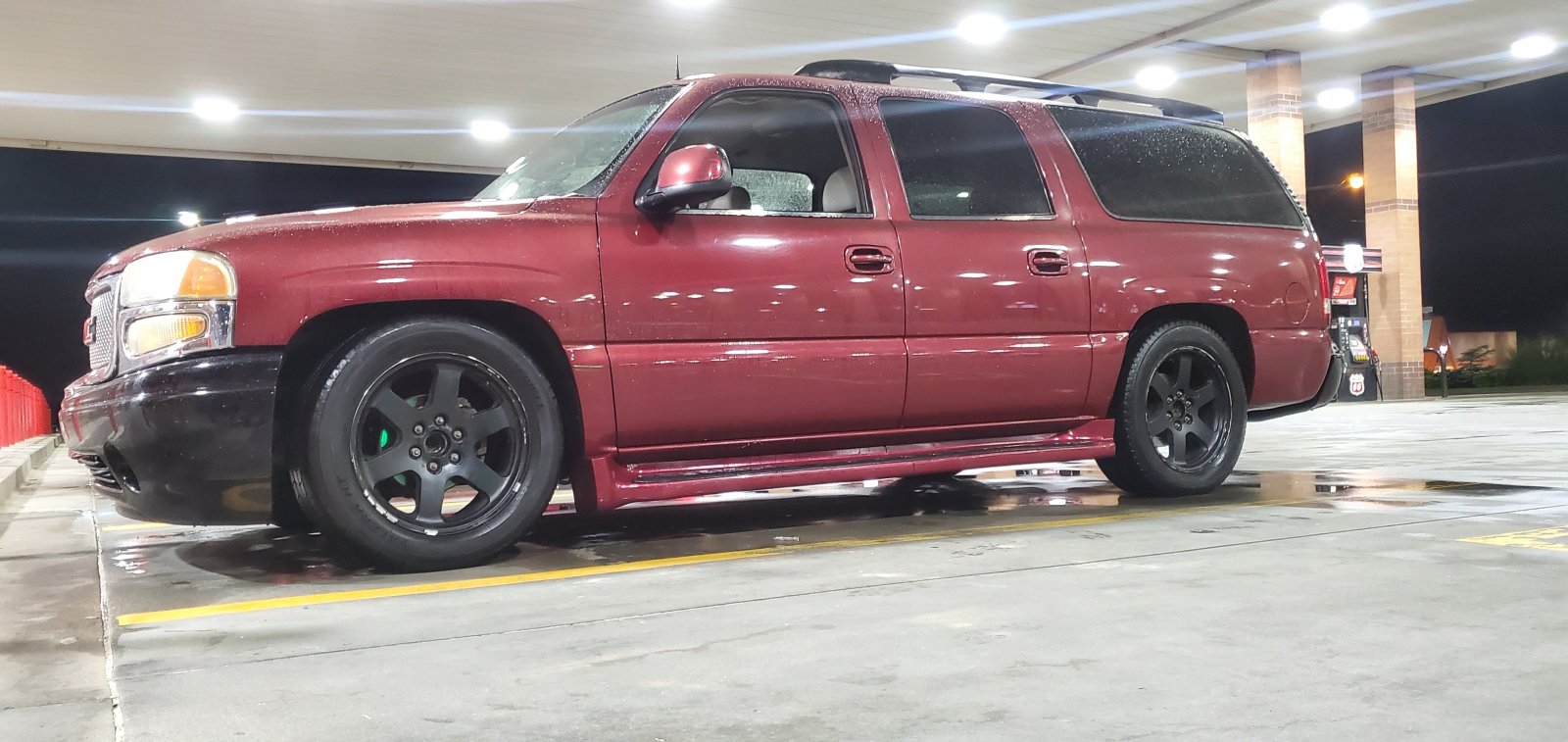

- 2002 Yukon XL
Advertised drop:
- 3"/4"
-31.75/33.5
Front:
- LCA's : Stock
- UCA's : Stock
- Spindles : Stock
- Sway Bar : Stock
- Tie Rods : Stock
- T-bars : Stock
- T-bar keys : Crown Suspension
- Steering : Stock
Rear:
- UTA : Stock
- LTA : Stock
- Springs : Crown Suspension
- Panhard : Stock
- Sway Bar : Stock
- Shocks : BellTech Street Performance
- Air Assist : None
Wheels & Tires:
- Wheels : 20" GMC Declads
- Tires : Cheap 275/55r20s
-Just ordered Belltech 2508 Spindles, new Lower Ball Joints, Moog Offset UCAs, and Tie-Rod ends. Also ordered @tonynoralss rear kit to drop another 1.5". Putting Stock keys back in and decranking a little.
Right now the truck rides stiff as hell. But little to no body roll which is a plus. Hopefully when all other upgrades are installed itll ride better and align correctly
