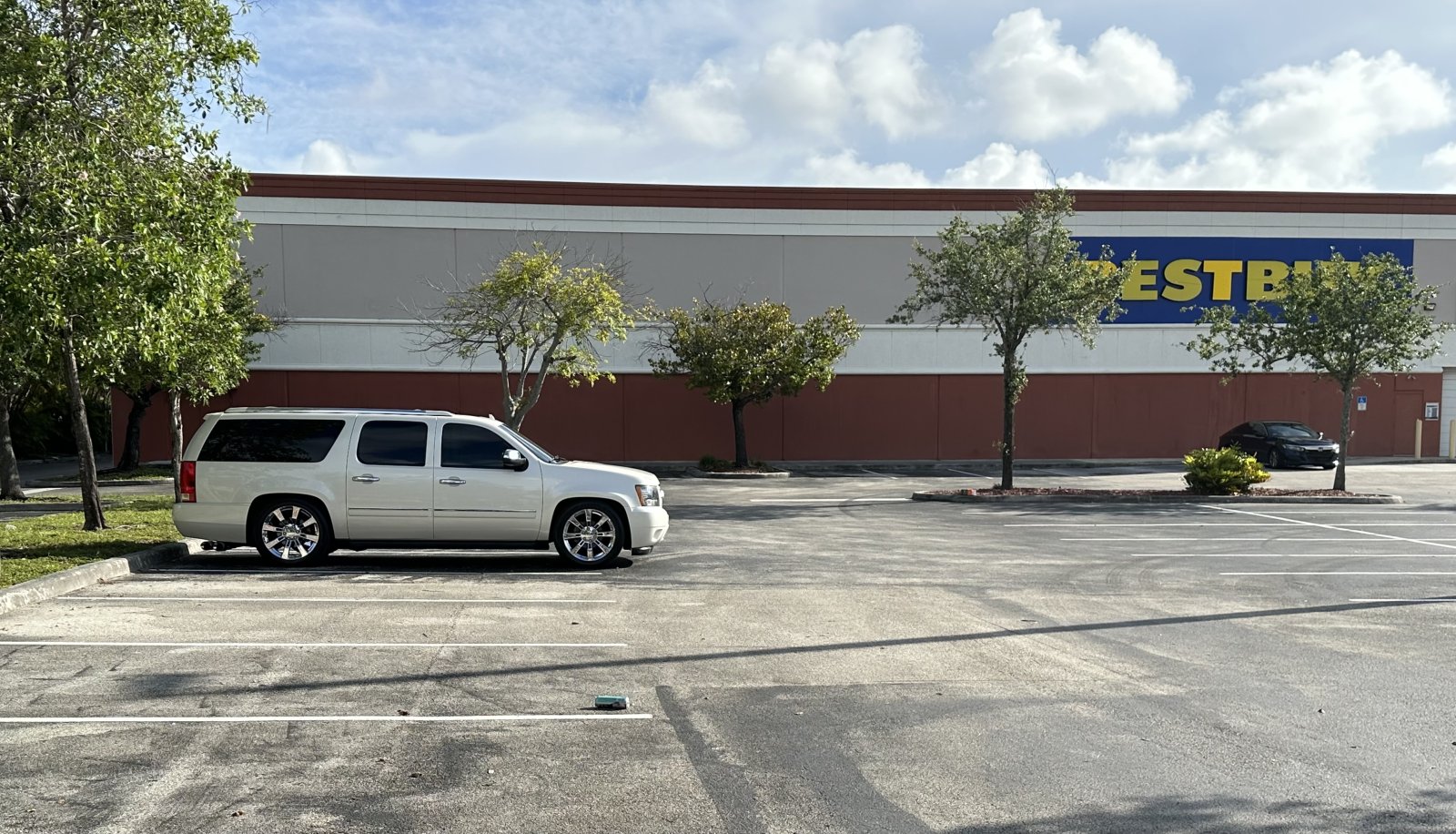

Currently sitting around 35” ground to fender lip. Maybe a touch higher in the rear, but mostly leveled. 285/45/22 tires and CK375 reps with +31 offset.

I have the mcgaughys 2'' spindles. And i did the strut flip with a 1/2 spacer. i'm at 32" fender to ground, and my alignment is within spec.

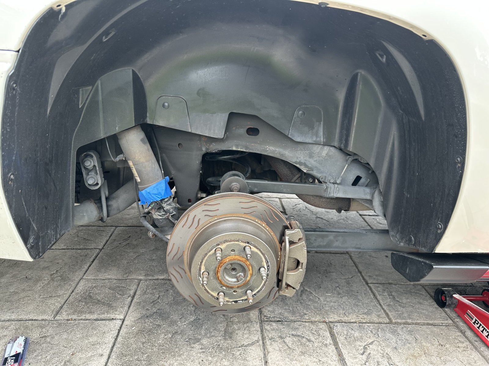

Had some fun with the Burb.
Steam cleaned the carpets and they look so much more fresh. That was some nasty brown water. There was a coffee stain under the 3rd row and since they were out to go to Orlando and we had our friends machine, I just did the entire truck while I was at it.
Got the wife motivated to do the couch, which took her a couple hours over two days. I told her to keep going over it and over it again. Between dogs and people, it was time. Much better now.
Lubed the door hinges with some Boeshield T-9 lubricant.
Cleaned the engine bay and just need to dress it.

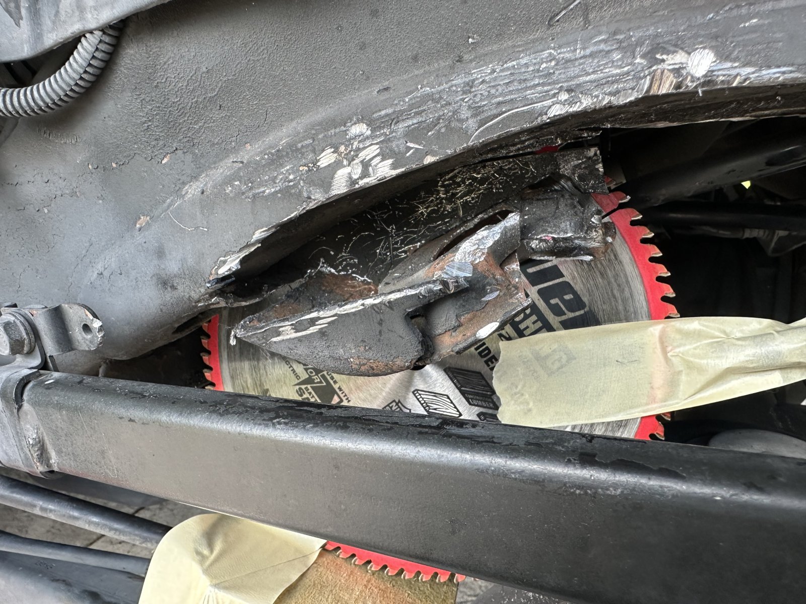

I also did the free travel mod. Burned thru some grinding discs, bent a few sawzall blades, destroyed a sawzall, had to go buy another at HF, but did not hit the gas tank (check out my piece of metal to protect the tank lol...worked perfectly). Thankfully I started with the driver's side as I was so cautious with the gas tank on the first day. Took me way too long, but was being very careful with the brake lines, ABS sensor, springs and gas tank. You can see the driver's side bracket was removed in pieces and the passenger side went very quickly comparatively and came out in one piece.
The finished product after grinding/sanding with the flapper disc and hit it with some spray paint was "real nice" Clark!
Touched up the calipers and drums too, just didn't get a photo. No comments needed on the raggy OEM shocks. Fuse has been pulled for ages, so air ride is off, but the shocks are working fine. Managed to forget to put the ABS sensor plugs back in before I installed the tires on both sides. Duh! Had to reach thru the wheels to get them pushed back into place. All else is running as it should be.:secret:
Did a 400 mile return journey on the same day to Orlando with the wife to collect our son’s dorm belongings. Had a little early 2000's country playing the entire road trip. We reminisced over many albums and concerts we had been to over the years together. It was a fun road trip.
The long body did 421 miles at 17.4 mpg averaging around 72mph and with city driving to UCF and home. $5.00/gallon 89 octane.
