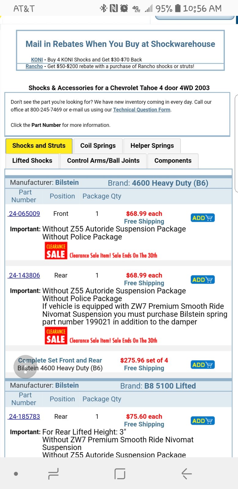

I just noticed the 4600's say heavy duty. Idk if that would make a too harsh of a ride.

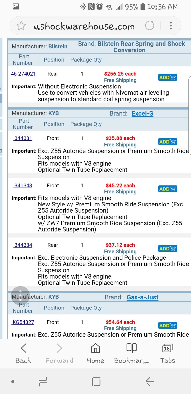

These are the ones I have. I got rid of the ZW7 crap.
