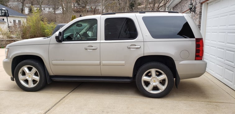

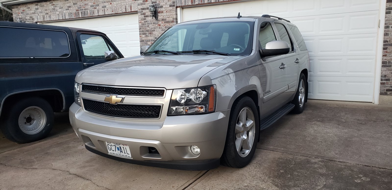

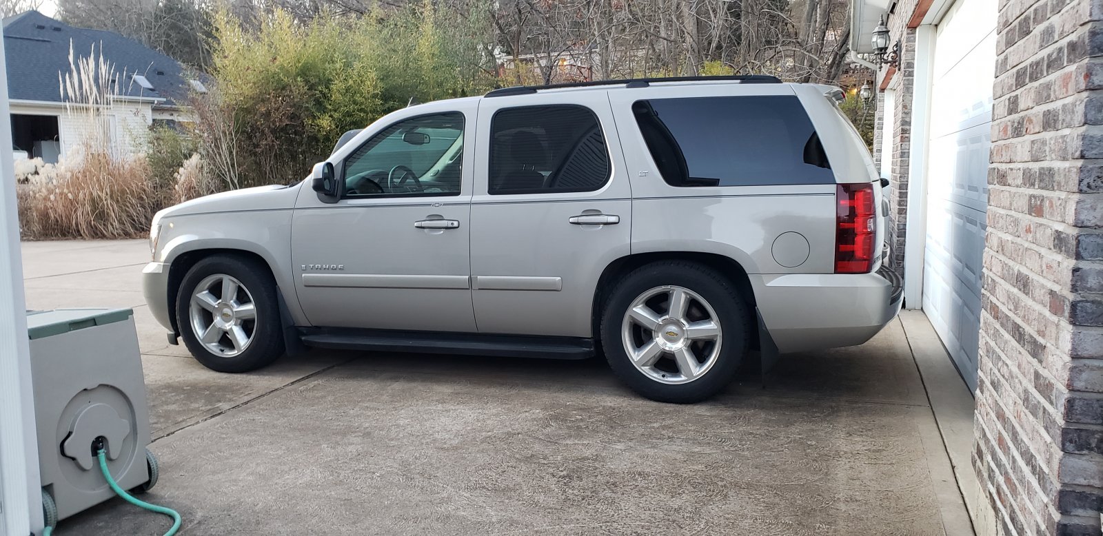

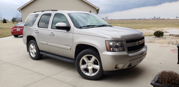

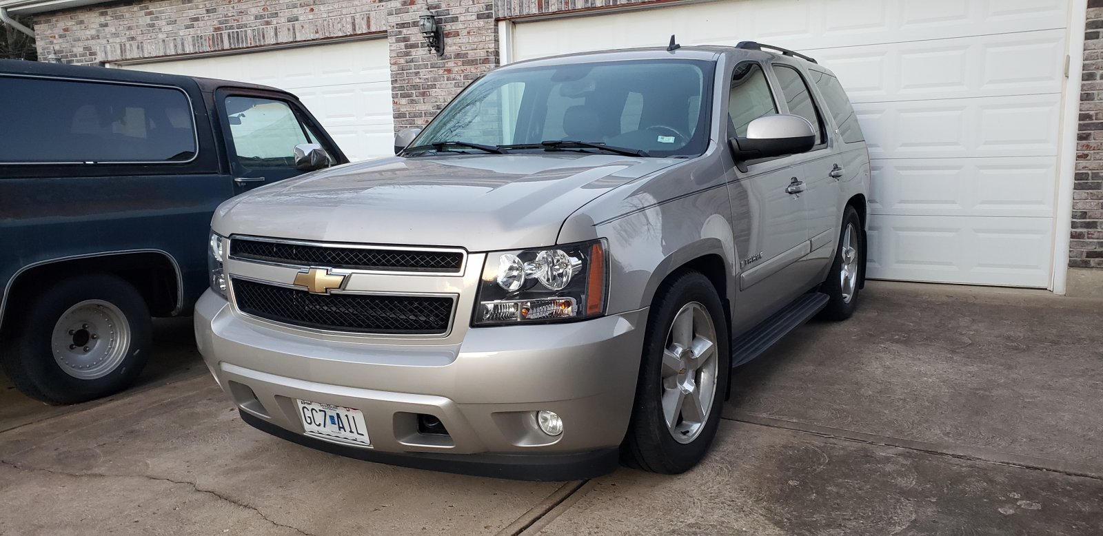

Finished the lowering on my 2008 Tahoe, mostly....
I used the Belltech 2511 spindles, and Belltech 25003 struts with stock springs up front.
I also replaced the upper arms and adjuster bolts and cams, lower joints, outter rod ends , hub bearings, and axle shafts.
The lower arm bushings and sway bar links looked good, so they stayed.
Out back I used the Belltech 4230 Trailblazer springs, Belltech 2410FF shocks, DJM RK2007 relocation and shock extension kit, and Air Lift 60748 helper bag kit. I just grabbed a new short poly bump stop off Amazon.
Since everything on the front was replaced, I just ballparked the alignment till I goes to the shop for a proper setup.
Actually got it pretty close, mabey a little camber on the passenger side that looks like it will adjust out.
I was expecting to get a 4/6 F/R drop out of this setup, but actually ended up with around 3/4 F/R as measured.
Overall, it's acceptable and rides really nice without any rubbing or bottoming out.
I did do the free travel mod.
Only one issue concerning Me.

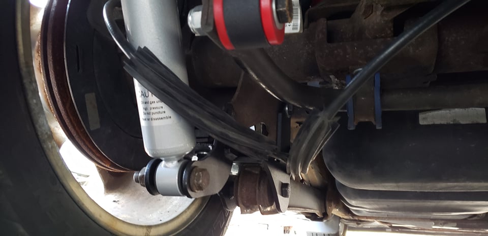

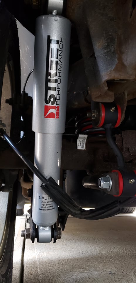

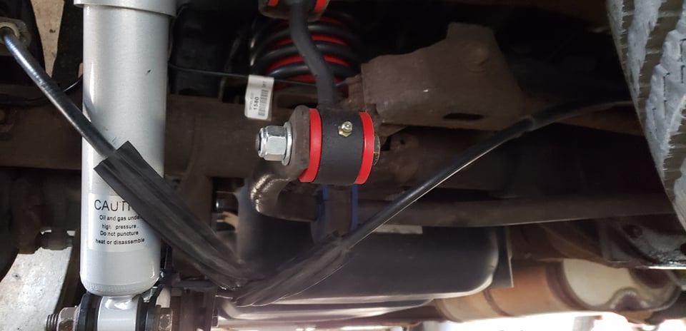

At the drivers rear, it seems like the emergency brake cables are getting slightly tensioned with the new shock placement.
I've removed the factory wire retainer off the frame, which freed it up just a bit, but I still think it's under tension pulling the brake on that side.
I can hear the pads chafing as I roll. I haven't looked to see if that sides cable is adjustable, to add a little slack.
Any ideas on that cable, or has this been experienced before??
Other than this one issue, I'm really pleased with the drop.
Here's before and after pics.

Nice! Similar stance as my '08.
Did you re-route the brake cables ABOVE the sway bar?
Found this pic in my build thread:
The cables rub the shocks, but they're not being pulled.

Thanks for that picture.
The routing remained the same as factory.
I don't believe the passenger cable is an issue, as there's enough slack.
It's the driver's side getting tensioned behind the shock, similar to your photo.
But mine is tighter than "just rubbing".
I need to find time to get back under there and look around for some adjustment.
I'm not driving it until after the alignment later this week.
I did find an older thread that suggested zip-tieing the cable to the shock extender.
Hopefully, that will make that cable arc more to the rear and give Me some room.

My cable housing rubs tf out of the drivers side rear shock. There has been zero rerouting. It's not ideal.
I didn't see a pic of the cable in your situation, but it would need to have something fairly drastically wrong to start tensioning the ACTUAL cable inside the housing enough to pull the pads. I mean, right? Even with my shock extenders, which move the shock more back than down, the cable has enough slack to bow out, look terrible, rub my shock to the point of wearing through, and still not pull the pads...you're going to need to show us what your working with back there lol

Here's what I have with the wire cable retainer removed.
This is on the ground loaded.
I understand what you're saying.
With this being a jacketed cable, there shouldn't be any increased internal cable tension.
I'll pull that side apart and see if there isn't just a pin or pad hanging up.
That looks completely fine, and you have more slack than I do on the brake cable. There is definitely something else going on. Time to dig into those calipers! Also it could be somewhere else in the line, so wouldn't hurt to check the run.
