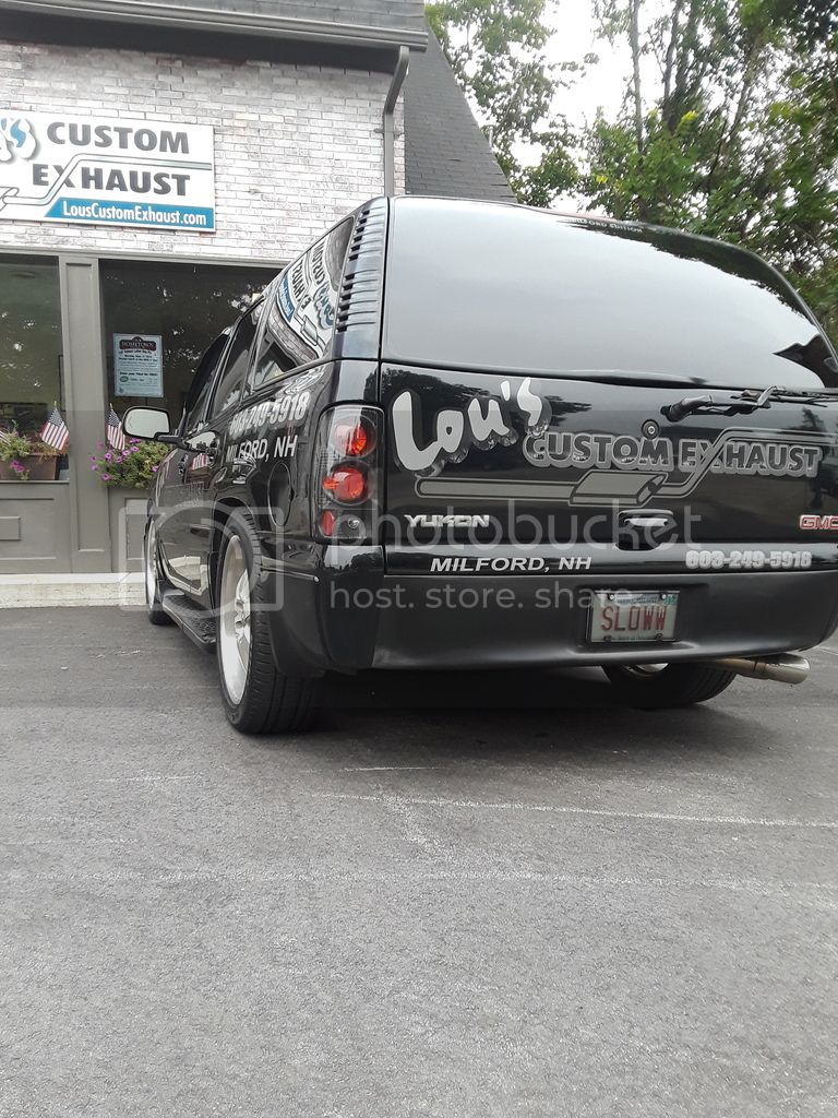

Model/Year/2x/4x/AWD:
- 2003 GMC Yukon Denali
Advertised drop:
- 3"/4"
Front:
2" Maxtrac Drop Spindles
Keys (Not installed)
Rear:
4" Maxtrac Drop Springs
NorcalSS End Links
Wheels & Tires:
- Wheels : 22" Boss 330 wheels
- Tires 305/40R22
Sits 33" From ground to Fender above tire.

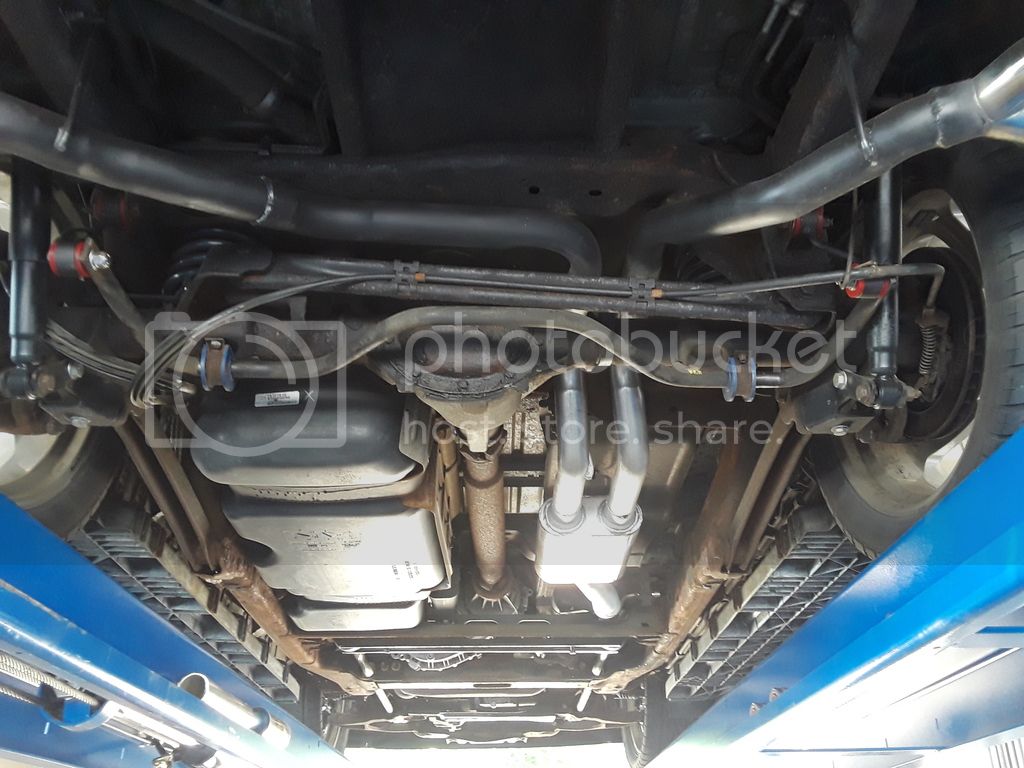

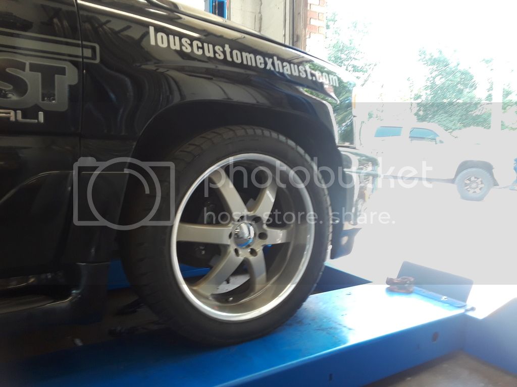

20180712_143610_zpsisqds6kn.jpg.html
20180712_150400_zpsgigmckp4.jpg.html
Will most likely have to redo the tailpipes, shoudn't be too hard lol
Better pictures once i get it out and let everything settle. I cut the factory bumpstops for now. Will do the free travel mod this weekend after work.

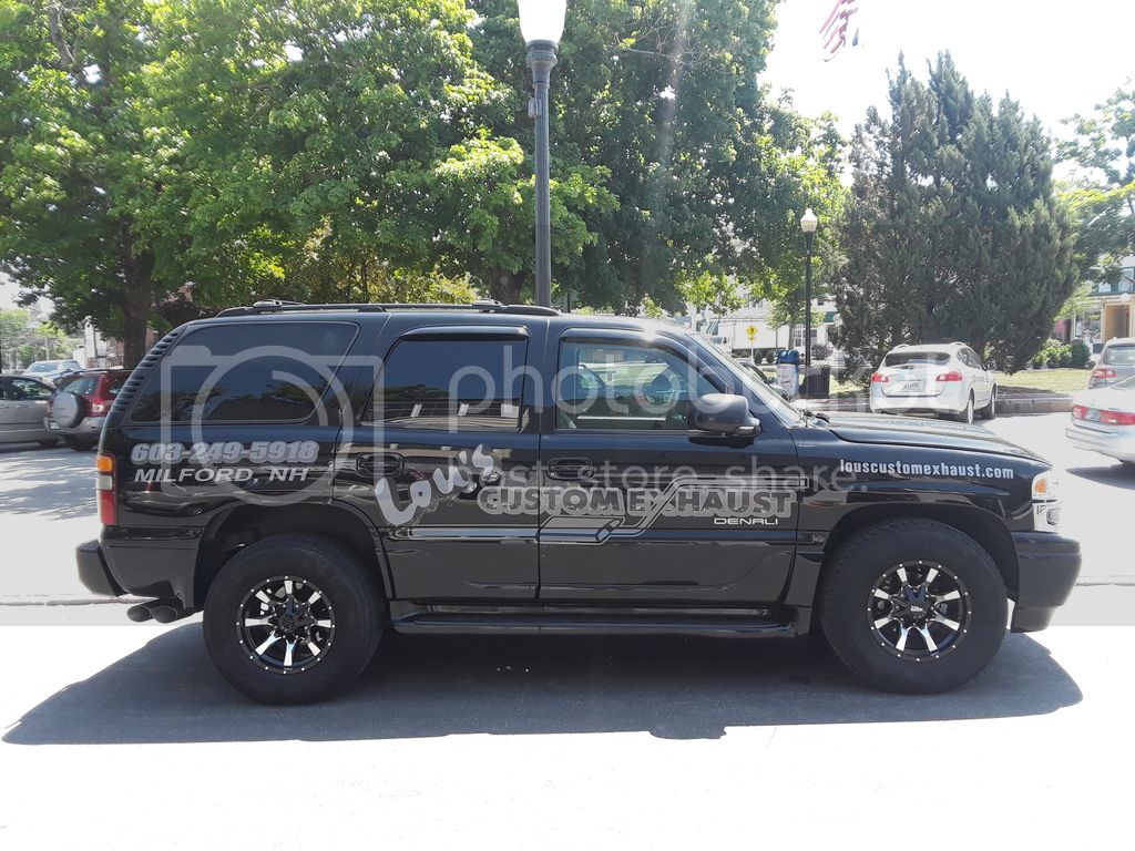

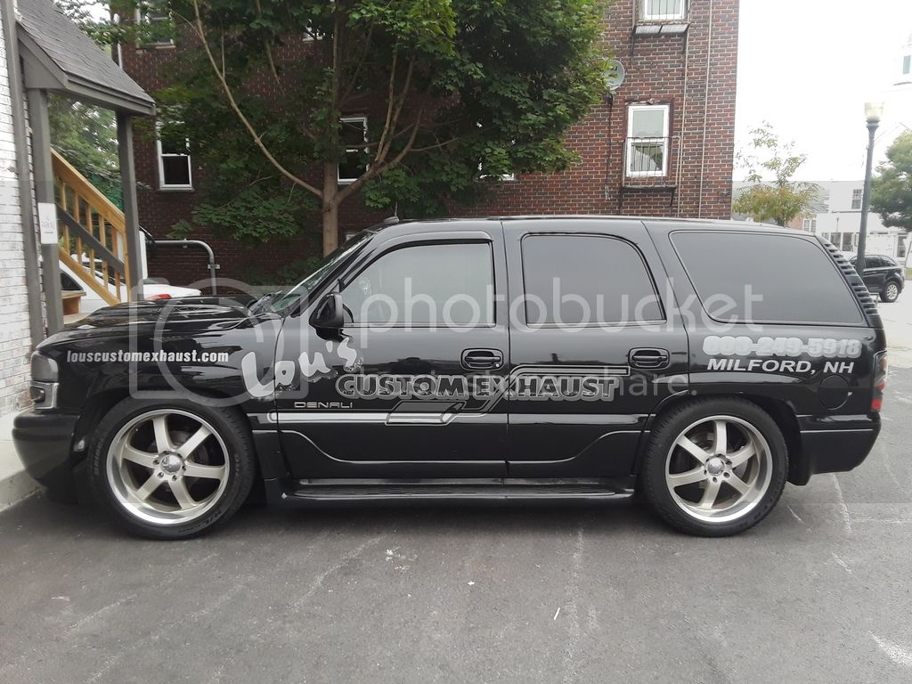

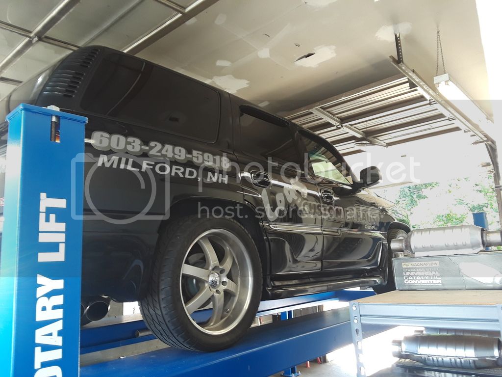

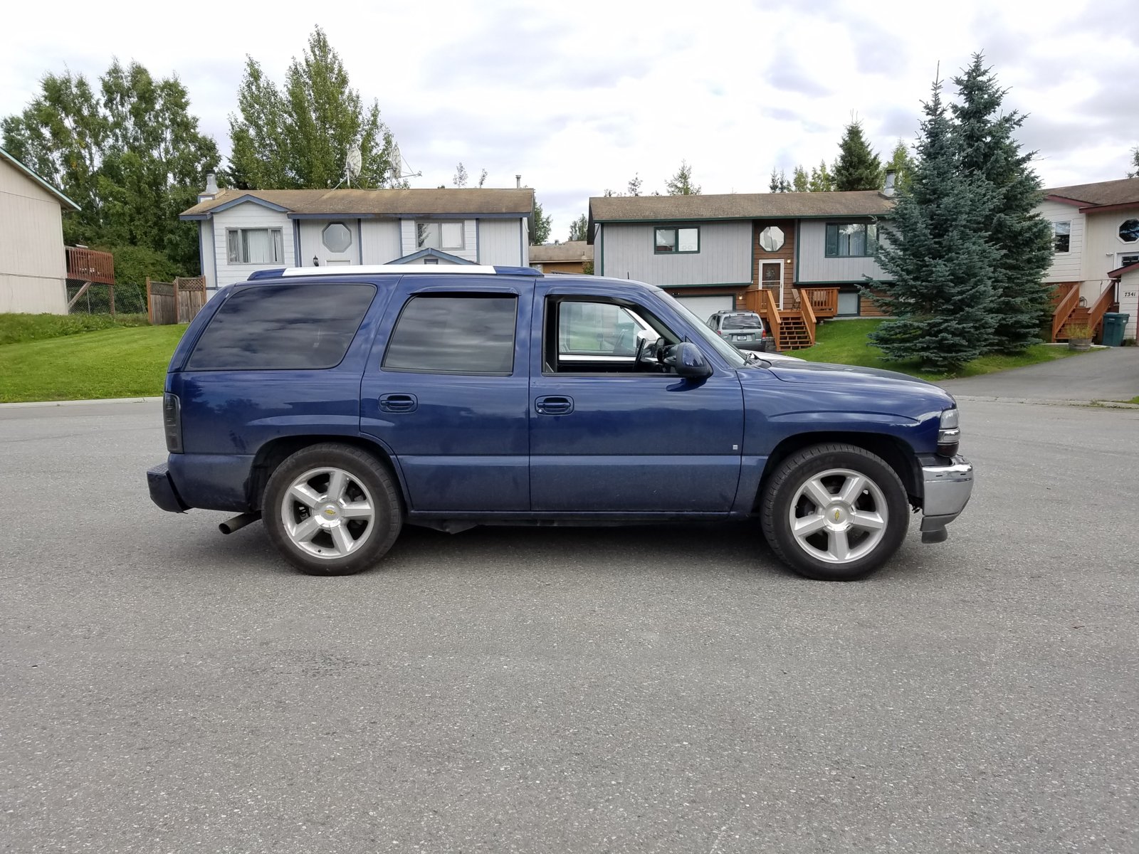

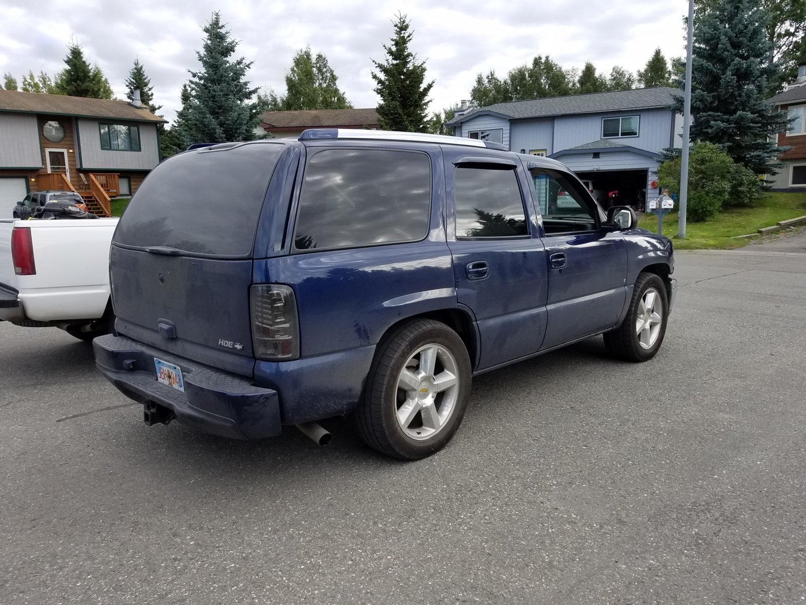

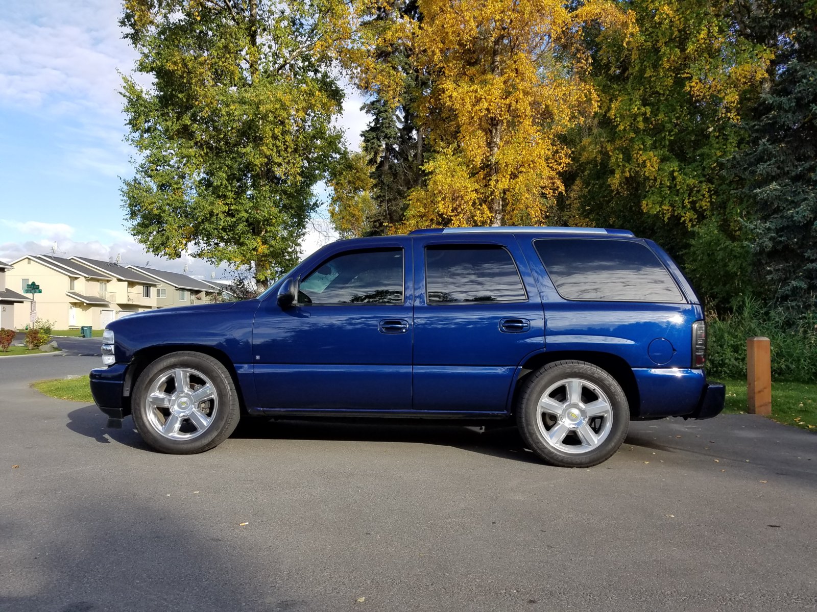

Finally Done with the Drop.
Advertised drop:
- 3"/4"
Front:
1-3" Mcaughys keys
Rear:
4" Maxtrac Drop Springs (1 and a half coils cut)
NorcalSS End Links
Poly Bushings for Panhard bar and Upper and lower control arms
Free Travel Mod
Wheels & Tires:
- Tires 285/45R22
Sits 32" From ground to Fender above tire front and rear.
Before the lowering kit, roll pan, and wheels
After
All thats left is to just add the Spohn Panhard, uppers and lowers. I can finally close this chapter and start working on getting the rollpan and front bumper painted.

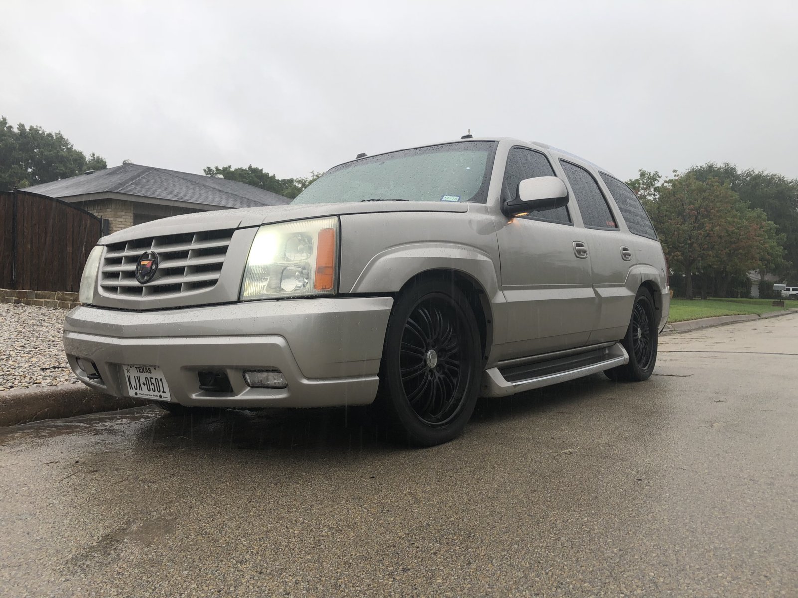

- 2004 Cadillac Escalade awd
Advertised drop:
- 4/6
Front:
3” DJM upper/ lower a arms
3” Eibach drop keys cranked up
Rear:
6” NorcalSS rear springs
DJM drop brackets shock extenders sway bar end links
Spohn adjustable pan hard bar
Spohn adjustable rear control arms
(Not installed)
Free Travel Mod
Wheels & Tires:
- Wheels : 22" OEM Escalade wheels
- Tires 285/40R22 Nitto 420s
904B6AC7-1A41-46E2-BC14-03E458A377C1.jpeg BC45E368-B3CA-446C-8046-17F60F78276E.jpeg 89FB2F49-0BE9-4D7C-9C64-F34B6D9A935A.jpeg 0BD997E4-1F77-42D4-AF1B-5AC604393A5F.jpeg

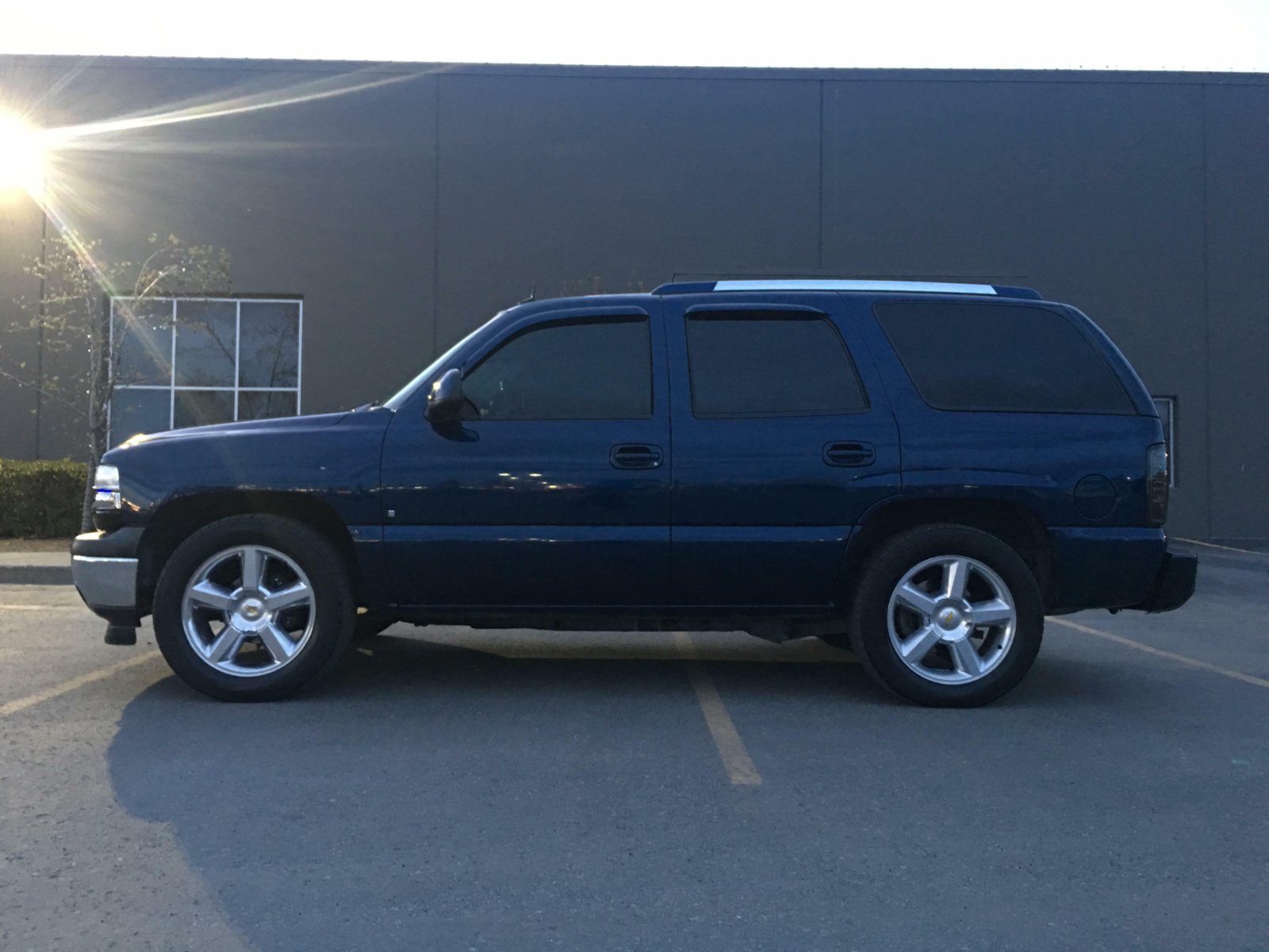

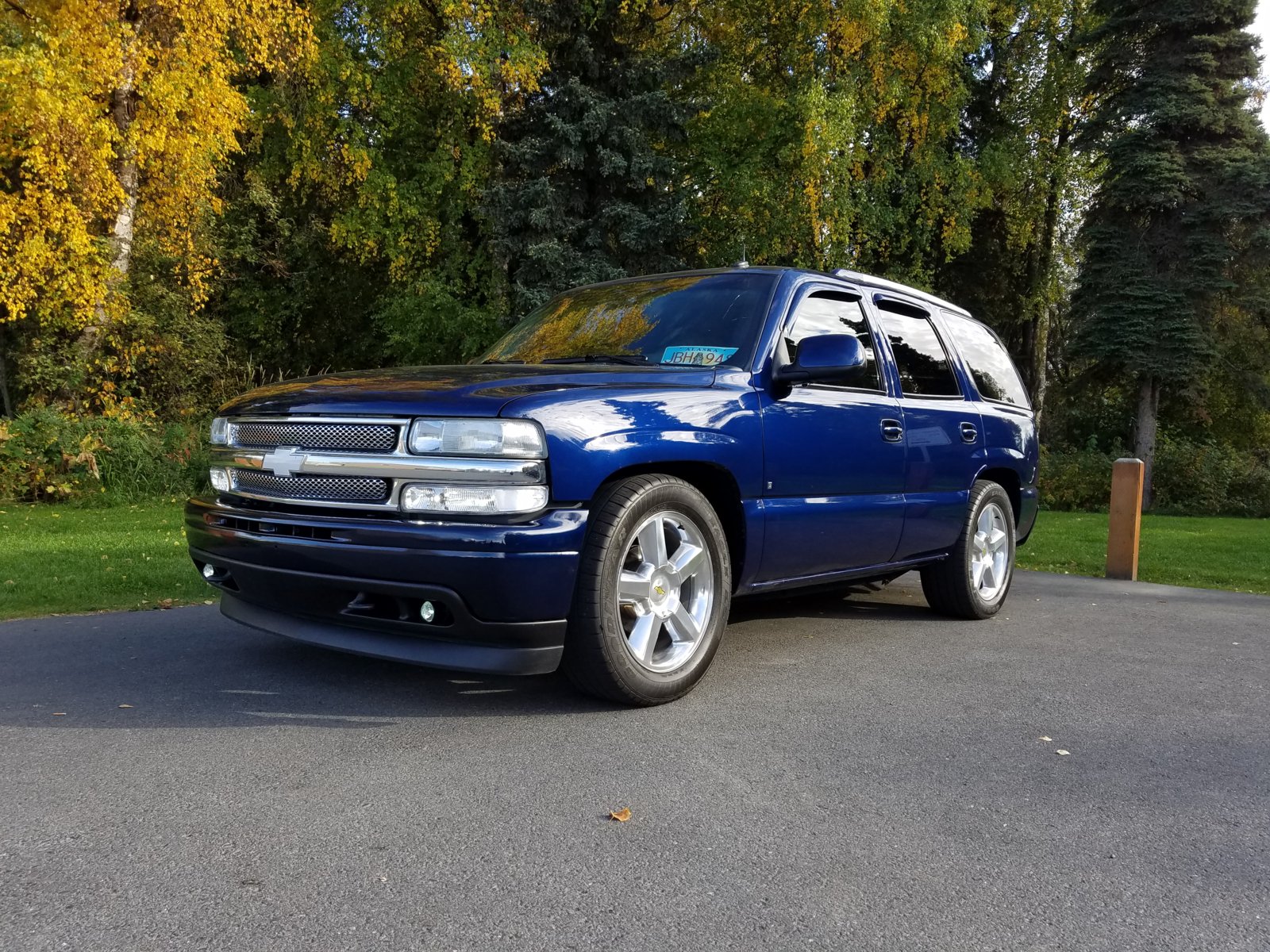

- 2003 Tahoe LT 4x
Advertised drop:
- 0"/4"
Fender height front/rear:
-34.25/33.50
Front:
- LCA's : stock
- UCA's : stock
- T-bar keys : stock turned all the way down
Rear:
- Springs : Crown 4" springs
- DJM shocks extenders
Wheels & Tires:
- Wheels : 20x9 oem tahoe ltz
- Tires : Goodyear Eagle LS-2 275/55/20
- Autoride disabled
Considered upgrades: drop keys duh
Brief impressions of setup:
Definately feel and notice the cali-lean lol

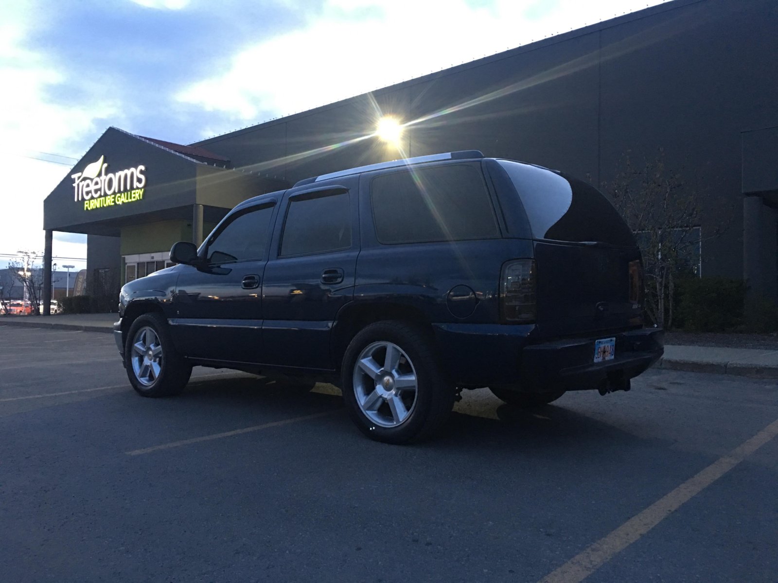

Before:
After:

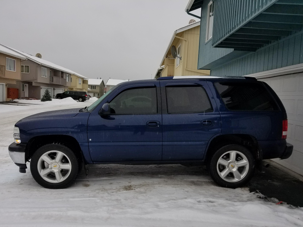

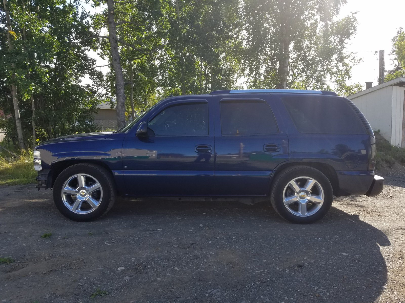

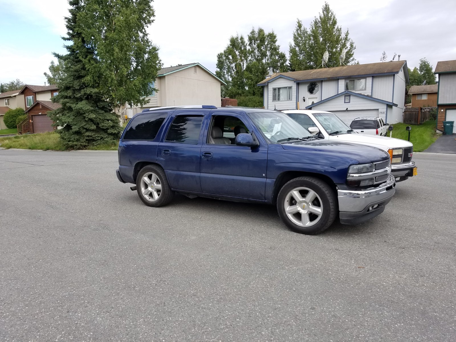

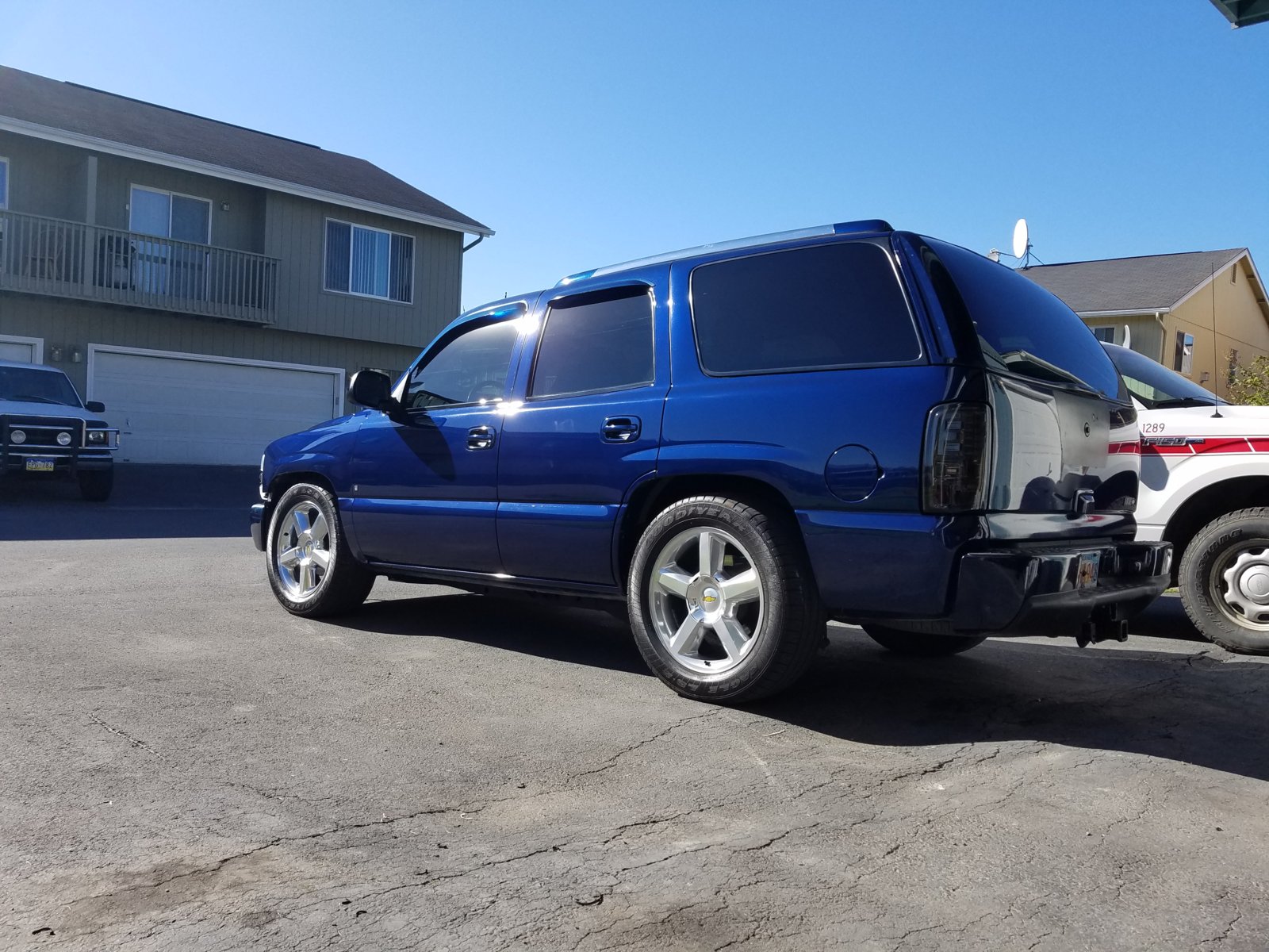

- 2003 Tahoe LT 4x
Advertised drop:
- 2"/4"
-32.25/33.50
Front:
- LCA's : stock
- UCA's : stock
- T-bar keys : 2/3" McGaughy's keys
Rear:
Wheels & Tires:
- Autoride disabled
Considered upgrades: spindles
Feeling bumps more than before. Stocks need to be replaced tho. More sway and roll, but not in a "dangerous" manner. Suspension has settled, hate to do it but need to raise font one inch to match the rear ar 33.5"

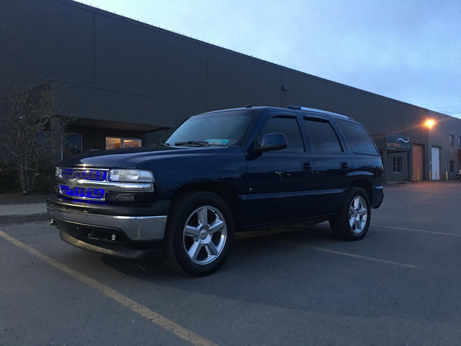

- 2003 Tahoe LT 4x
Advertised drop:
- 2"/4"
-32.25/33.50
Front:
- LCA's : stock
- UCA's : stock
Rear:
Wheels & Tires:
- Autoride disabled
Feeling bumps more than before. Stocks need to be replaced tho. More sway and roll, but not in a "dangerous" manner. Suspension has settled, hate to do it but need to raise font one inch to match the rear ar 33.5"View attachment 208267 View attachment 208268 View attachment 208266 View attachment 208269
You gonna do the control arms and panhard also? Your rear wheels look just like mine
05Single
afraid of the dark
Feb 26, 2015
8,244
11,648
I wasnt till you pointed yours out lol. Now I'm giving it serious thought. I know majority never take it that far but it's the right way to do it.
Bombsquad85
Aug 18, 2016
1,515
1,556
Northern VA
Yea I can't justify the price of the arms right now so I'm gonna put my 1" spacer back in
