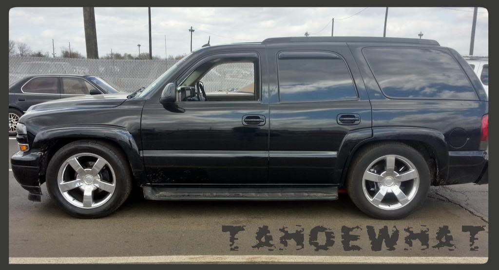

So I got this thing pretty cheap a year ago. Had 192k but was a grand cheaper and 10 times cleaner than any Tahoe or Yukon in a 75 mile radius of me. I immediately lowered it on the cheap, knowing I'd "clean it up" in the future. Present day is the future.
So I've had rear BellTech SP to replace the blown rear stock air shocks. But was going to install them after I ordered the DJM end links & rear control arm relocation kit. I should have spent the $200 on this a year ago. That's all I left out when I dropped it. Or so I thought.
While trying to make sure my MaxTrac shock extension will fit with the DJM stuff, I discover the Spohn control arms. Which led me to the Spohn Panhard bar. Which might be a must to get rid of this things Chevy lean. Any thoughts from anyone?
Also, I'm attaching a pic of this thing. I guess I'm old as I like the 18's with the bigger tires. Both the look and the ride. Reminds me of high school. Heating and/or cutting springs on our mini's riding on stock wheels and tires. But I'm glad I went with MaxTrac. The springs are a little soft and barely settled any. With the apindles and keys de-cranked, they were just barely able to align it.

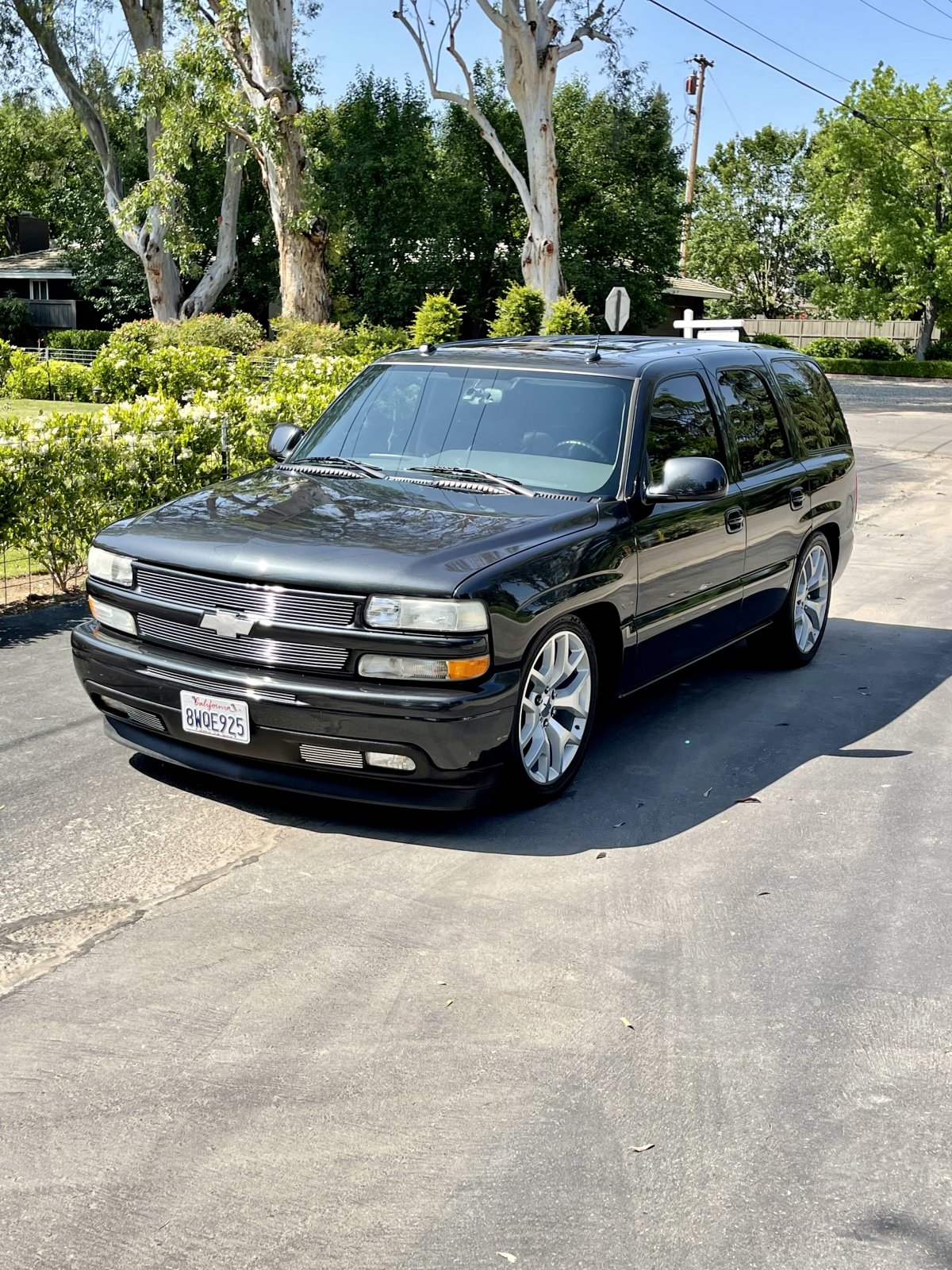

Figured I’d post. I never do and have been on here for like 11 years or something. I posted a couple weeks ago in exterior looking for help with headlights. Didn’t get much of a response. Long story short. The town I’m from has a bunch of aftermarket companies and I’ve gone to school and or have grown up with just about all (Whipple, McGaughy, Belltech, Speed Engineering, Full Throttle, Stone Fab, Western Chassis) to name a few. So me and my boys have been doing SEMA and show trucks since the 90’s. This Tahoe was bought new by me with the intention to make it a SEMA project. We ended up going a different direction and did a different new truck. So this Tahoe just sat for years. I let my buddies grandma drive it. It now has around just under 50k miles. I saw it sitting out at my shop and decided to start messing with it.
Model/Year/2x/4x/AWD:
- 2005 Tahoe LT
Advertised drop:
- low / Tony’s 6” springs
Fender height front/rear:
- have never measured
Front:
- LCA's : Custom tubular Stone Fab Coilover Kit
- UCA's : Custom tubular Stone Fab Coilover Kit
- Spindles : Stock
- Sway Bar : Belltech
- Tie Rods : Custom hiem joint Stone Fab Coilover Kit
- T-bars : None
- T-bar keys : None
- Shocks : QA1 double adjustable Coilover
- Steering : New center section, HD hooked to Hiems
Rear:
- UTA : Spohn Adjustable with Del-Sphere
- LTA : Spohn Adjustable with Del-Sphere
- Springs : NorCal 6”
- Panhard : Spohn Adjustable with Del-Sphere
- Sway Bar : Belltech along with the offset dog bones
- Shocks : QA1 dual adjustable
- Air Assist : None
Wheels & Tires:
- Wheels : 22" Snowflakes
- Tires : Nitto 275/40R22
Considered upgrades:
- Nope. I have billets floating everywhere in my shop. I’ve put so many sets on and for some reason keep going back to the wheels on it. Did a bunch of motor / performance. Building (2) 2 door 2wd right now so prob just mess with those and some of my other trucks.
Brief impressions of setup:
Great kit rides great. Never had any bumpsteer. Handles like on rails (for a brick).
I need to update the pics. Rear appliqué are SS smooth painted, the hatch is the other type with no handle or plastic on top and it has SS painted smooth wiper cowl. Still need help with headlights.

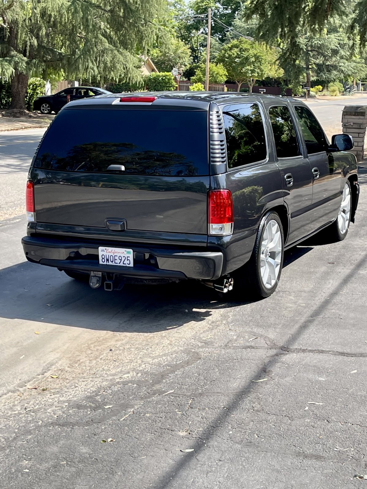

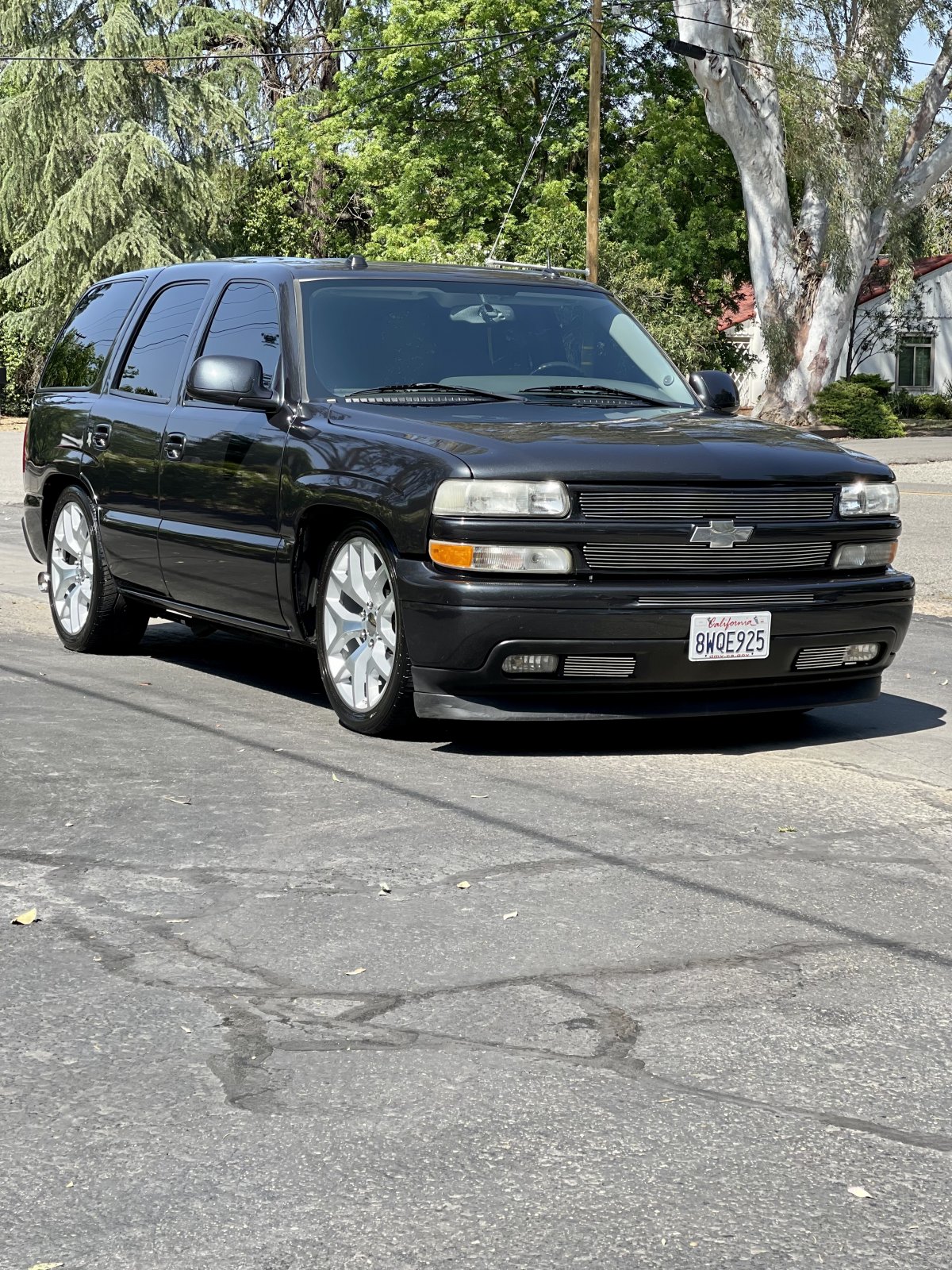

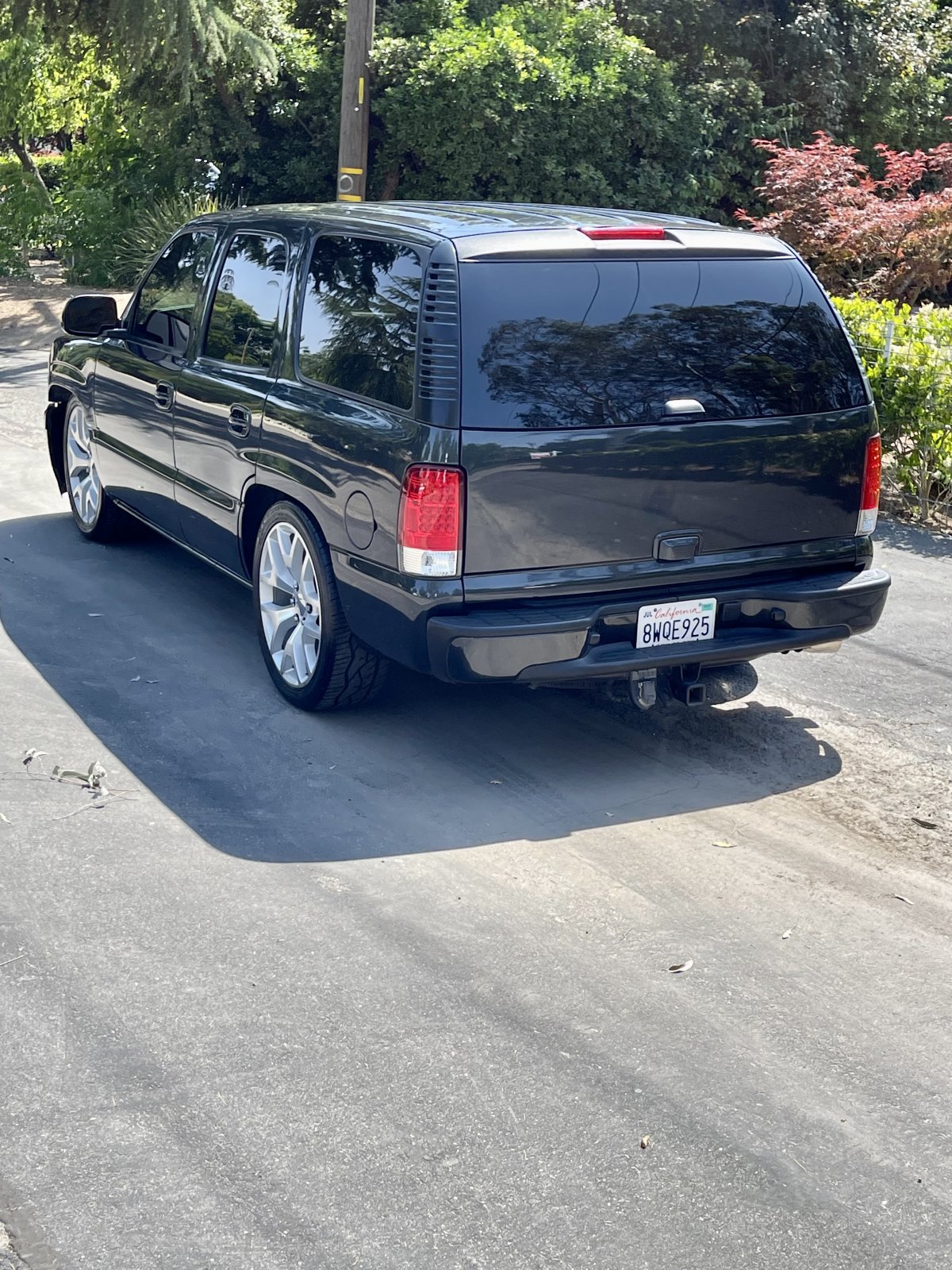

This is how my 2004 yukon is sitting on a 4/6 drop with lower control arms and 22s.
Michaelhdzz
Jul 4, 2023
11
18
I don’t have specific details on the brands cause I got it done by other people but it was a 4/6 from with 4inch drop spindle, 6inch rear spring, relocated arm bracket, but after I got that drop it started wobbling it at 50-55. So after the drop I got the inner and outer tie rods changed out with lower ball joints, two other parts were change but I forgot their names lol. I cranked up the torsion keys all the way so I could get out the most of the negative camber and that’s basically it.

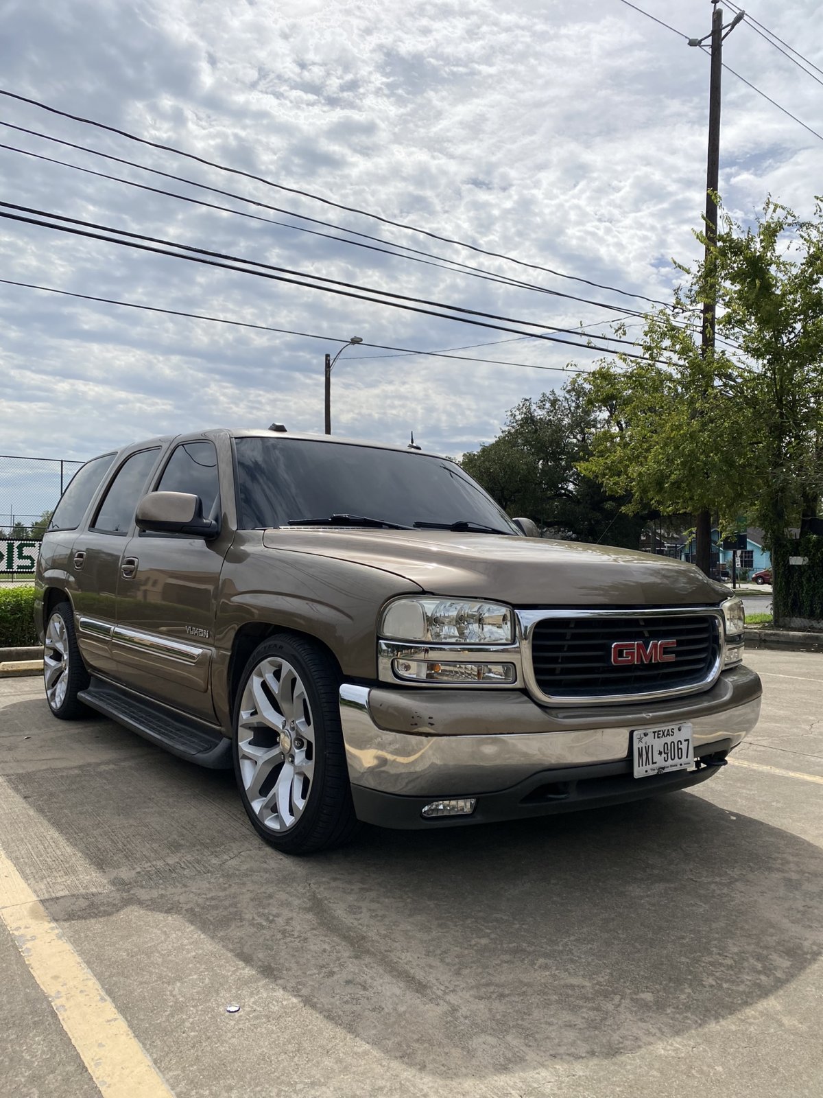

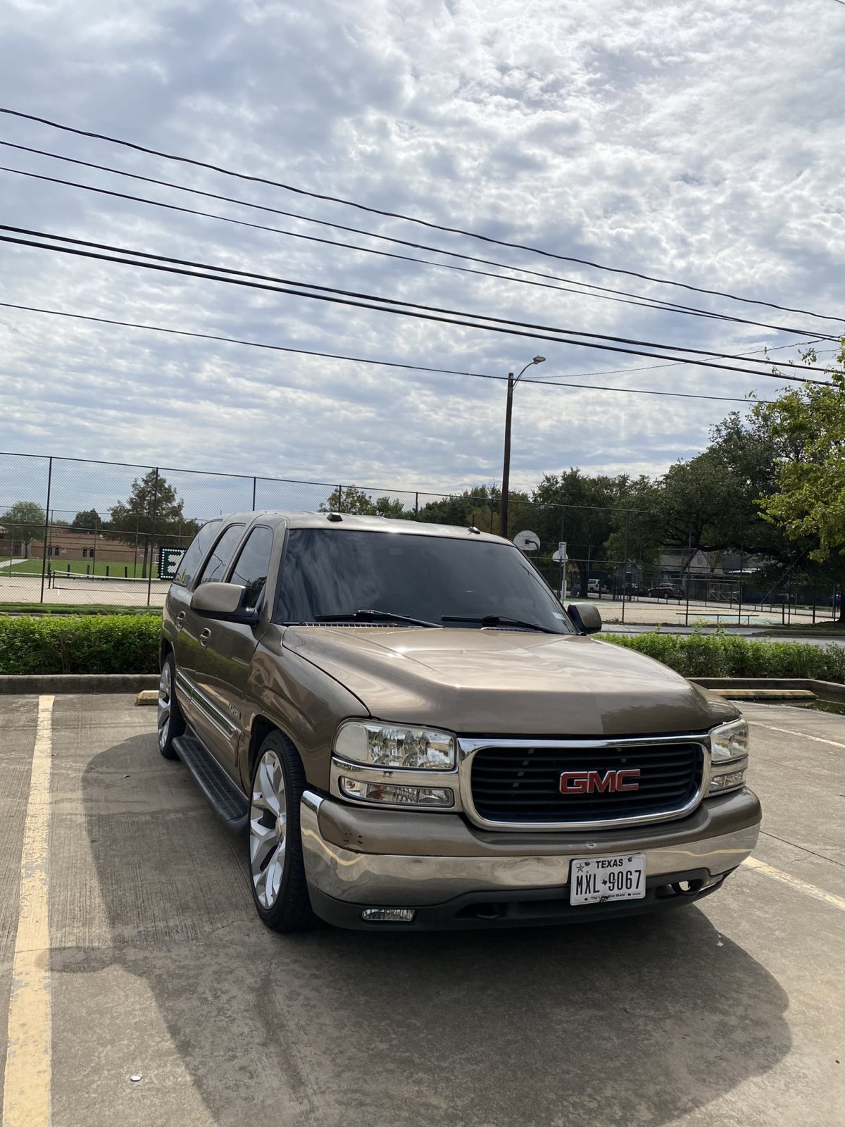

- 2005 Tahoe LT
Advertised drop:
- 3"/5"
-32.00/32.00
Front:
- LCA's : stock
- UCA's : stock
- Spindles : Mcgaughys 2" drop
- Sway Bar : Eibach
- T-bar keys : Gone
- Shocks :QA1 Coil Overs (custom brackets, etc) No more Tbars
Rear:
- UCA: Spohn adj.
- LCA: Spohn ajd. w/ Mcgaughys relocator kit w/ endlinks
- Springs : Beltech 5305
- Panhard : Spohn adjustable
- Sway Bar : Eibach
- Shocks : QA1 adj.
- Free Travel Mod - Yes
Wheels & Tires:
- Wheels : 20" GM SS chrome rims
- Tires : 285/50/20 Nitto420
Rides good for being lowered. Firm setup, but handles 100x better. (with old setup)
Please comment on the QA1 rear shocks.Are they single or dual adjustable? How does the ride compare to as new factory OE ride? What setting(s) do you have on rear shocks. Thanks!
