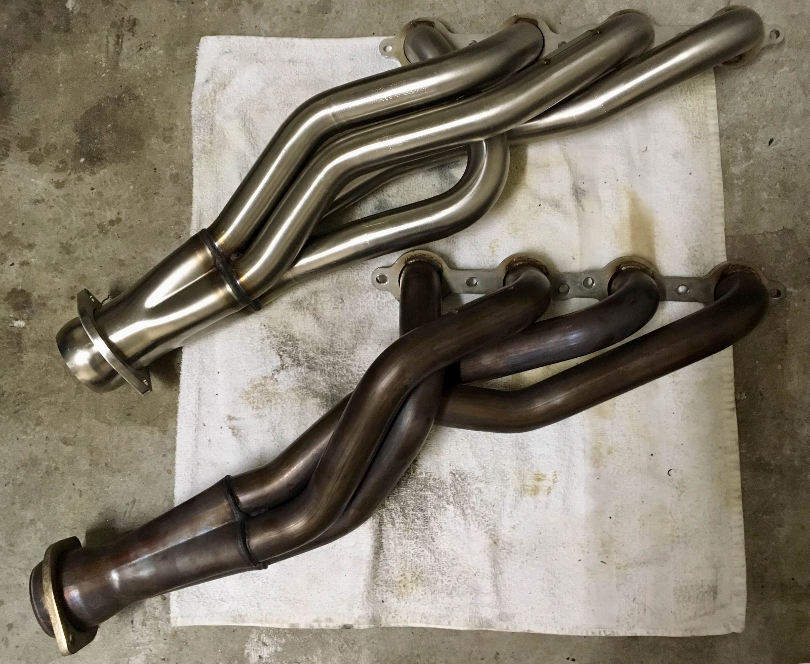

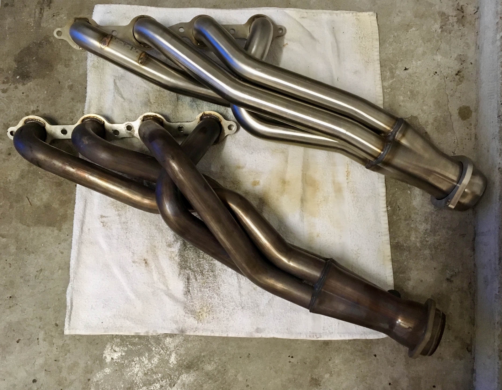

here are some side by side pics I took for comparison:
Top kooks 1 3/4" // Bottom ARH 1 3/4" (both for NNBS trucks and SUVs)

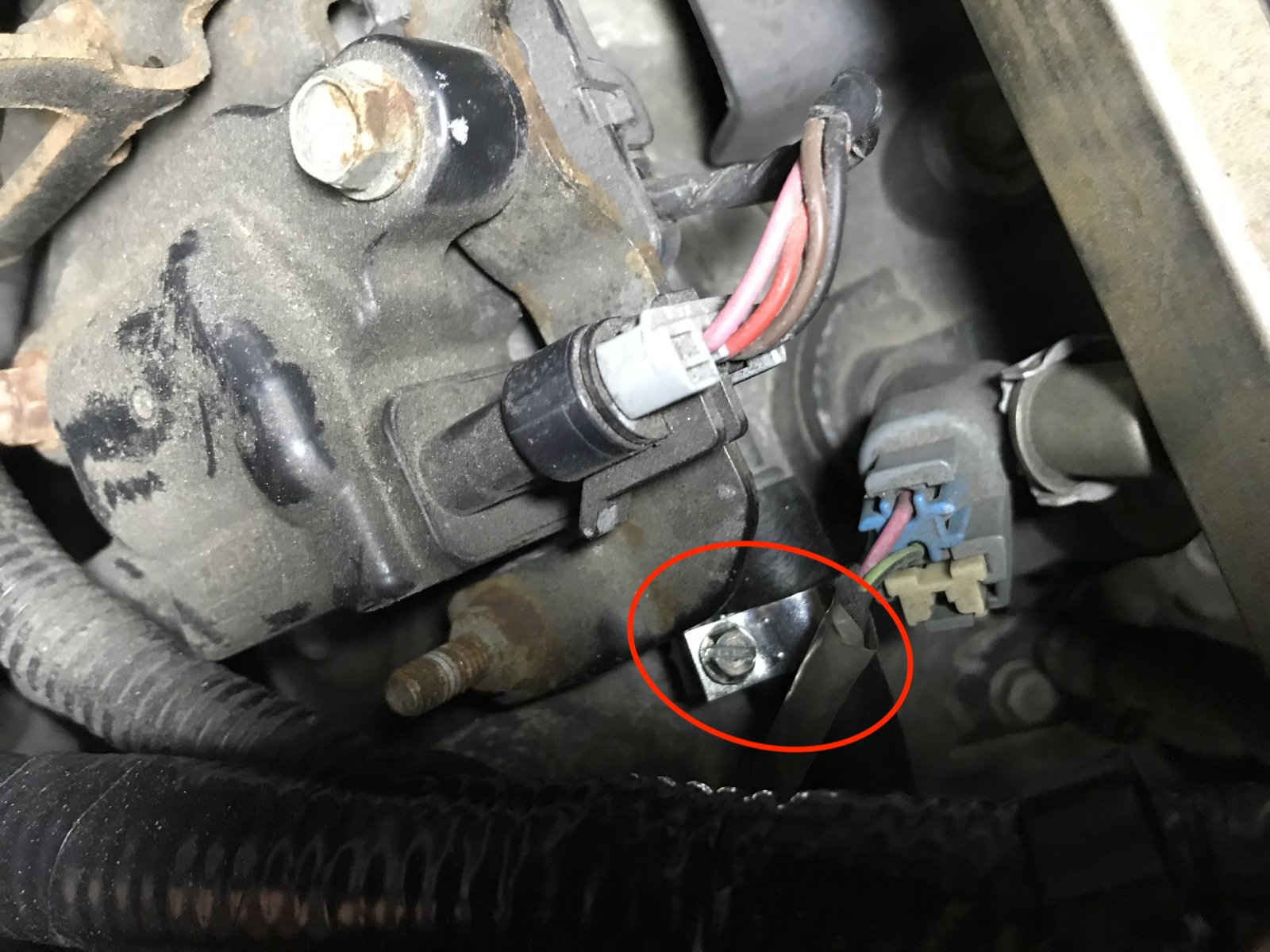

If anything I might give the slight design edge to ARH as you can see below on the passenger side header (1st pic) with the Kooks you have to route a starter ground wire (requires removing 1 bolt) through the primaries where as with the ARH design you never have to touch this wire and it already clears underneath the header, but then again when it comes to the y pipe design I prefer the Kooks Y as they offer a Y Pipe specific to the year model since they changed the cat-back connection between 07-08 and 09-14...Kooks offers 2 different Y Pipes where as ARH Y Pipe just comes pre fit for 07/08 and includes an adapter for the later years

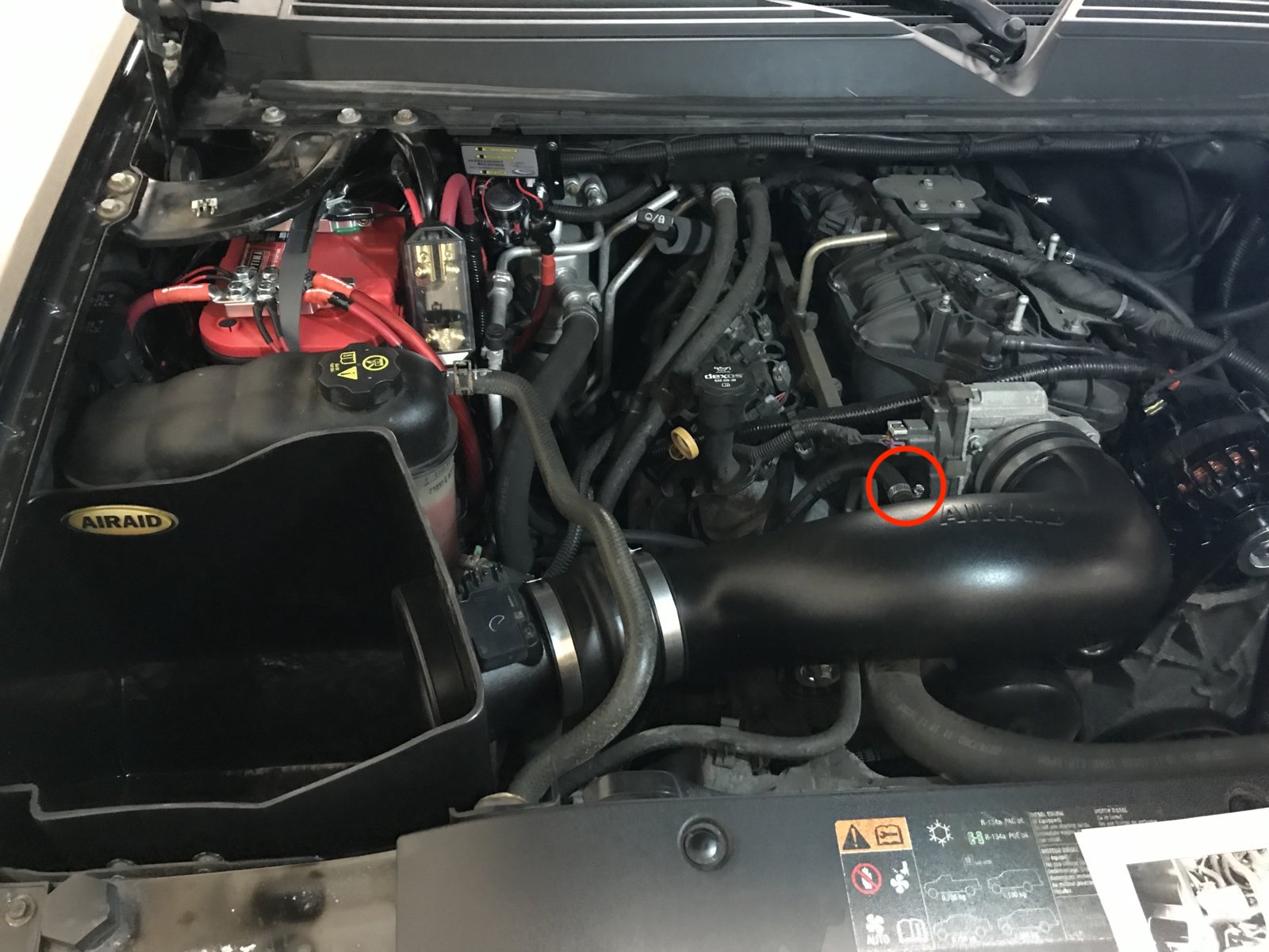

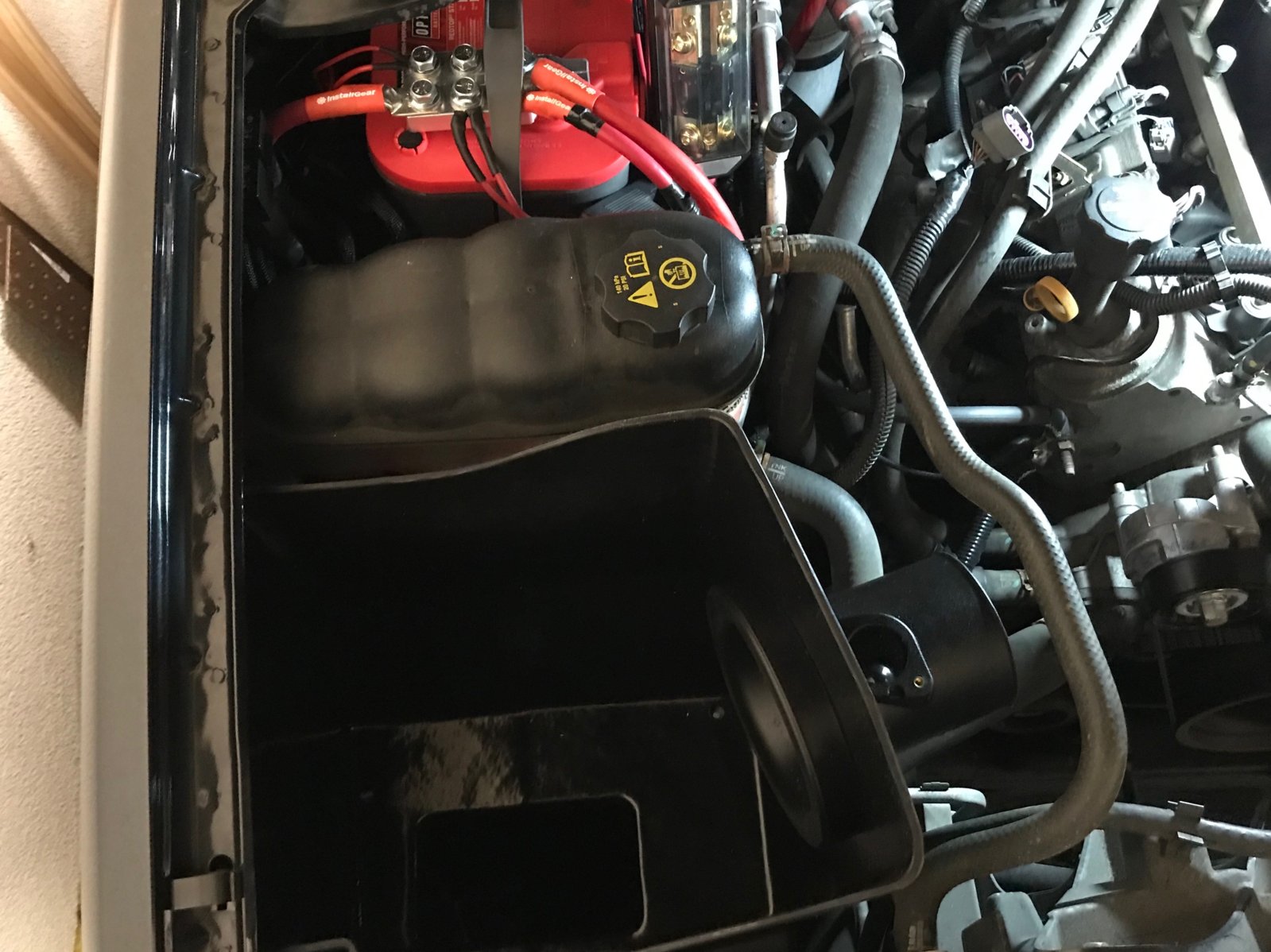

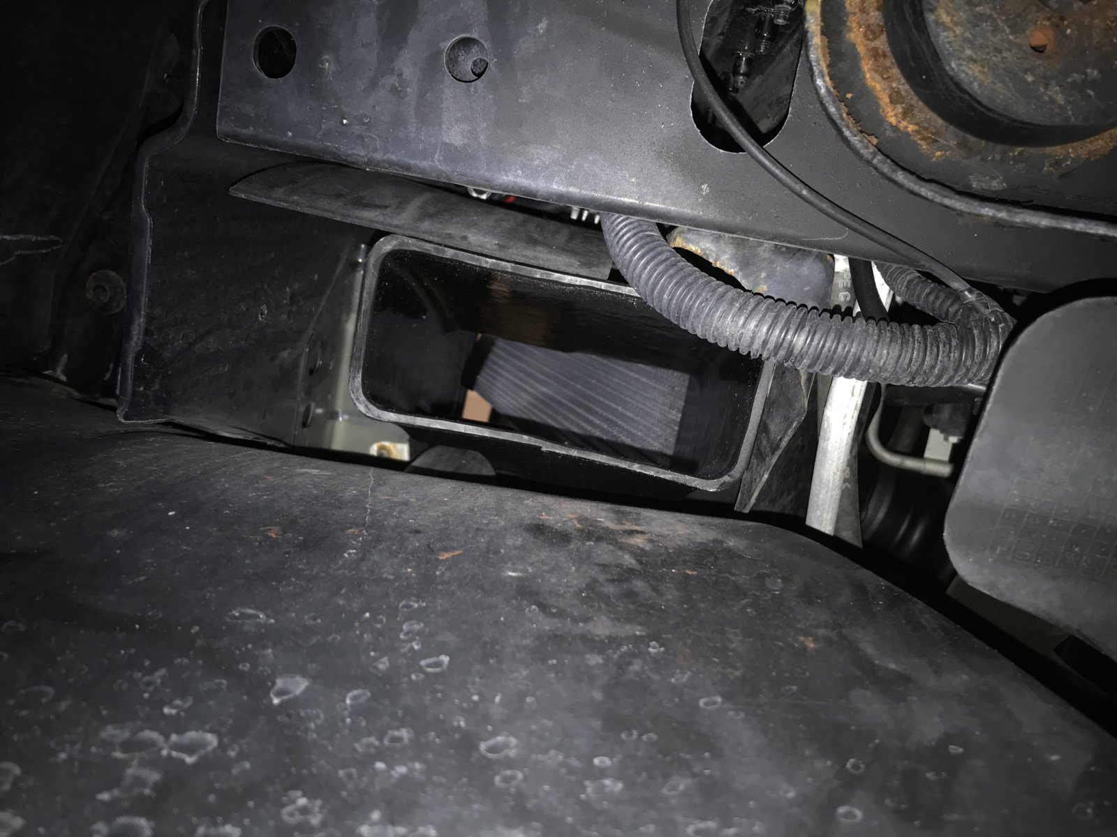

AirAid intake installation update, so far happy with the product, only complain would be lack of clamps for PVC breather line which I have add it (not really sure if its that important).
View from the top
added PCV clamp #1
added PCV clamp #2
view from the bottom of the truck

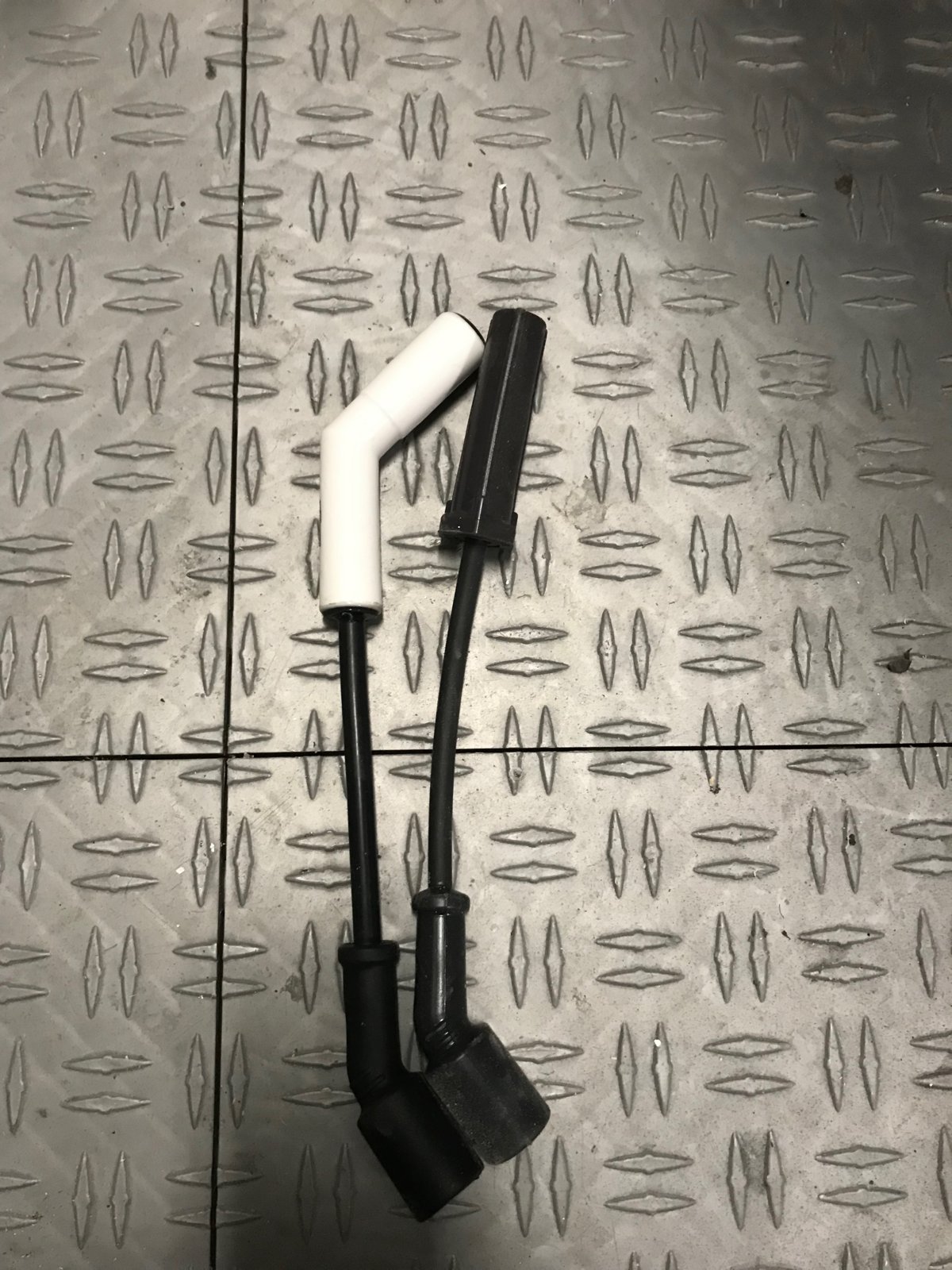

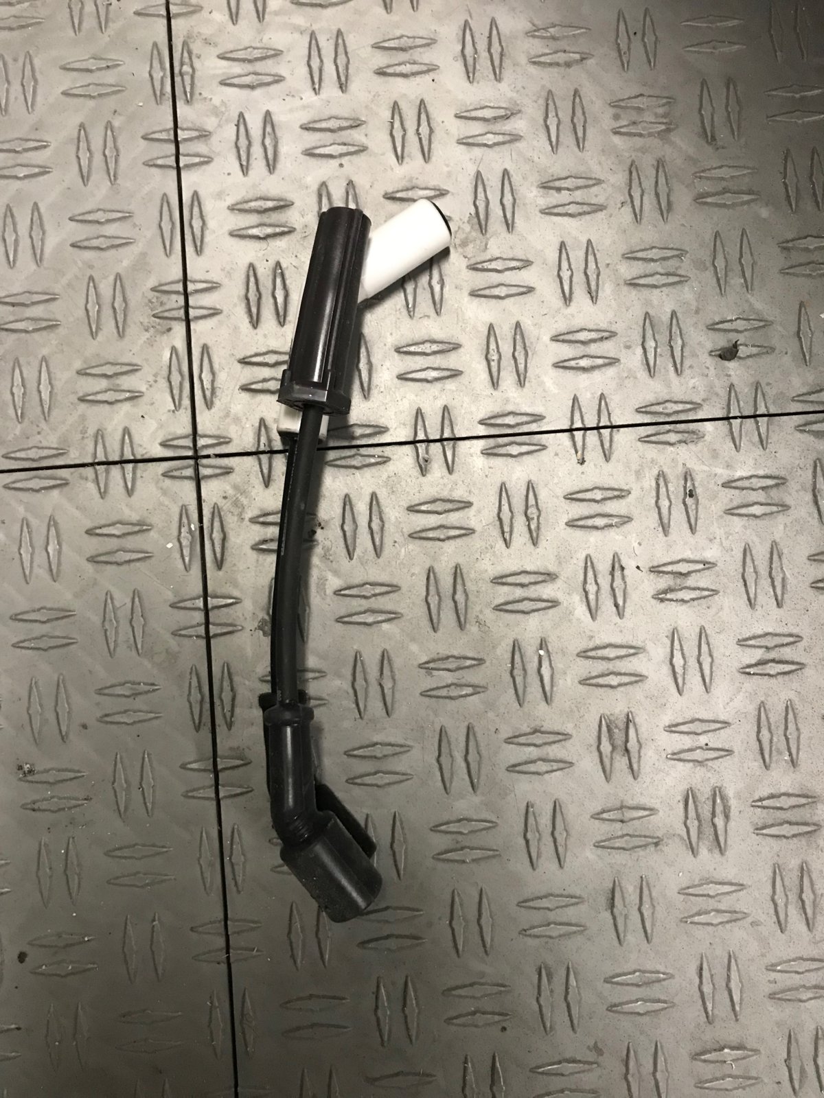

I'm personally not a fan of the boots but the ACCEL Extreme 9000 Ceramic Spark Plug Wire #9002C is what I decided to run... I made them to length but the ones you posted look plenty long, mine are a touch shorter.
They both are great headers and you can't go wrong with either... I will say the build/fit quality on the Kooks are amazing. Details like in this post below are why I love them. My truck sounds like a freaking beast, no video or sound clip does it justice.
it looks like they will work AC Delco OEM vs Accel length.

AC Delco for sure... As I mentioned, you may want 1 stage colder though and iridium doesn't do well for high cylinder pressure. Great for a 100k mile plug though
*start with an AC Delco LSA plug from a CTSv or ZL1 Camaro if you want OEM

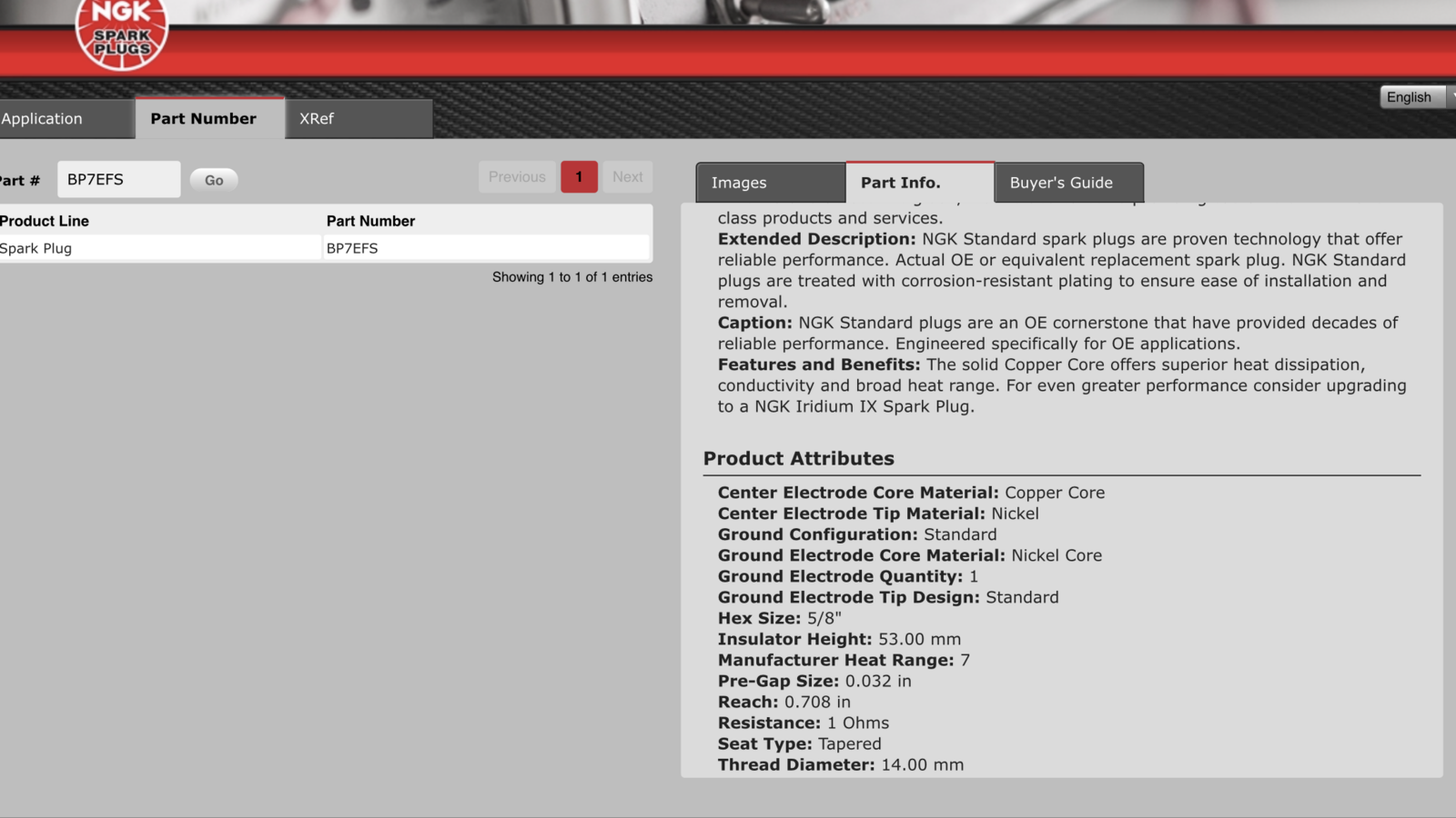

I know lol, I don't know why. Problem is the idiots and software they use at the parts store won't look up anything at all without a vehicle description. The days of easy cross-referencing and finding spare parts for custom stuff easily is over. Any time I look for a part for my truck I have them look up a CTS V or ZL1. Try the plug number I gave you. It's 1 stage colder than a stock LSA (good for up to 15psi) and it's a nice OEM style copper plug. Copper is the way to go if you're over 10psi. Cylinder pressure makes those iridium plug harder to fire. Just look how tiny the surface area is on the electrode compared to a copper one. It's a tiny pin versus .100"-.125" on the copper. Your ignition will run better under high boost and cylinder pressures.

I'd go with a NGK one stage colder than a stock LSA. That would be a NGK TR7IX if you want the "best" iridium plug. However, I will say after going through two sets of them that depending on your boost levels, you may wanna skip the expensive iridium and go with a standard copper plug. I don't want or care if a plug lasts 100k miles with my 900hp "race" engine. I'm more than happy to do spark plug changes every 3k-10k miles on a race truck like mine. So in that case, the cheaper traditional copper plugs actually work much better with high cylinder pressure and will work better with more boost. Right now I'm running the NGK BP7EFS (3526). It took my forever to find a #7 plug that was copper and not platinum or iridium but my truck is much much happier with that plug. It's cheaper too and idles way better, motor is happier in general but I'm also running 15psi which is a higher cylinder pressure.

ok, when looking for a spark plug, I need to match Spark Plug Thread Size and Spark Plug Reach correct?
67RS427
Apr 5, 2017
595
1,217
All the LS stuff is the same. The one I gave you will work. You can verify by pulling it up on the NGK site and compare it to your stock plug replacement from the AC Delco site.
