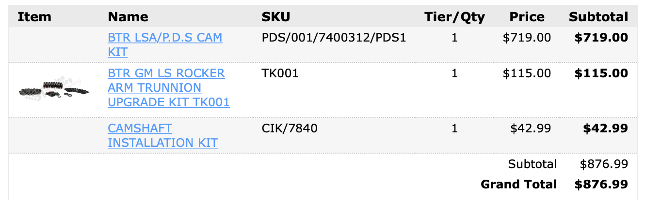

sales person at BTR was recommending BTR PDS STAGE I CAM for me any thoughts on that?
How much boost do you plan to run? You are also smaller cubic inches... I would talk to Nick @ BTR ([email protected]), he does the custom cam sheets and knows what he's doing. My idle quality is just fine and I LOVE the sound of the cam. It certainly makes a crap ton of power too. You won't be disappointed with any of them honestly. What heads are you running?

10 psi of boost, when I sent them e-mail Aaron responded to me, as far as heads its all stock.

@67RS427 , here is what I got from them, assuming pushrods is something I have to get elsewhere? like you mentioned in your previous post, I know there is a set of them in the kit
