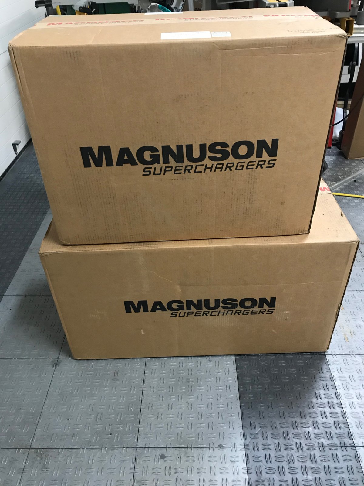

Magnuson Supercharger, Valve Train and other supporting mods. 2007-2013, 5.3L Chevy Tahoe
Chrismnj
Chrismnj
Sep 17, 2015
1,227
2,121
NJ
1. Magnacharger TVS1900
2. BlackBear Tune
3. Airaid 202-270 AIRAID MXP Series Cold Air Dam Intake System
4. Kooks Y-Pipe 28553200
5. Kooks Longtube Headers 28502400, *ceramic coating
* Magnaflow exhaust already installed
6. Moroso 85481 Air/Oil Separator
7. Auto Meter 17118 Triple Pillar Gauge Pad
8. GlowShift Black Gauges
9. Accel 9070C Extreme Ceramic 135 degree boot Plug Wires
10. AC Delco 12673134 Oil Pressure Sensor
11. AC Delco Ignition Coil D513A
12. ACDelco 12617944 GM Original Equipment Exhaust Manifold Gasket
13. Stage 8 8900 Locking Header Bolt Kit for GM Small Block
14. NGK Spark Plugs BP7EFS/3526 - NGK Standard Series Spark Plugs
15. BTR POSITIVE DISPLACEMENT SUPERCHARGED STAGE I CAM FROM CAM MOTION, CM32338206
16. .660" Lift BTR Platinum LS Spring Kit; Titanium Ret., .505" ID .060" Thick Loc., Black Seals, SK001/T/0560/BB
17. BTR Chromoly One Piece Pushrods; 7.400" Long, 5/16" Diameter, .080" Wall, Set of 16, PR7400312-16
18. BTR GM LS ROCKER ARM TRUNNION UPGRADE KIT TK001
19. CAMSHAFT INSTALLATION KIT
20. COMP CAMS TRUNNION TOOL FOR LS ENGINES; CC54702-TL
21. Hummer GM OEM 08-10 H3-Engine Motor Mount Torque Strut 25847739

are any injectors provided with the maggy?
that is a good question. still in the box lol, I did see a Bosch package, now you gonna make me go and check.
Edit.
No, they don't provide injectors.
