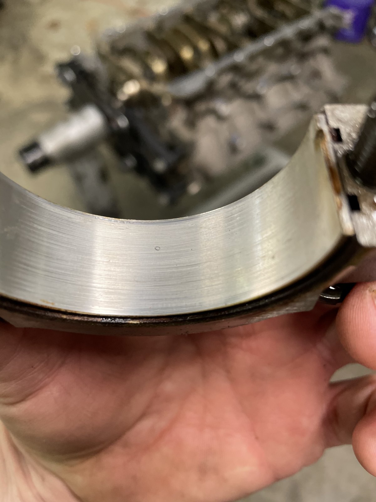

i had a free moment, installed the shorter bolts on the engine stand, and flipped that ***** over and popped off the main caps.
So far so good...
Main bearings being ok makes me very happy...
My biggest worry was that the main bearings could damage the transmission.
That said, i have not seen the underside yet.
Next the rod caps...
I'll get pictures soon, just busy with work.

ok i couldn't take it,
i carefully zipped off each rod cap and glanced at them.
still nothing obvious.
Like it does show signs of trash in the oil everywhere, but for the miles it does not look half bad.
(going off of youtube videos, not like i know anything)
front main cap bearing looks the worst, but it's still silver in color.
This should be fun to figure out wtf.

glad to hear the bearings are good so far. We check mine, this was the worse one. Minor trash, nothing to be concerned about. 200k

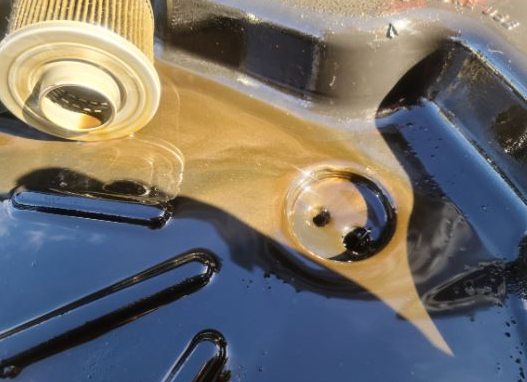

yeah i tore that ***** apart, detective Pikachu etc.
so i don't know quite were the fk the metal sparkles were coming from yet.
And the thing is, it's not like it was just a little.
It was quite a bit.
super fine.
filled the pan, and it was everywhere.
Small amount from the filter for example.
I'm pulling the cam bearings next, but so far it looks pretty standard.
Before the dod delete a few months ago for example,
I see a few more that look a bit worse, but so far it does not explain the amount of sparkles i saw once before the dod delete.
And then the follow up afterwards.
New pictures coming later, maybe sometime this week or this weekend.

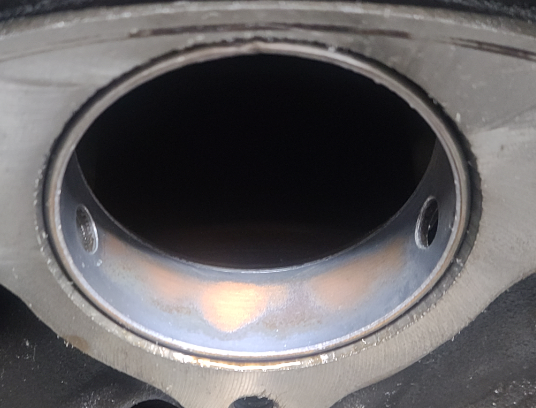

and so far the engine looks pretty freaking good.
Carbon build up like crazy around the pistons.
Almost looked like an oil ring was stuck there for a minute.
Almost Looks like i could just polish the crank, toss in new bearings, rings and a hone and keep rocking it.

You probably could. That's pretty much a full rebuild. I didn't replace a single bearing in mine and I'd road trip it at any time with confidence.
I still can't think of what would cause that color of glitter in your oil, though. The only thing close is crank and cam bearing material beyond the babbitt.
That would be a huge money saver!
I'm glad to hear nothing catastrophic yet. Not sure where the flakes are coming from though

it has to be a cam bearing is my thoughts.
The only thing nagging at me, with so much glitter I was expecting to see a spun bearing or something catastrophic...
this hoe has had a large list of owners, many of them having it for about a year max.
nagging at me to just scrap the engine and go new...
(and i do want 6.0)
