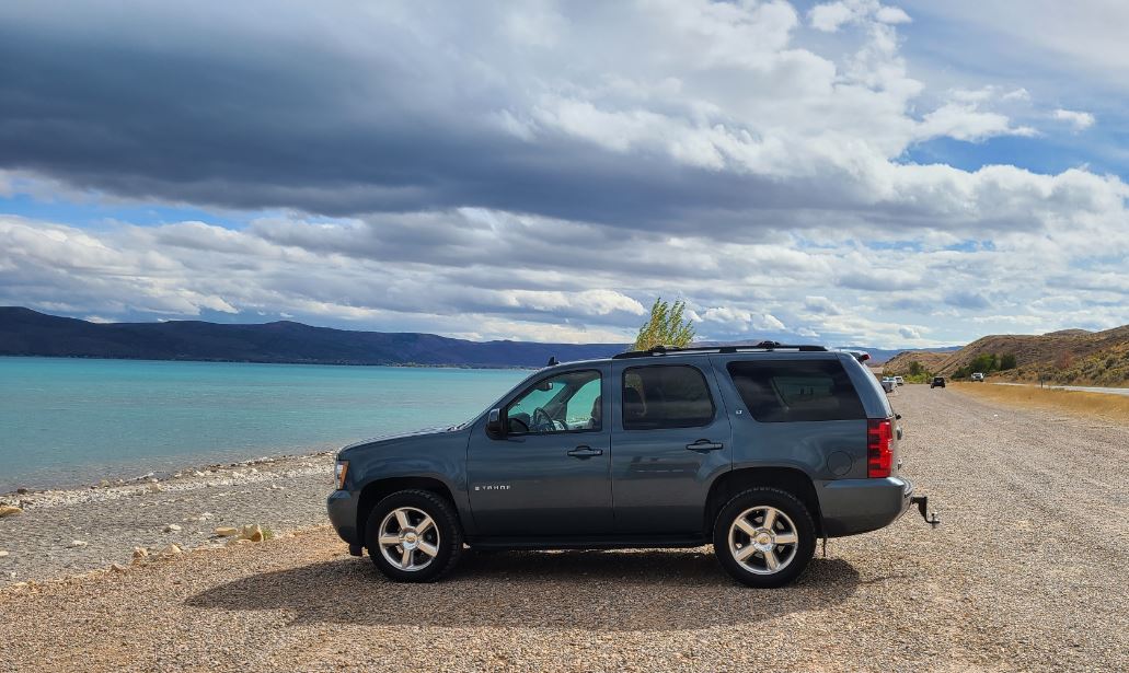

Picture of the subject,
Good times before the problems started, visiting bear lake on a stormy day.
