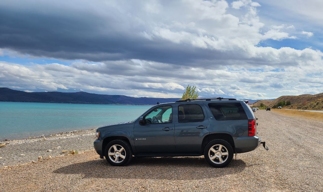

Thought Utah was dry--ish. It would be good for someone who'd like to build their own motor. Good starting point.
Winter + snow = salt on the roads.
Part of what drew me to the hoe was how freaking clean it is.
Like no rust on the frame!
the engine has no signs of corrosion
Usually you would see it on under the intake, alternator, front cover etc.
I ignored the obvious red flags of the long list of owners.
Many having the how for a year or less.
Part of why i want to just dump the engine, so far nothing to explain the amount of metal it's producing.
going back, i would make the same mistake.
Mmmm :boobs: :boti:
even more Mmmm once the 6.0 is up and running.

Betcha can’t wait!
