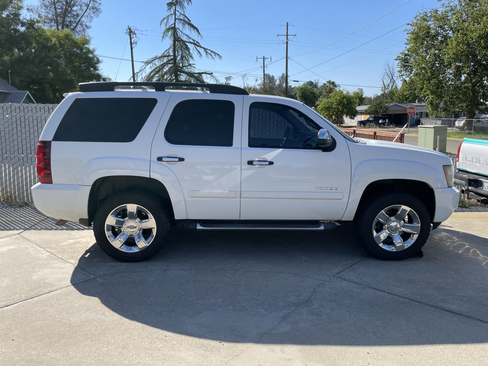

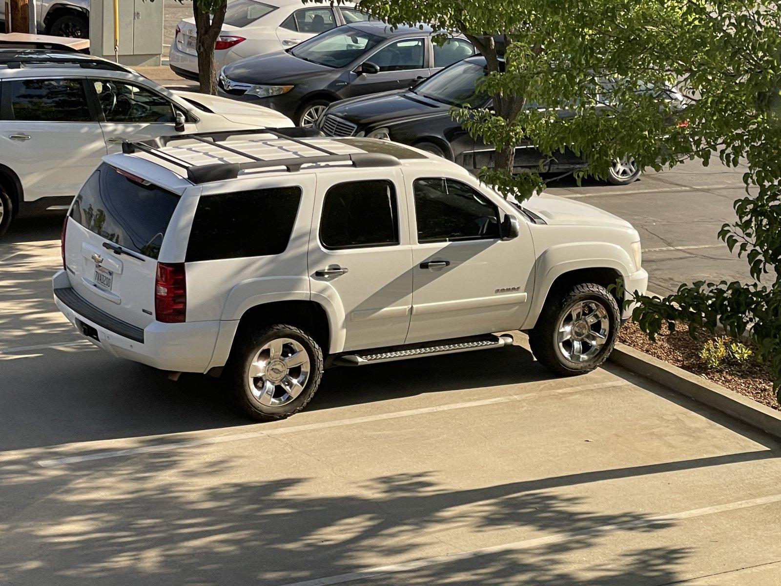

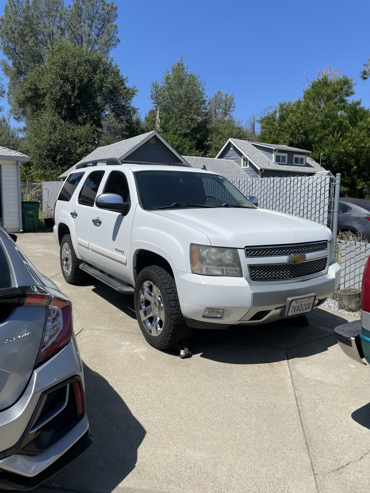

At the beginning of June I became aware of some play in the front suspension and discovered that the wheel bearings, upper ball joints, and front diff were going bad. I used this opportunity to remove the lift spacers and wheel spacers.
I took my CV axles apart and am running the CV hub stud through the wheel bearings and avoiding running the front diff for now it's making a clunk when spinning.
This time I used Timken wheel bearings and Mevotech TTX upper control arms. The Moog lower balljoints seem to be holding up still.
