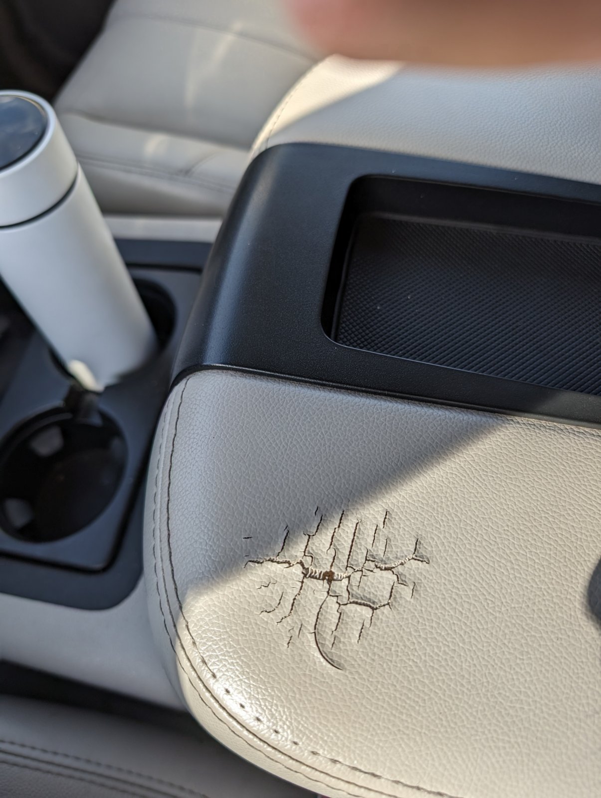

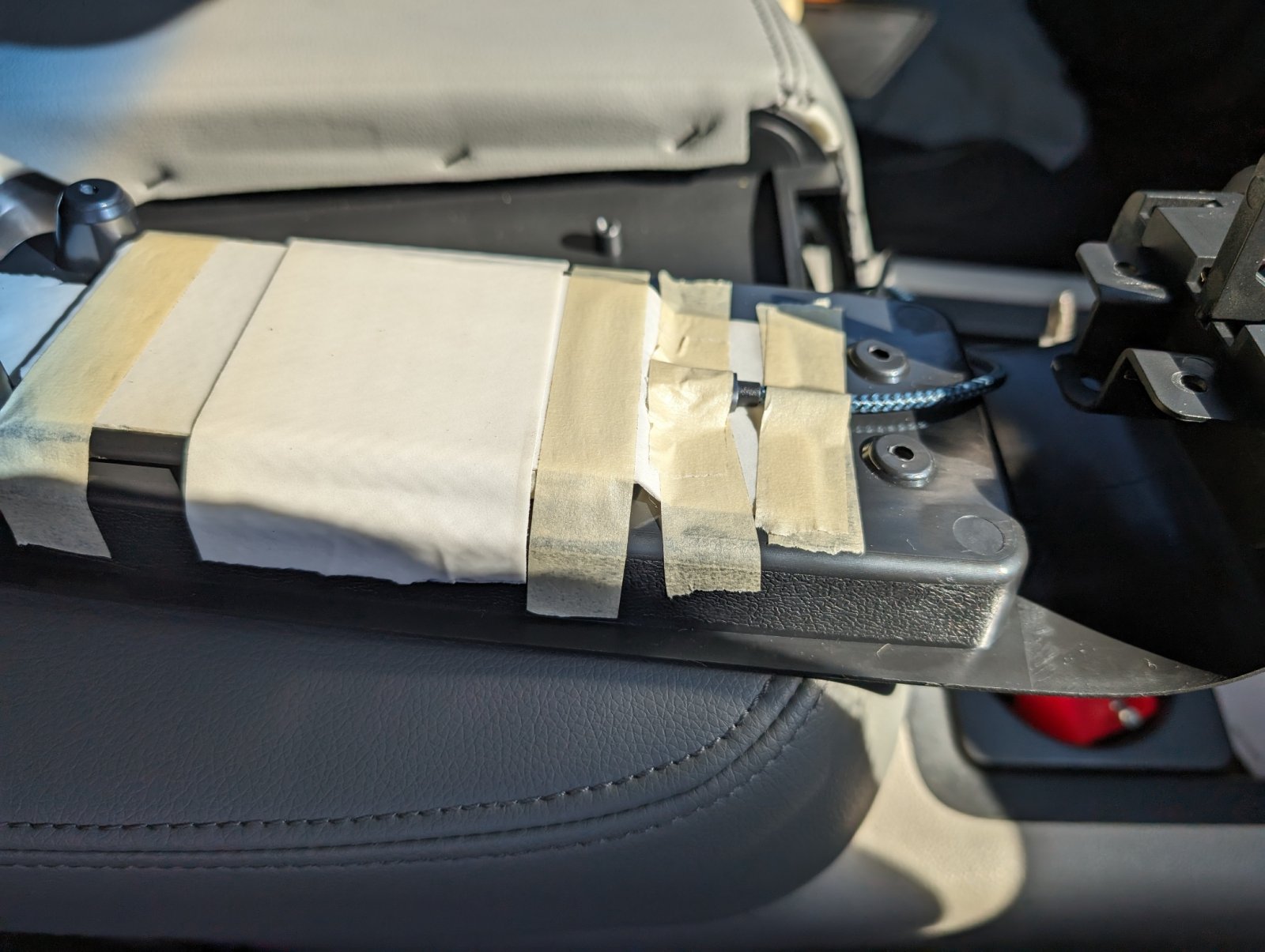

The arm rest was pretty beat up, so I ordered a full replacement, and decided to add wireless charging to it.
Original:
Mid-work (not many pictures, b/c I kept using my phone yo confirm the charging was working:

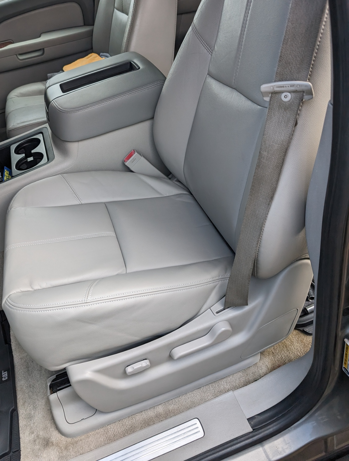

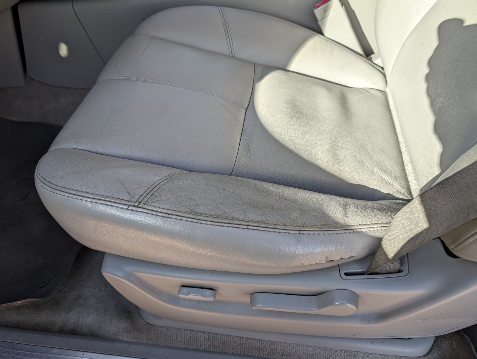

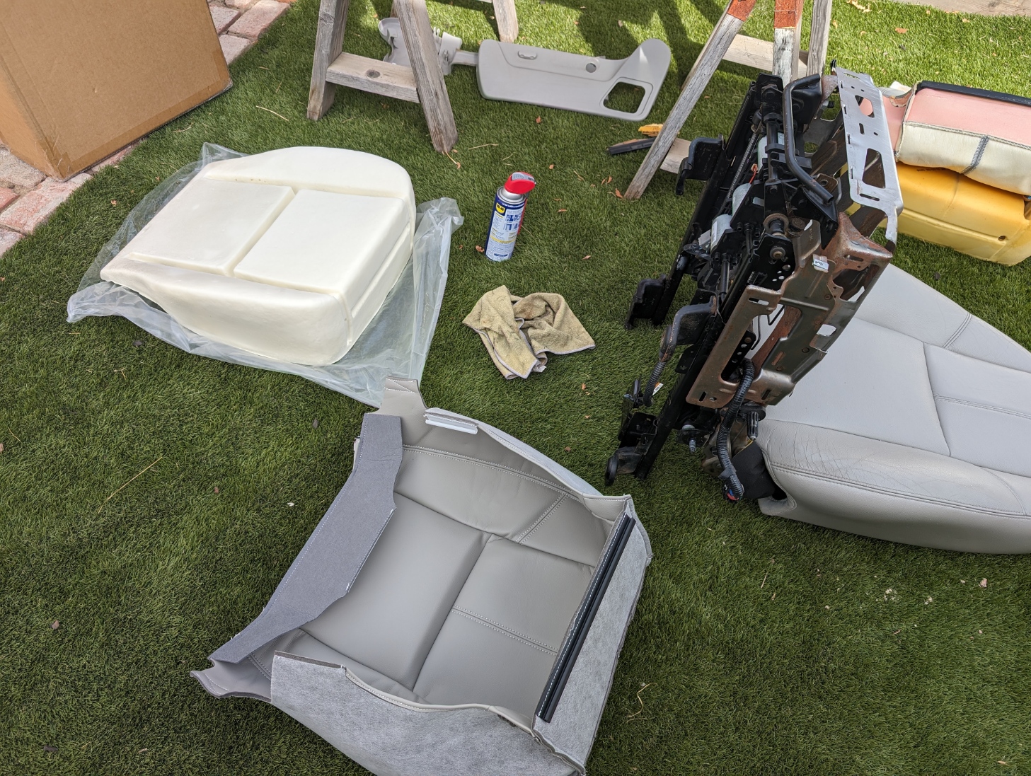

Keeping in the interior, I recovered the front lower on the driver's side, including new foam. Here's the before:
The mid-progress:
And complete:
Need to clean the belts.

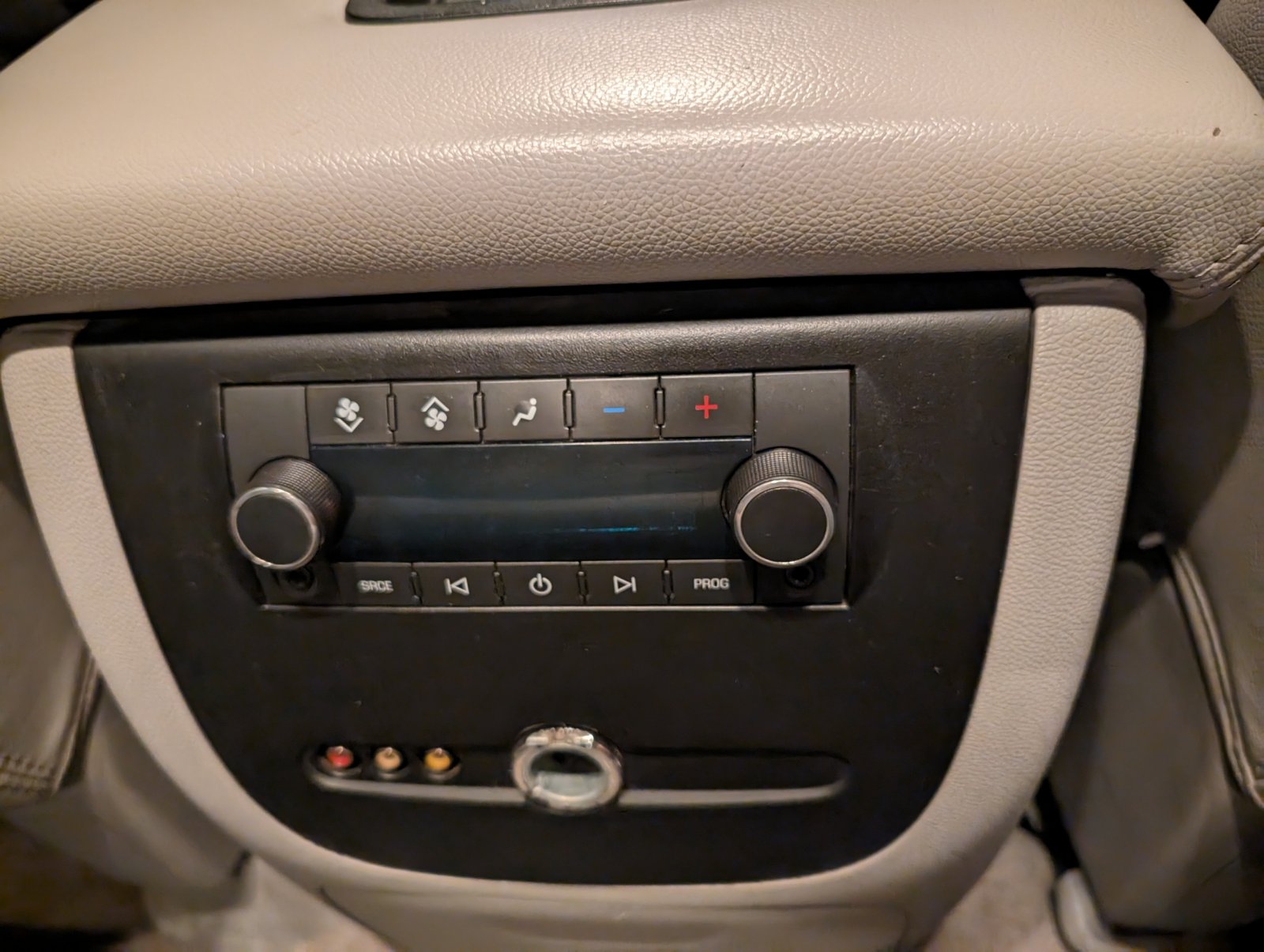

Missing radio knobs:
Bam! Knobs:
I have a 12V surround/cover, but haven't gotten around to fighting with the thing to remove the old one.

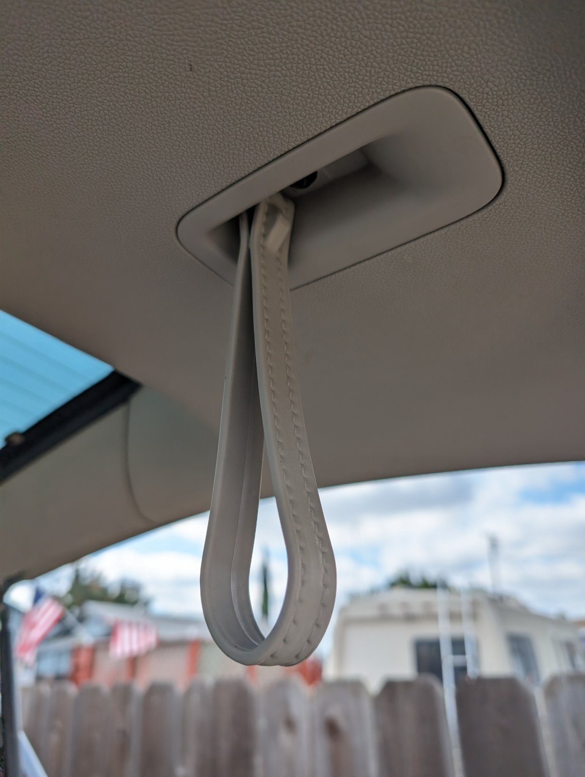

Broken hatch pull:
Fixed! Like magic:

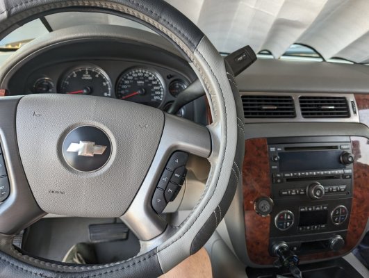

New steering wheel trim, in brushed aluminum, vs. previous worn black plastic:

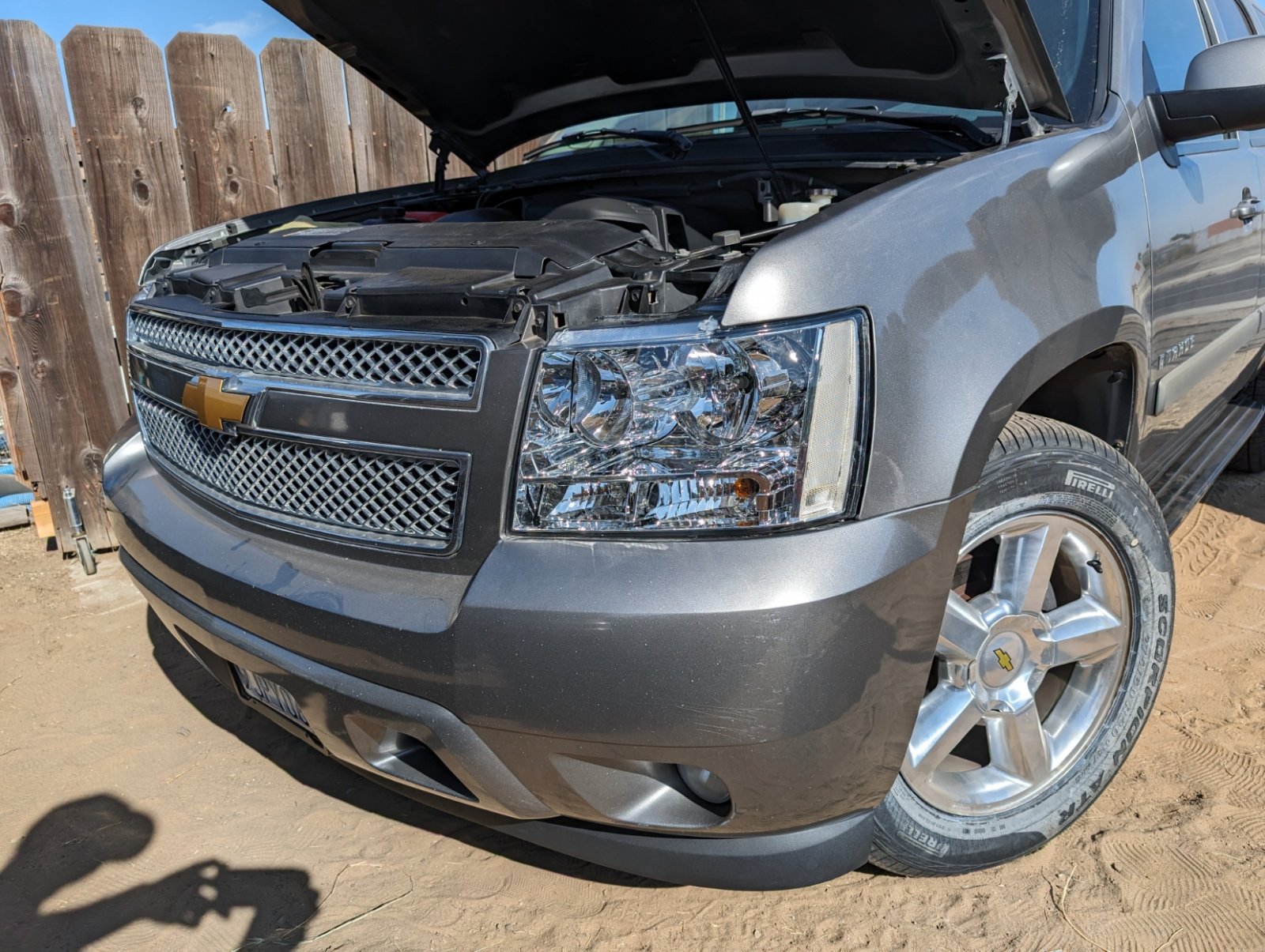

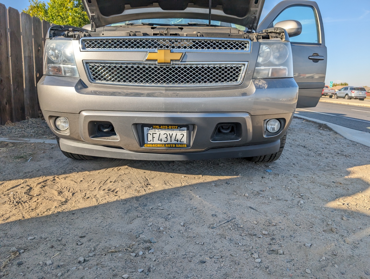

Let's do some exterior. Here's the new air dam:
Front end is so low for a 4WD - like scraping curbs low. This told me I must at lease level the front, as a moral imperative.
Here are the new headlamps. Man, these are a massive pain to install. Well, just more difficult than other trucks. Open heart surgery:
Prep:
Finis!:

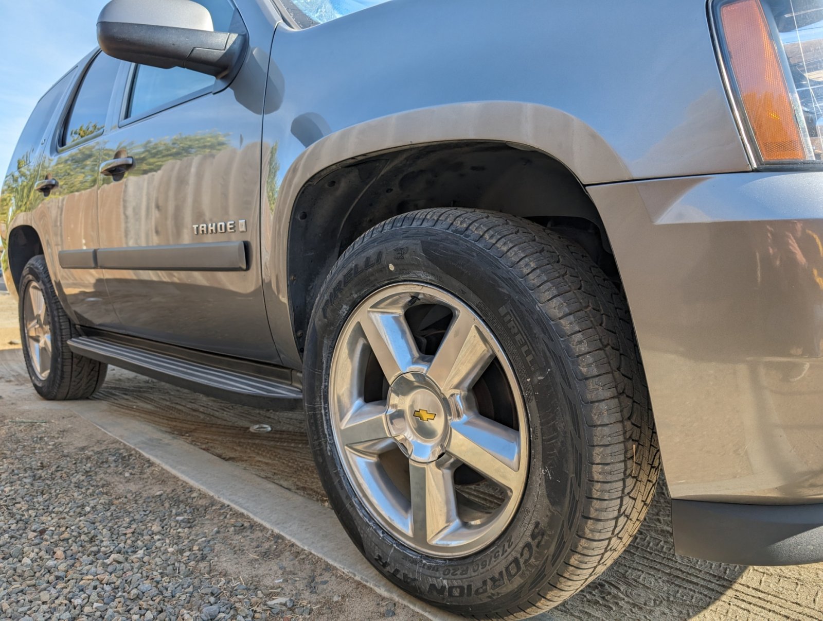

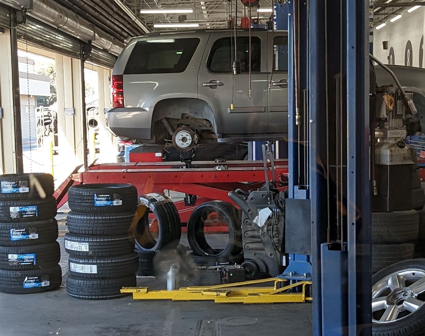

Anyway, new tires (Pirelli Scorpion ATR, 275/60R20):
(The only thing I haven't done myself.)
Still greazy. And you can see how beaten up the BSM are.

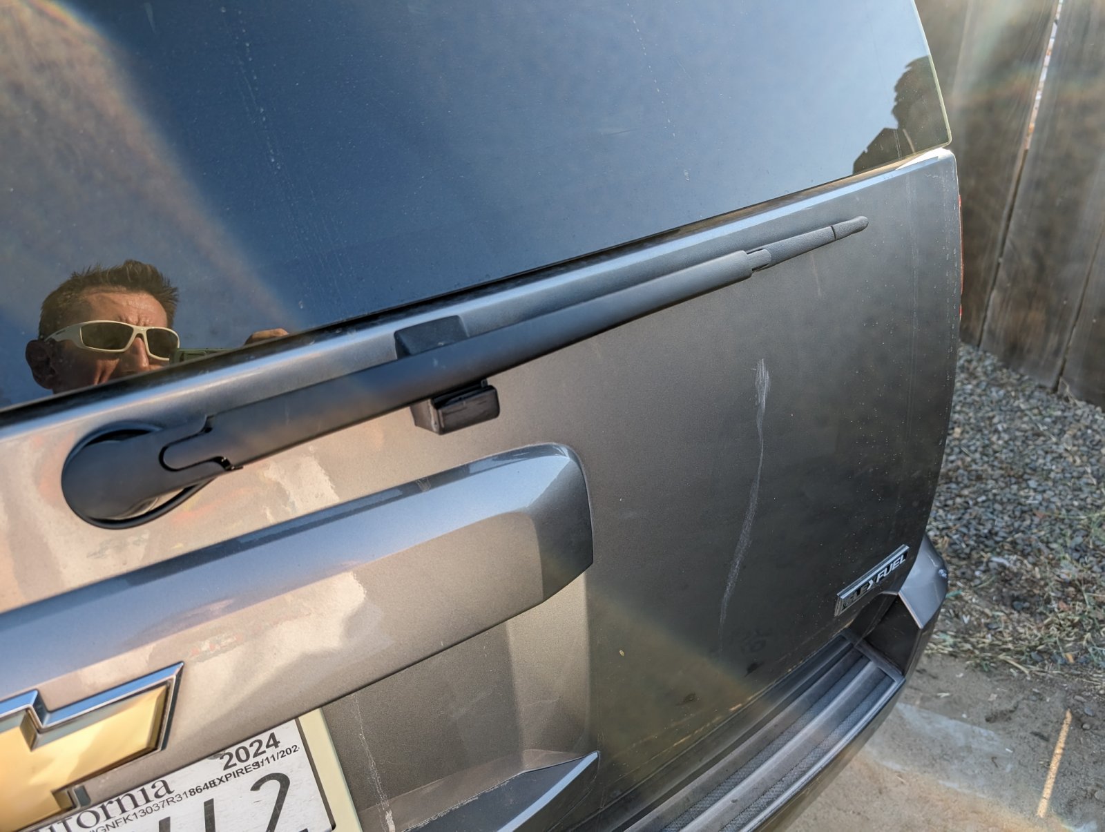

New rear wiper arm+blade:

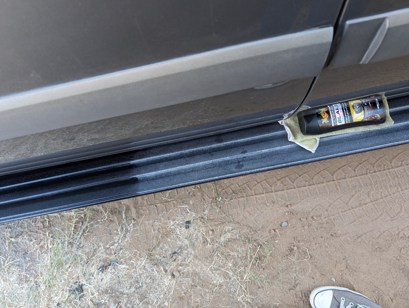

I put some work into the exterior black plastics:

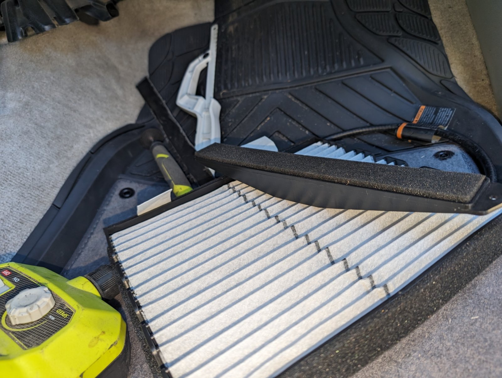

Oh, and I did the cabin air filter retrofit:

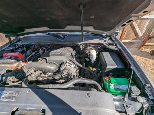

I put the second battery kit in:

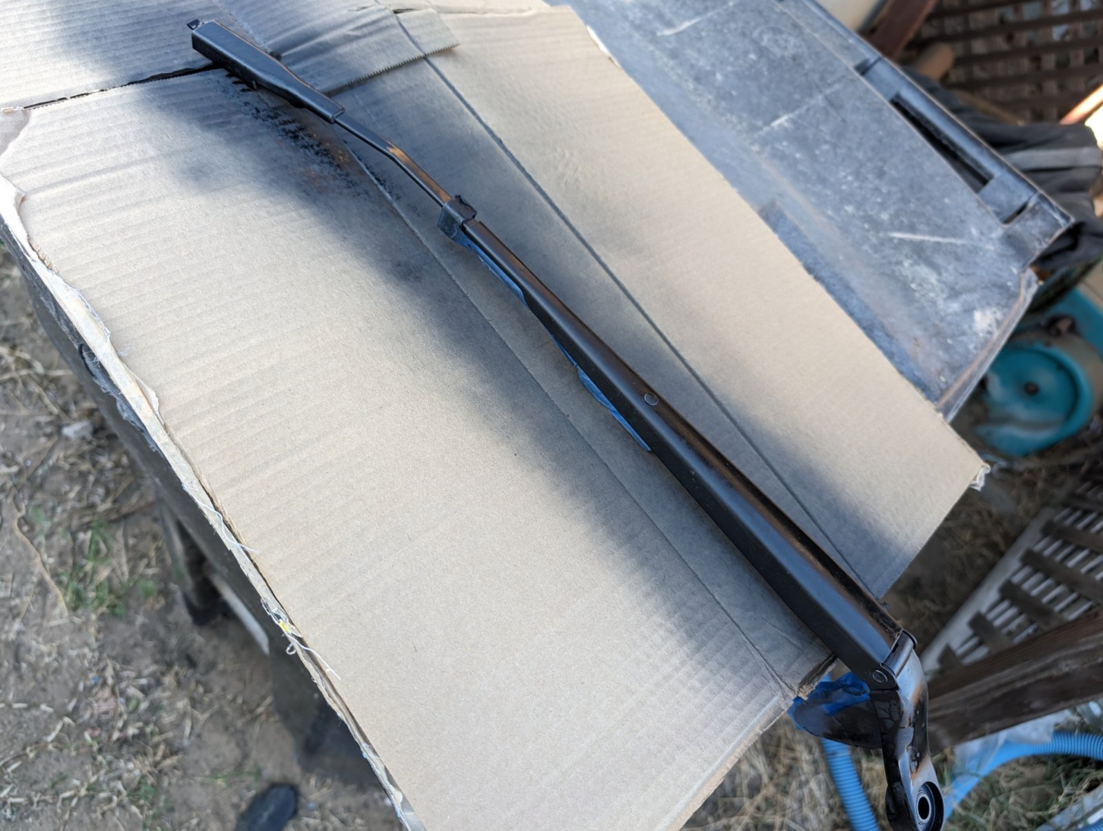

Repainted my front wiper arms (plus new blades):

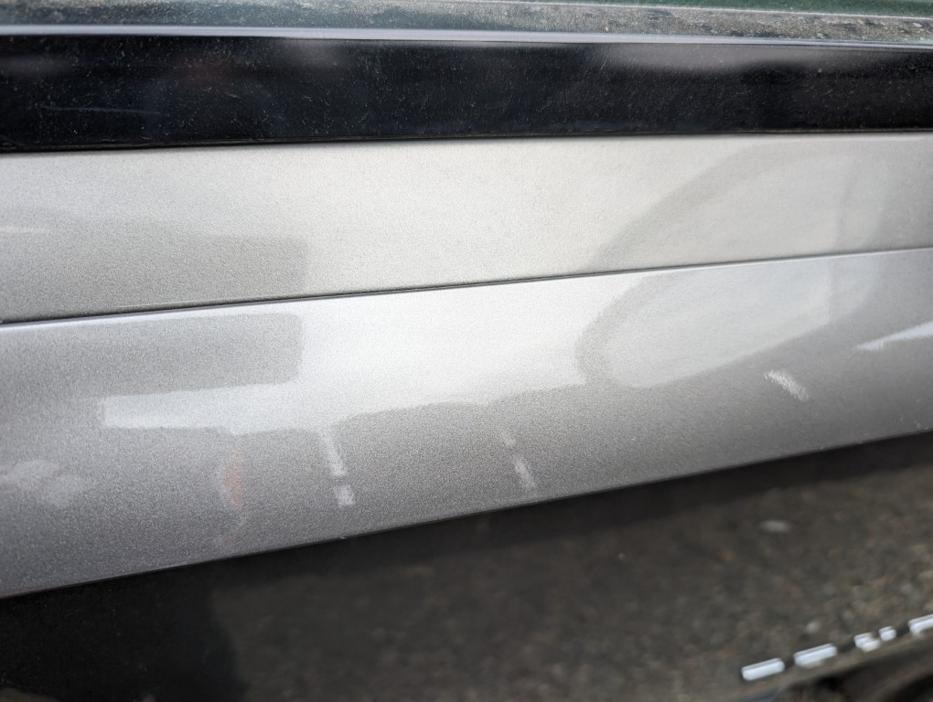

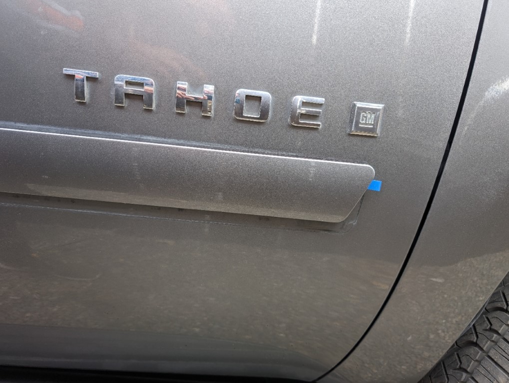

And once it stops raining, I'll get my new BSM put on:

the brushed aluminum steering wheel inserts are they real aluminum or the painted plastic. mine are a painted plastic and got some wear marks on them. wouldn't mind replacing them if there was a nice set out that wouldn't do the same thing in a few years.
I almost did the same to mine on my '08. But ended up with arms off a 2010 and used those cuz they went back to NORMAL J-hook style wiper attachments instead of that janky, confusing crap from '07-'09 (or '08?).
You got these BSMs pre-painted? Have a link to your source?
Link to BSM: www.amazon.com/dp/B08BWYXZB4?th=1
Perfect color match:
I got 'em off eBay, and they were colder than the surrounding plastic when I got in the truck this morning...? I honestly can't recall, but I think they are aluminum. I don't rest my hands there, so I don't know how they get so worn down.

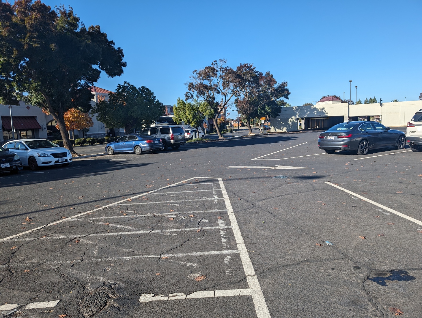

Random side note: why, with a 1/2 empty parking lot, do ppl want to park right next to someone...? Couldn't even open my door fully.
:mad:
This is why we have to have BSMs. I park waaay out in the open. Maybe half the time, when I come out of the store or mall, there's an "enthusiasts" car, like a Mustang or Charger, parked behind, ahead or next to me but with an empty spot in between us.
