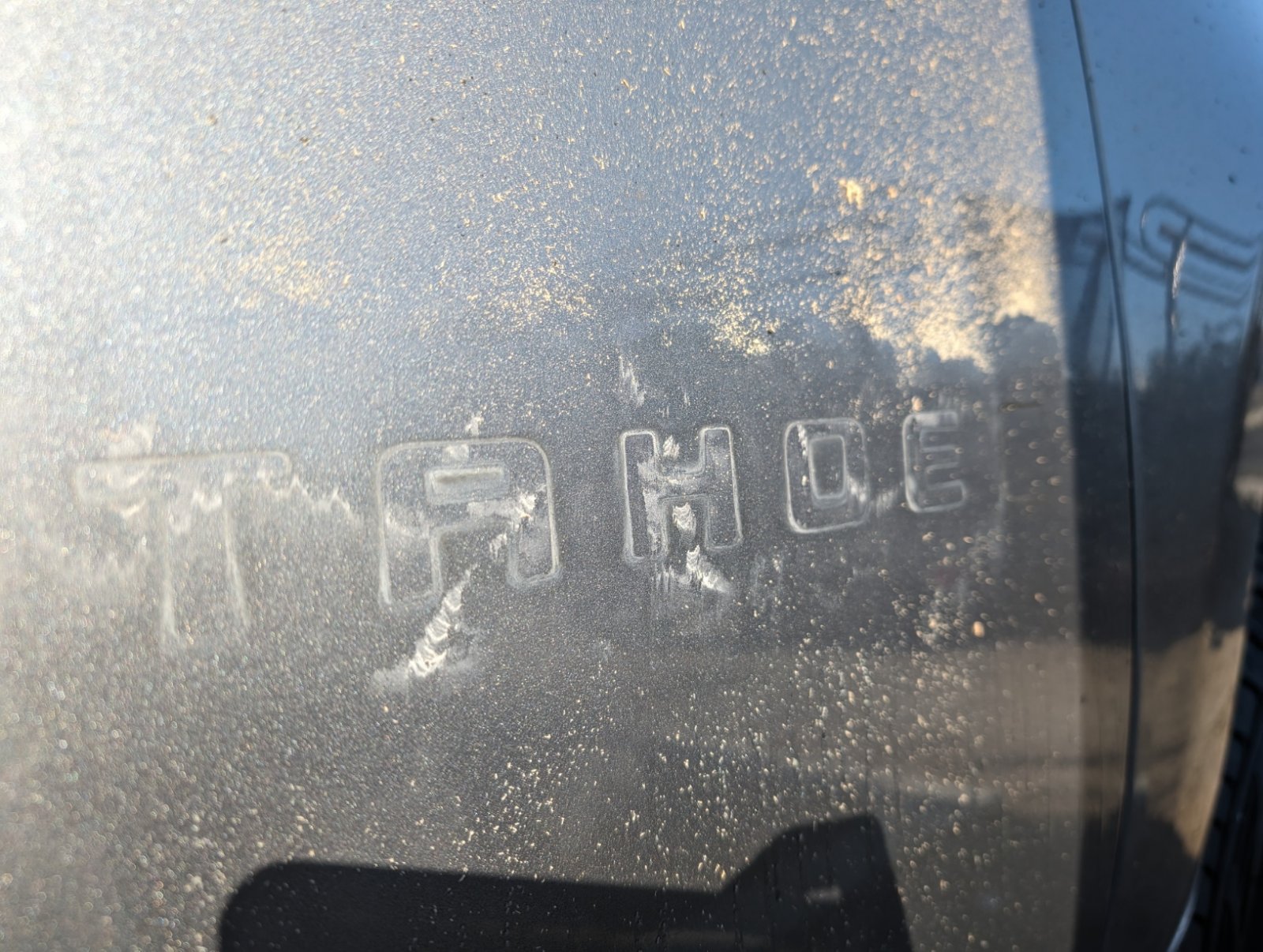

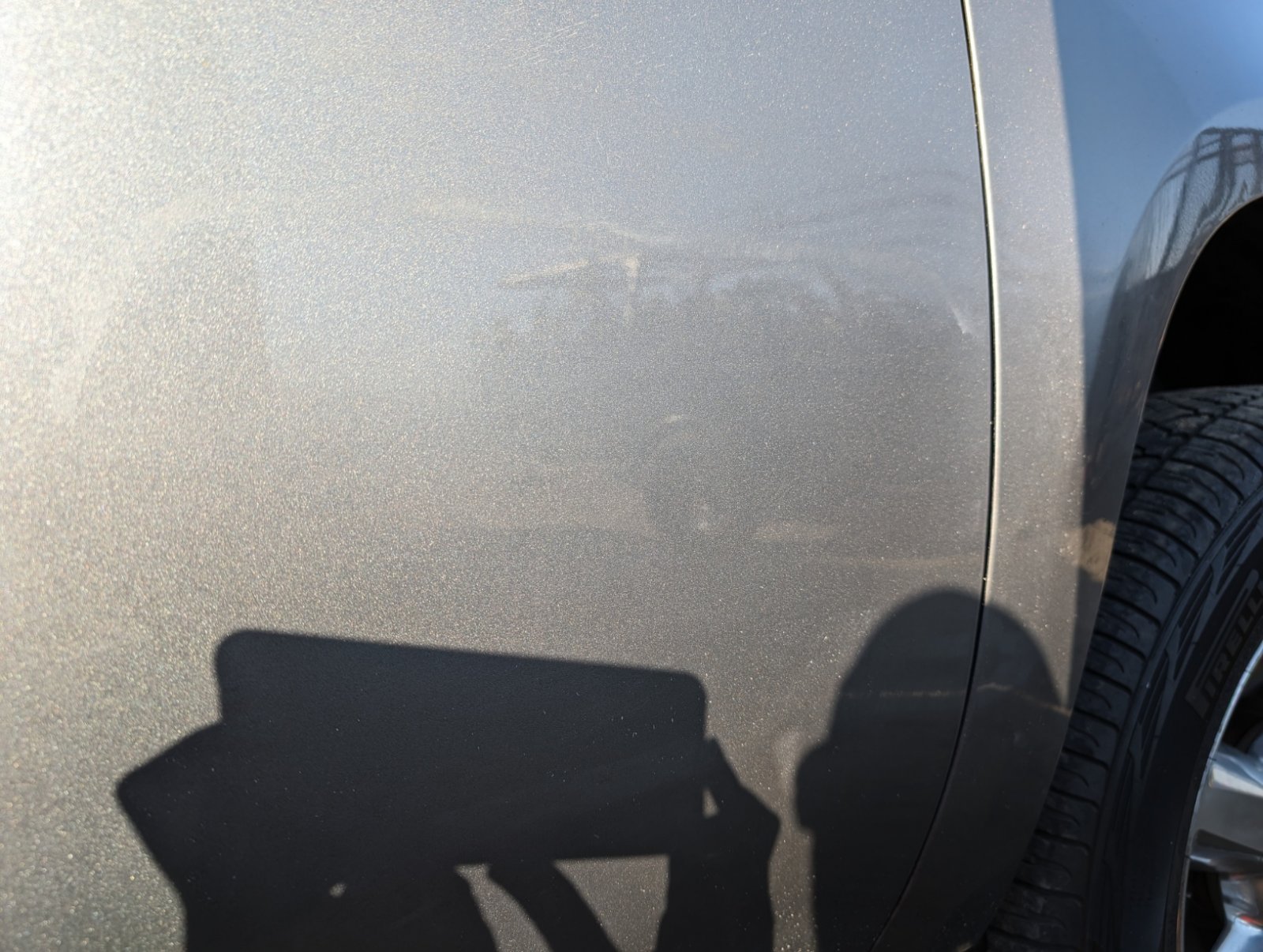

I did a cut+polish to clean up the body sides today. Man, even using the $10-12 Turtle Wax compound, it came out amazing!
Before:
During:
Rubber shit everywhere, from the eraser wheel.
After:
The compound is a mess, too. It was on my steps, and mirrors, and the window sills. Will need a little scrubbing to come off completely.
Progress:
It has me reconsidering putting on new BSMs.... Letters come off tomorrow. Will rock it naked for a few days & see how I feel about it. But I'm still leaning towards putting the new one's on - they'll be nice, I think. I have some "custom badging" in mind - very minimalist - but no rush.

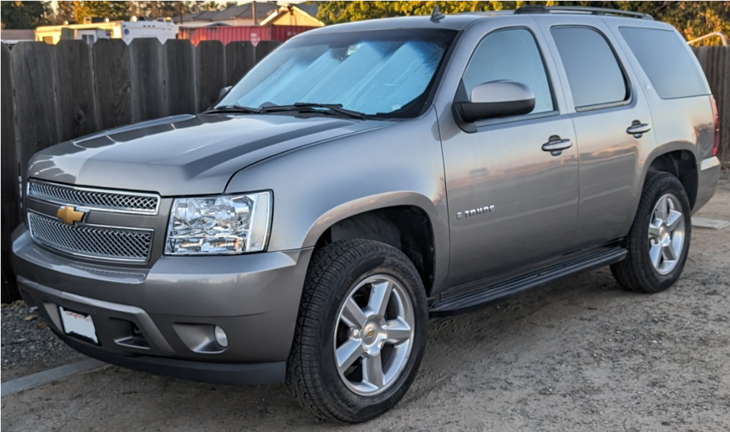

My meeting at the Uni went well. No dings, b/c I parked so as to make it nearly impossible.
Here's the new BSM applied. It was a little nerve-wracking lining up the masking tape, and measuring multiple times to make sure it was as close to 14.5" from the bottom all along the way. I was checking against the top and found about 1" of rake built into the panels themselves (as measured from the first crease leading to the window openings).
Lining it out:
Laying them out before swabbing with alcohol wipes and applying the adhesive promoter:
I had to break out my other hobby's tools: a pair of tiny tweezers (for grabbing wayward screws in computers) to get behind the molding & grab the red tape when it broke once or twice, or even to get it started on some pieces.
Applied, after using the heatgun a bit, b/c it is a bit chilly in CA right now:
The running boards need new love b/c the cut/polish compound used to clean up after debadging got all over them and hasn't washed off.
Comparison to old BSM I removed:
The slimmer nature of these avoids that strange, but necessary, cutout on the rear piece. I'm still impressed by the paint match/quality. Link for those interested.
Overall progress:
(I don't know why it looks like I just got backed into - it's just a weird reflection though. <knockWood>) Wheels/tires still haven't had their turn at detailing. I need to rectify that.

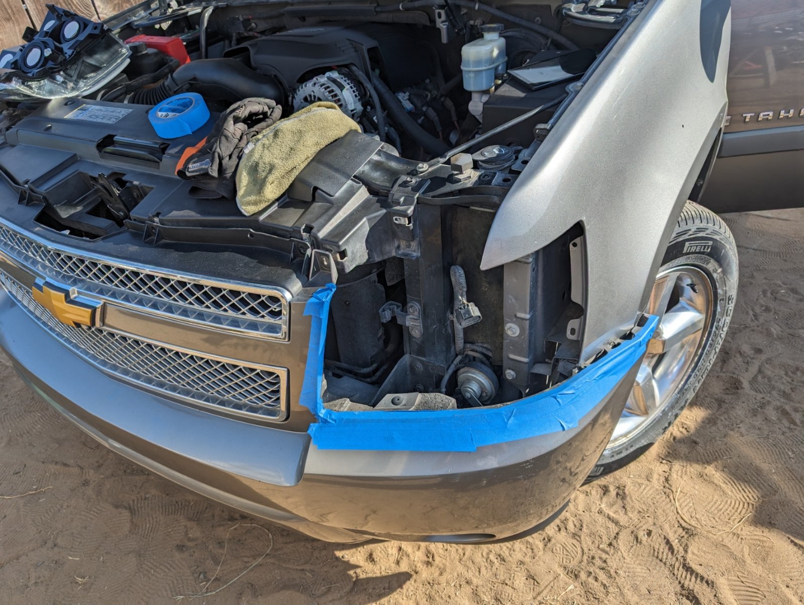

Let's do some exterior. Here's the new air dam:
Front end is so low for a 4WD - like scraping curbs low. This told me I must at lease level the front, as a moral imperative.
Here are the new headlamps. Man, these are a massive pain to install. Well, just more difficult than other trucks. Open heart surgery:
Prep:
Finis!:
I need to reboot PC. More to come.
